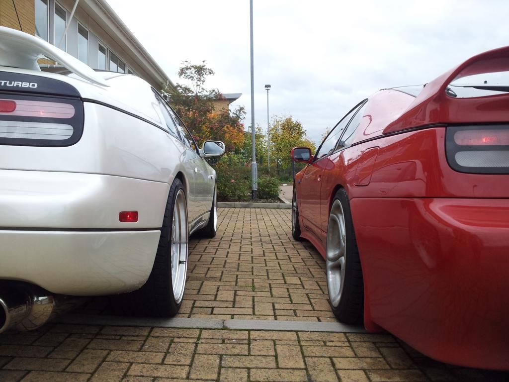

Fitted 15mm spacers a few months ago with no need to flare the arches. Then fitted coil overs and new suspension parts in Nov - still no need to flare arches.
However, last weekend I finally got around to getting Hunter alignment done and now I'm getting contact between arch and tyres when driving over even small bumps in the road. Didn't notice it until last night (as I hadn't really driven the car since alignment) and I had to do a quick 15min job to remove the spacers in a service station car park on the M40 so I could get home with peace of mind!

Yup! If it didn't before I would. I saw the camber before you had ot done and it certainly didn't look negative? The wheel looked flush. They may have returned your camber to stock, quite a lot of people dial in a smidge more negative camber.
I rolled the arch lip on my Z, but that's because it was going in for paint and I did JUST the lip. My offset is slightly more aggressive. If I were you I would just get a bit of negative camber dialled in.

I would as Vig's car before alignment showed no 'visual' negative camber. Far better than chuffing up the arches.
