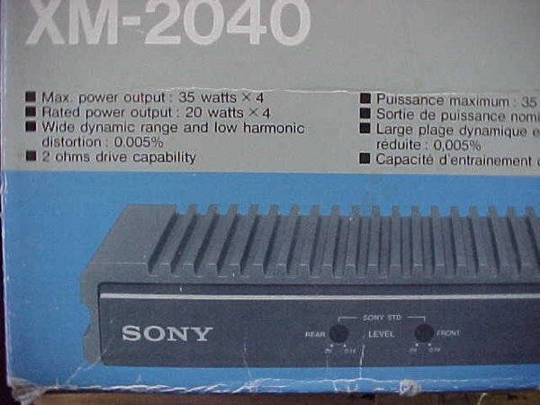

Simon, assuming you don't want to blow the doors off, then I have a Sony XM-2040 4 channel amp (true 20w x 4) you can have. It is old
school Sony - well built. It is also very compact (173x120x32mm). Got all the connectors. Specs in the attached file.
sony_xm-2040_sm.pdf
[ATTACH]76171[/ATTACH]
Thanks Andrew, that looks good. Spec sheet suggests it's 34 watts per channel RMS?
I tend to regard the "rated" output as more representative than the "max" figures. The amp was fitted in a 3 series and never
seemed (to me at least) to be underpowered for normal->louder listening levels. It was certainly better sounding than the built in
amps.
So with my '18w RMS', would that be 2w per channel more with this amplifier? Like I've previously said, I know very little about power ratings etc, so sorry if I come across a little ignorant.
If you check the spec sheet from Andrew it specifically says 35 watts per channel minimum RMS. So nearly twice as powerful as your existing.
From the depths of my audio geek past, RMS is higher figure than the actual continuous power (sine wave measurement vs DC equivalent) so I'm not surprised an amp rated at continuous 20W is also 35W RMS. And that's without going into Peak Music Power Output PMPO which is "think of the figure you'd like then double it" market-droid speak.
You also need to be sure that (like the Sony) the impedance is the same when comparing powers (both figures quoted into 4 ohms) and the distortion % is the same - which gives an indication of how "hard" the amp is working. So you'll get lower power figures if you test the amp at, say .05% THD compared to .5%. and let's not get into the definitions of "distortion".
