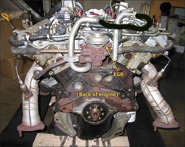

The biggest pain in the ass is access to it and you will be on your back in an awkward position, but if you are handy with he spanners very doable. I found cutting the pipes with a bosch multi tool and using some hose to re connect pipes was the easier option to getting the 8mm nut off the matrix pipe at the bulkhead behind the engine.

You could do the bypass to get you there, a length of hose to join the two pipes at the rear of the engine

Yes thats right, might be worth linking out as groover mentioned, check to see how bad the leak is by monitoring the water level at the rad cap and how wet the carpet is by the front of the transmission tunnel.
