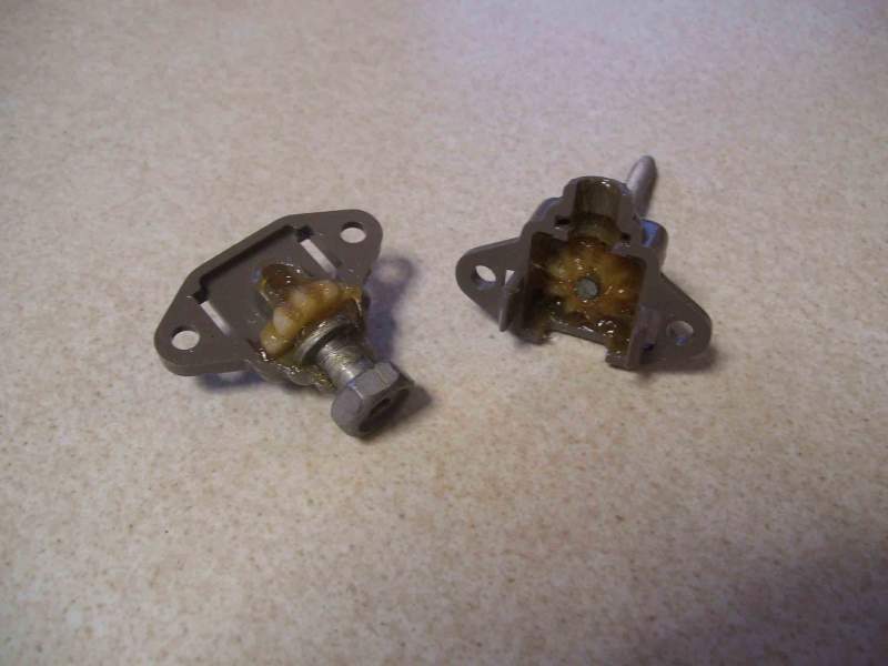

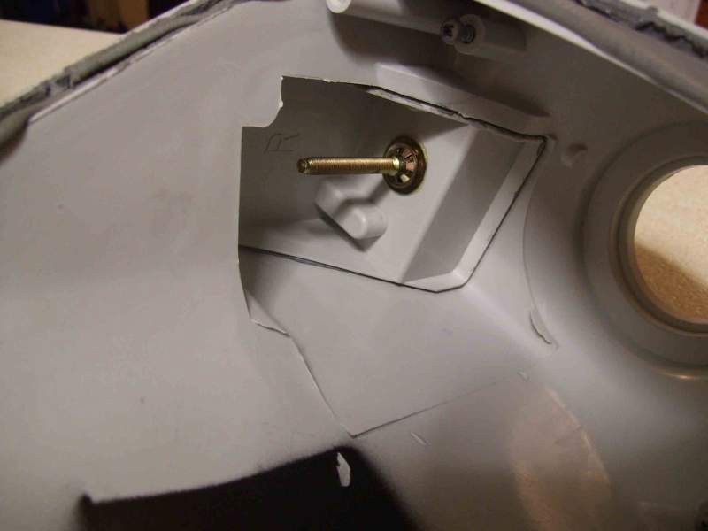

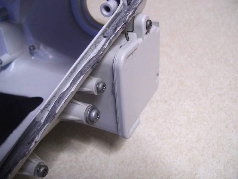

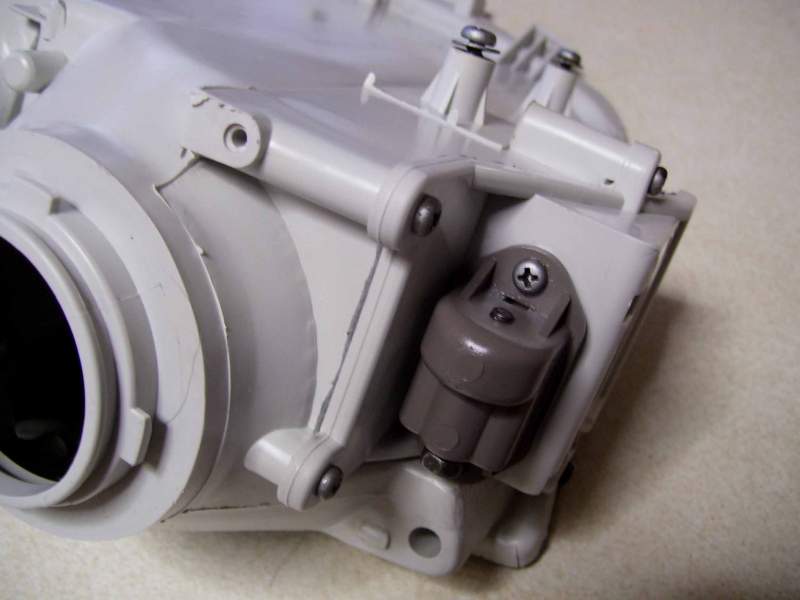

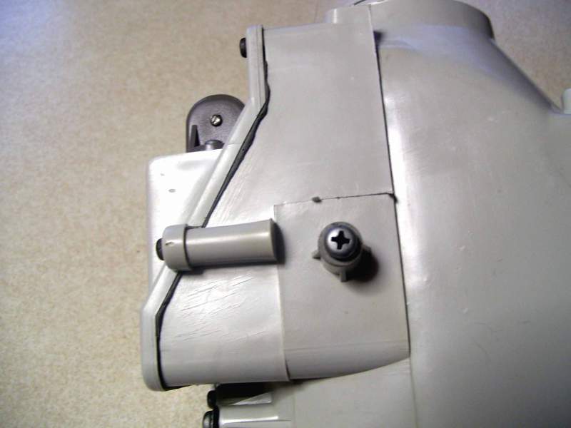

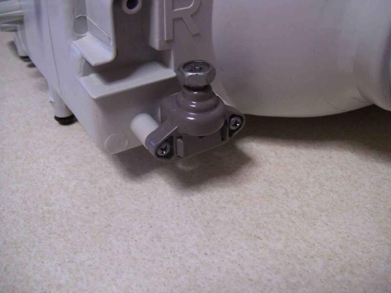

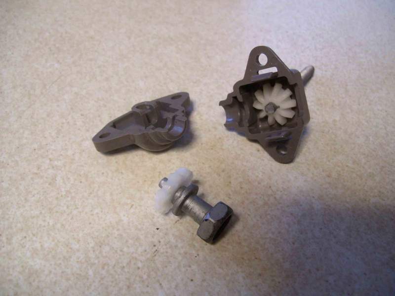

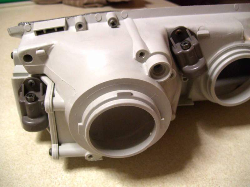

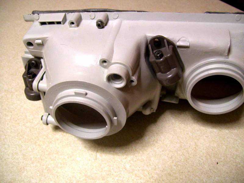

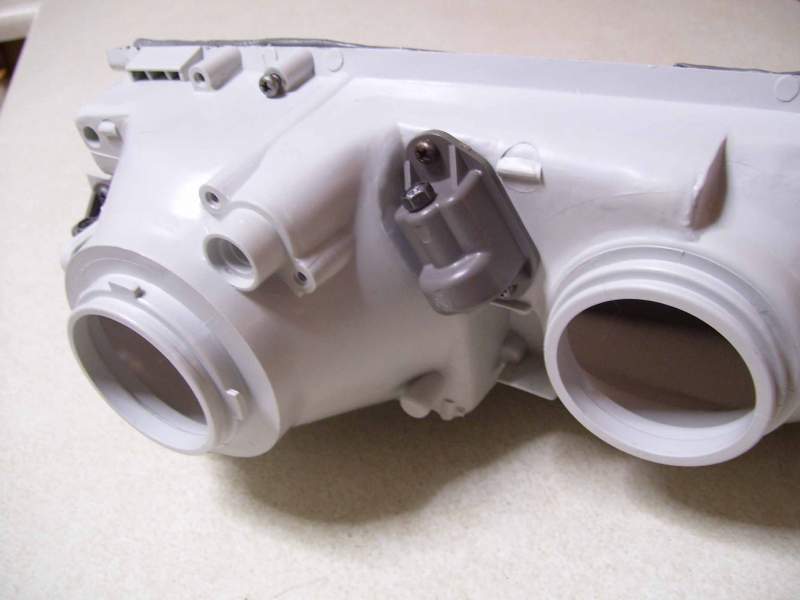

I thought I would final fit one of the adjusters along with wavy washer and new star spring clip washer.
Before assembly, I did pack the gears with new grease also, along with a liberal coating on the O ring.
I have to say, it does feel a lot smoother. Well worth the effort I think.
One thing I was a bit unsure of, was manipulating the sealant evenly back into the groove, but with some advice from Medallion Man it went fairly well.
Just need to be careful now when final fitting, I will have to keep things warm as I screw the 2 halves together.

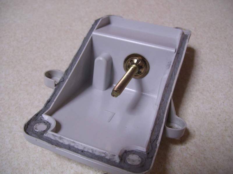

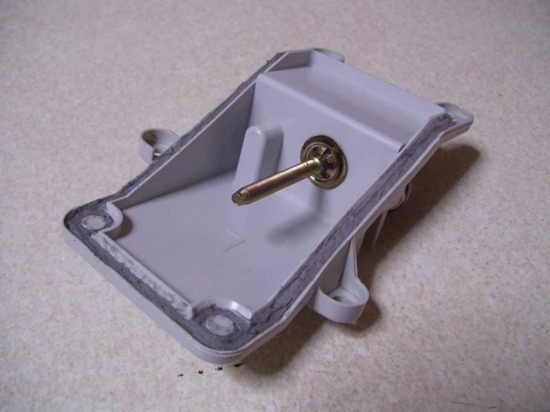

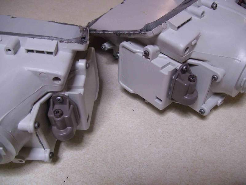

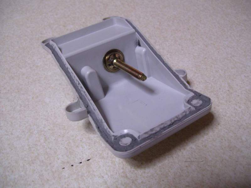

Firstly, apologies if I am pushing this thread too much. The last thing I want to do go overboard with it.
I fitted the side panel today complete with sealant. One thing I would say is, if anyone is contemplating doing the same. Please make sure you press the cover all the way home around all edges before tightening the screws. This way you will avoid pulling down the local area around the screw itself and fracturing the mounting points of the cover.
I would add also, It was well worth re working the sealant level before fitting, It really did help with an even overspill once fitted.

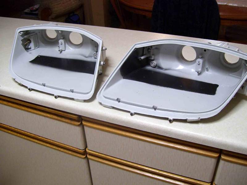

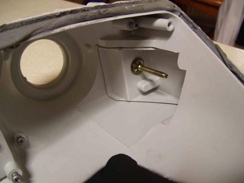

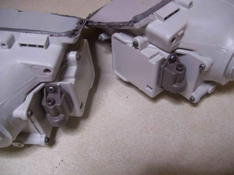

Managed to finish off the second side today.
Both went very well. Mind you, I did manage to use a little more sealant on my second attempt.

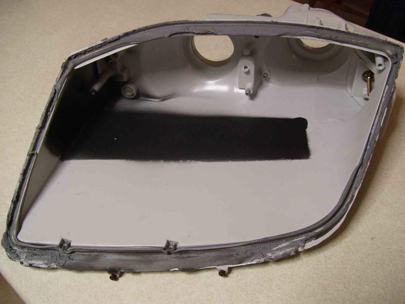

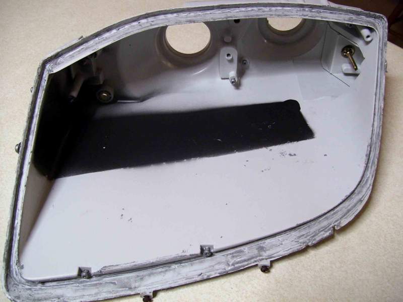

Well I thought I have come this far, so might as well go the whole hog and strip off the original sealant.
Not sure weather to re use the existing or go for new though.

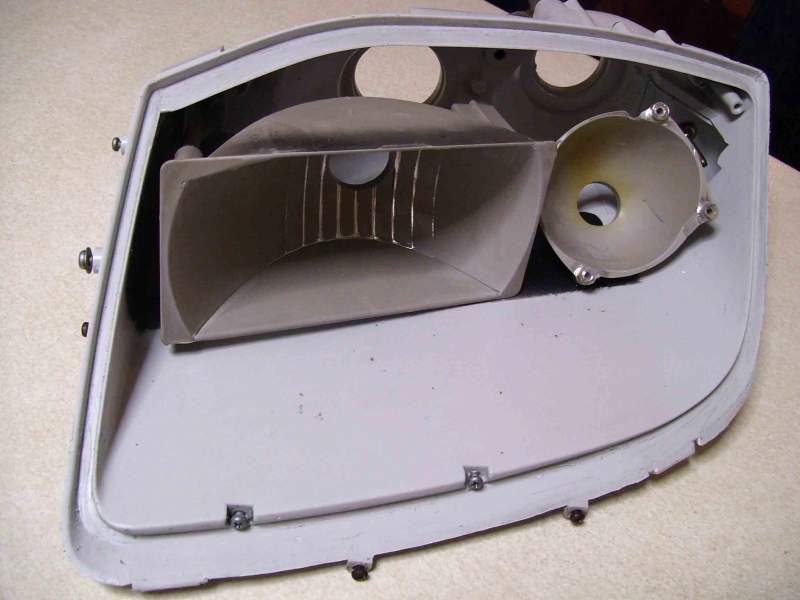

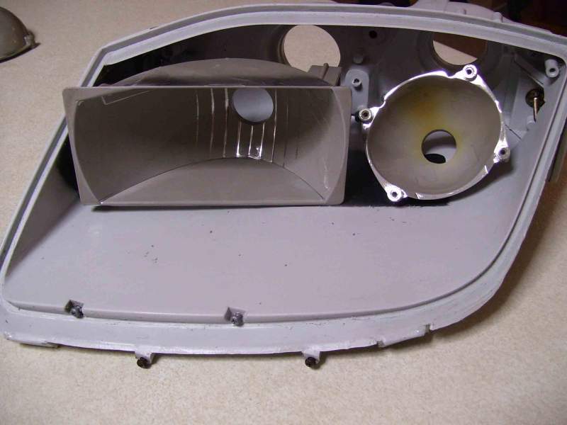

Well, I thought I would look into the possibility of getting the reflectors re silvered. (Vacuum Metallised to be more precise)
After a short Google, I managed to find a company close by that will be able to help.
So, having spoken to the guy there, I decided to strip back most of the reflector and let him have a look at them tomorrow. Once done, they should look as good as new.
(if not better)

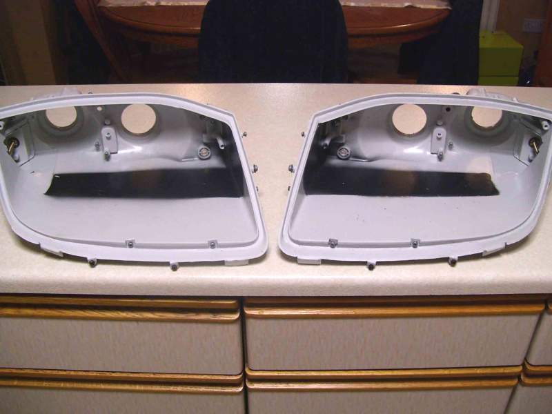

Dropped the reflectors off today, should be ready for Monday.
Then the re build can really begin.

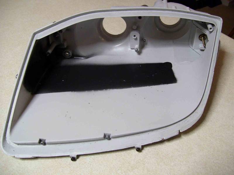

In the mean time, I stripped the rubber sealant from the second housing. Now I have a matching pair!
God! I hope you guys are not getting fed up. lol

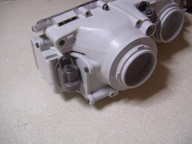

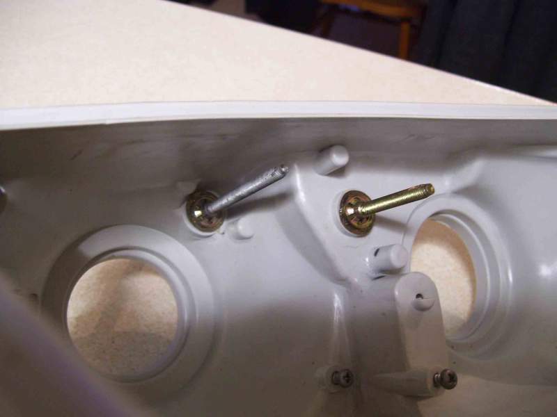

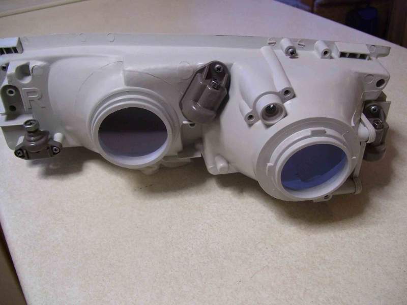

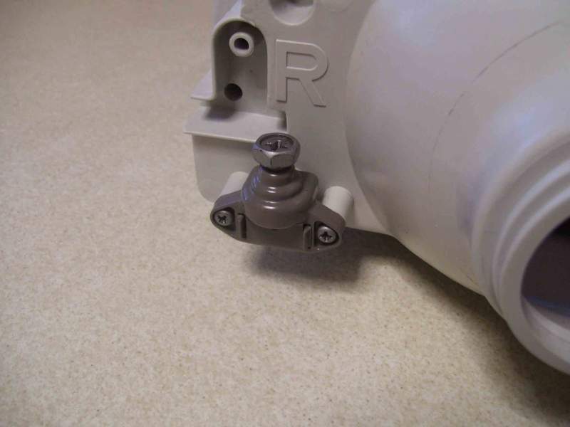

Finally, after hours of cleaning etc' I can now start rebuilding.
So I started final fitting the rest of the adjusters, packed with grease for good measure.
Happy days!

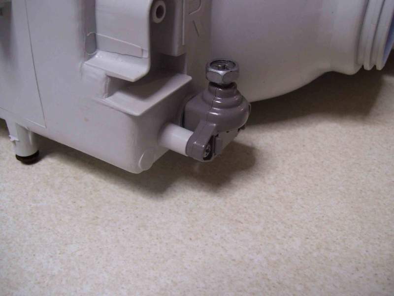

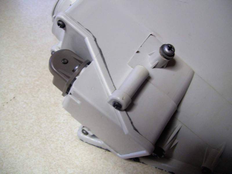

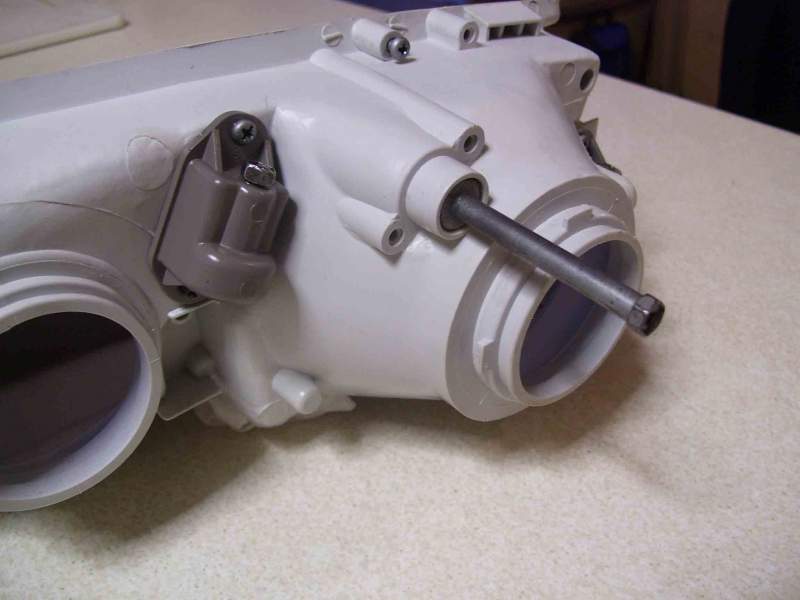

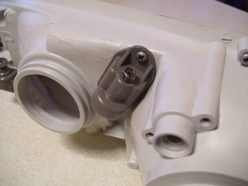

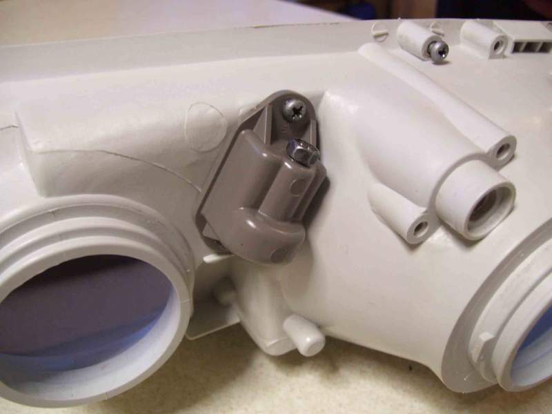

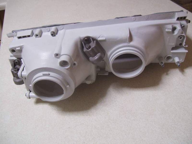

Managed to get both sets of adjusters fitted today, and even if I say so myself, they do feel very smooth.
Well chuffed.
Can't wait to pick up the reflectors next week.
In the mean time, I will be cleaning up the glass.
Also, I will be stripping the ancillary metal work back to bare metal ready for new paint.
I was thinking about using the original seal that surrounds the headlights, but having gone to this much trouble, I would like to fit new.
Are they still available does anyone know?

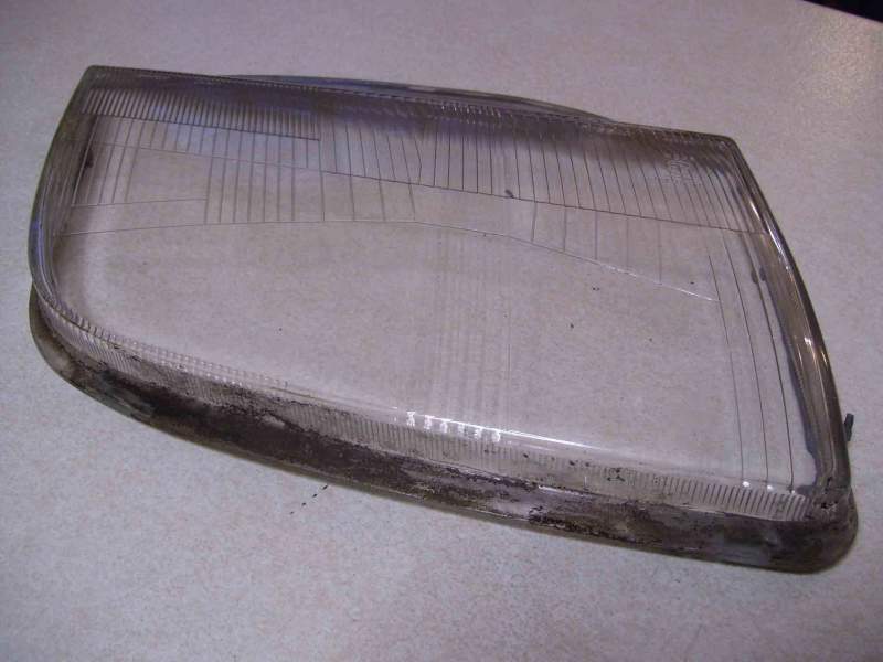

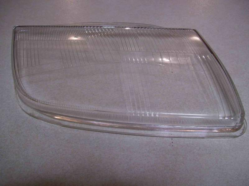

Not much in the way of progress today I'm afraid.
Still, every little bit helps I guess.
