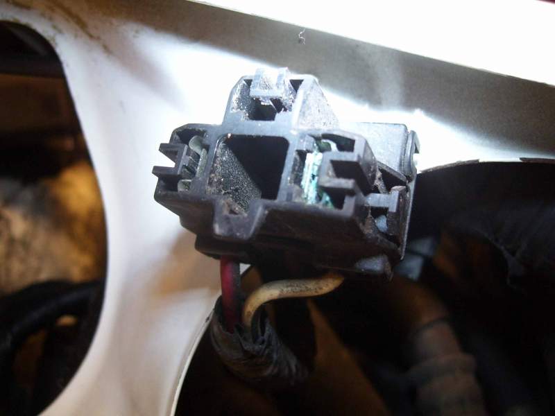

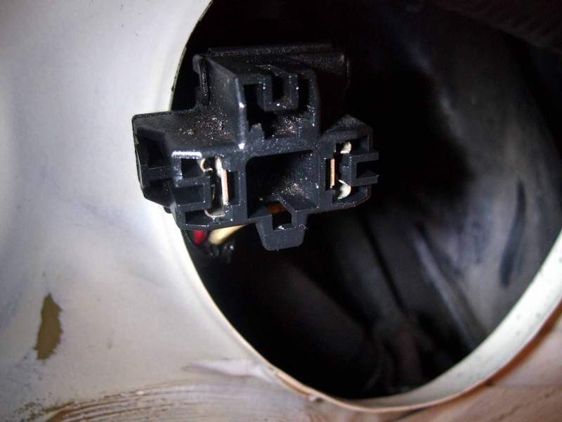

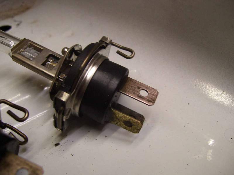

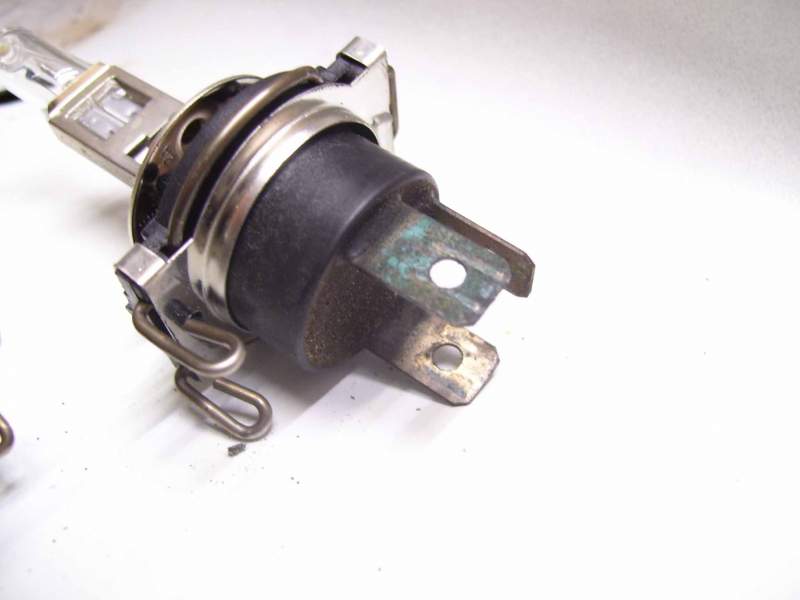

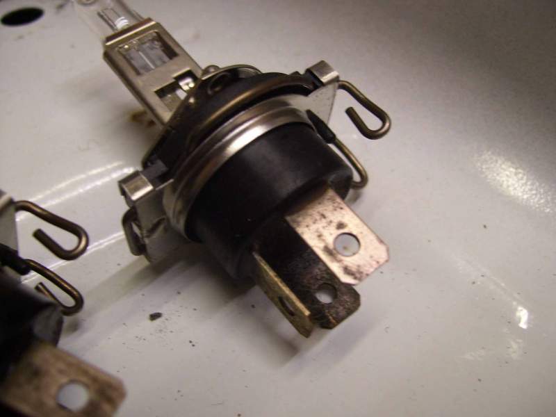

Thought I would take a look at the connections while I had everything in pieces.
I was shocked at the degree of corrosion, to say the least.
Decided to apply a bit of chemistry to get rid of the green build up.
Using a small kids paint brush, I applied white vinegar to the male and female connections.
As this is an acid, I anticipated it dissolving the corrosion.
I must say, the results were better than anticipated.

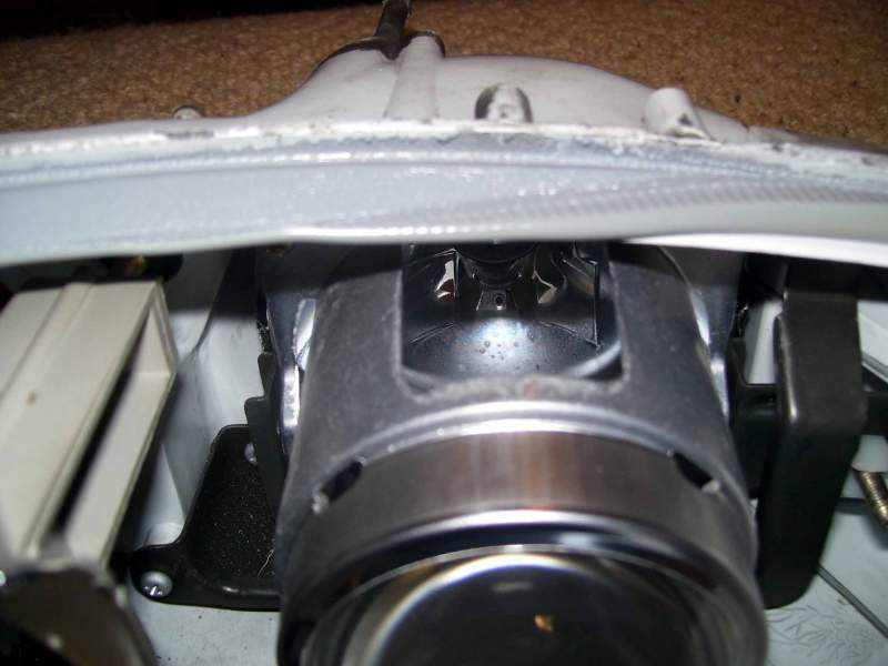

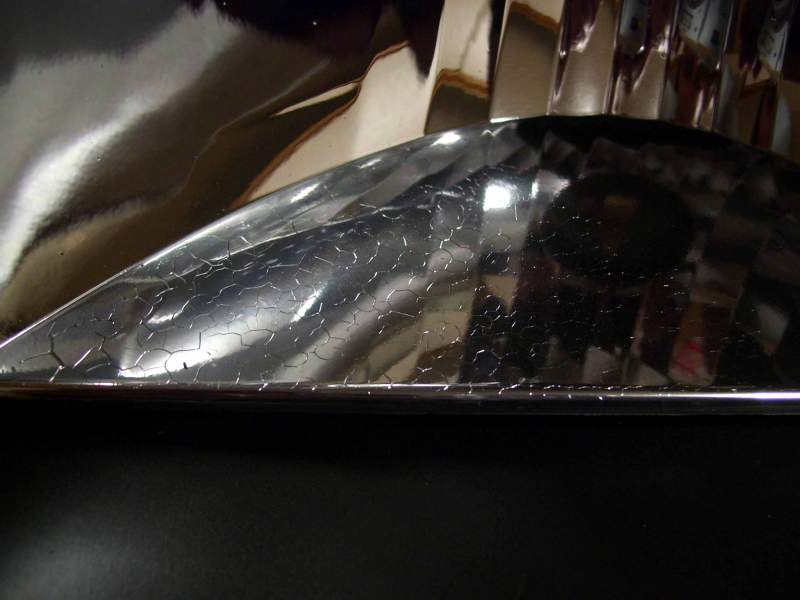

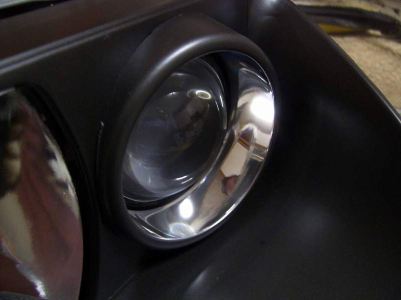

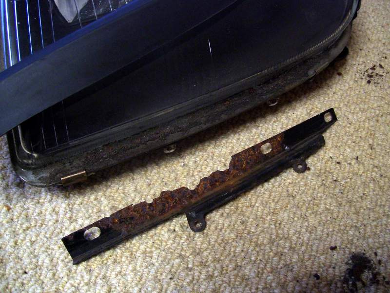

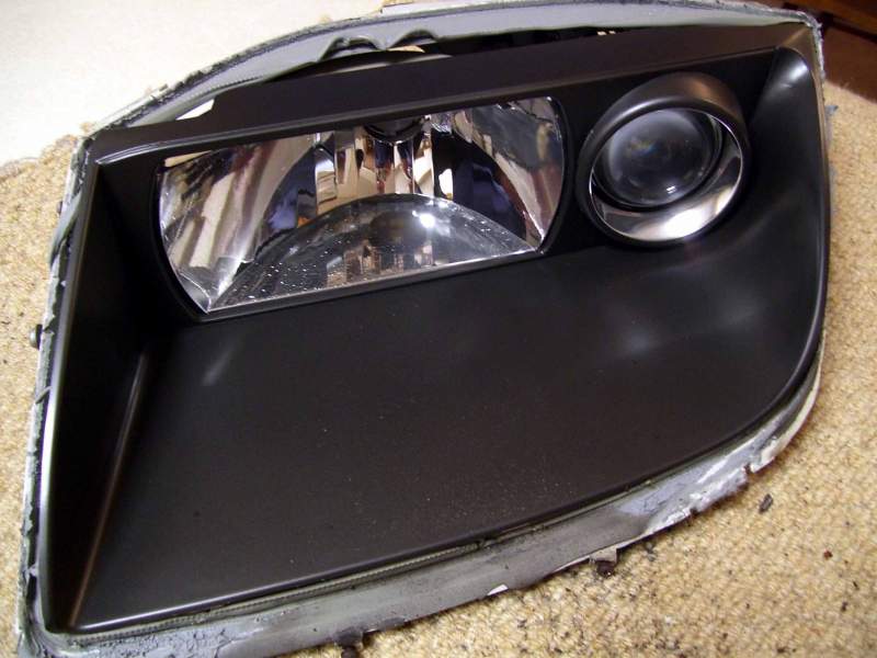

Made some more progress today.
Managed to get the left hand headlight stripped down, even separated the lens from the casing!! well chuffed.
Now here comes the questions.
As you can see, the main beam chromed reflector is somewhat crazed, It seems solid enough but would like to correct it. What are my options?
Also, I have noticed a lot off grime on the reflector behind the projector lens, is this easy enough to get at by removing it from the casing?
I have not cleaned this type of chromed plastic before, so any advice would be appreciated.

I might have a spare for that lens... and also the metal strip.... bad news is I can't have a look until next year !!!
well next week.. :) ... Thursday.. I know I've got a spare but can't remember what side.
If you can't fix it or get a replacement from anyone else PM me mid-week to remind me..
