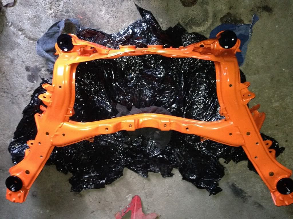

I did a how to on how to fit solid bushes not long back it's a piece of piss no press is needed at all I've done this loads of time the whole job is straight forward
Here's mines I've just done, drop me a pm if you need any info ect
I've got a spare NA subframe I could fit some solid bushes to it if you want and then you just trade it for your standard subby
