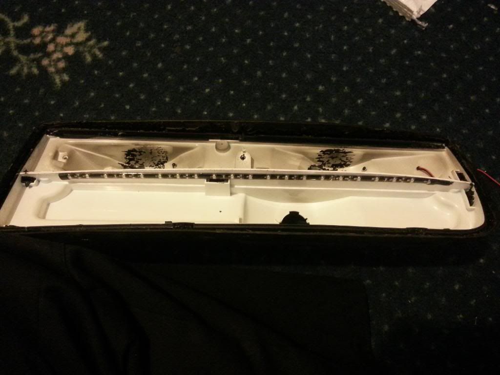

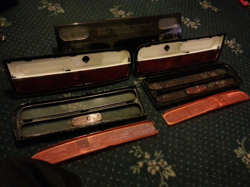

Start of rear tail mod.
Kudos goes to Medallionman for an amazing guide he sent to me without request to my email address.
I now hate Butyl/Tar and it's the worst stuff I've ever worked with.
Got through it though and got most of it off the car.
Here is how far I've gotten so far...

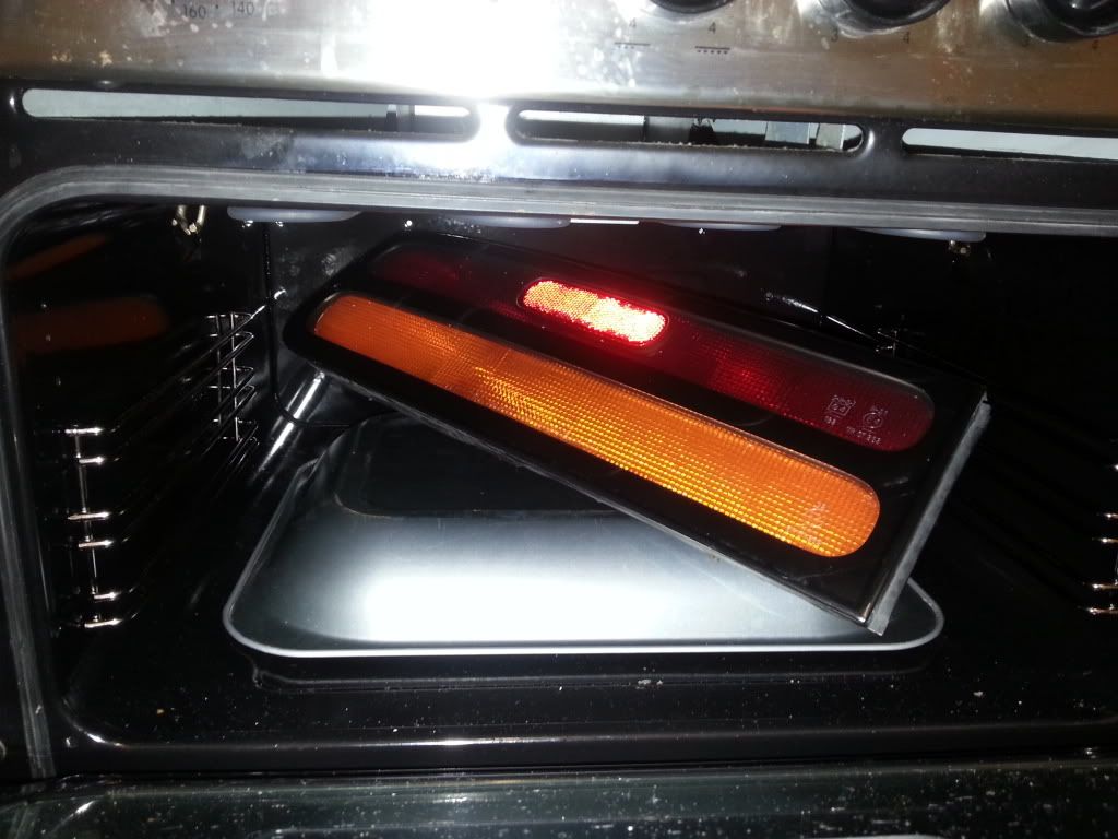

The heating for 5 mins didn't work for me.
I went for a bake of around 7mins in the oven itself.
The lights glided apart like butter.
No marks on the lenses and no cracks etc.
Well happy.
Watch this space on the mod I'll be doing.

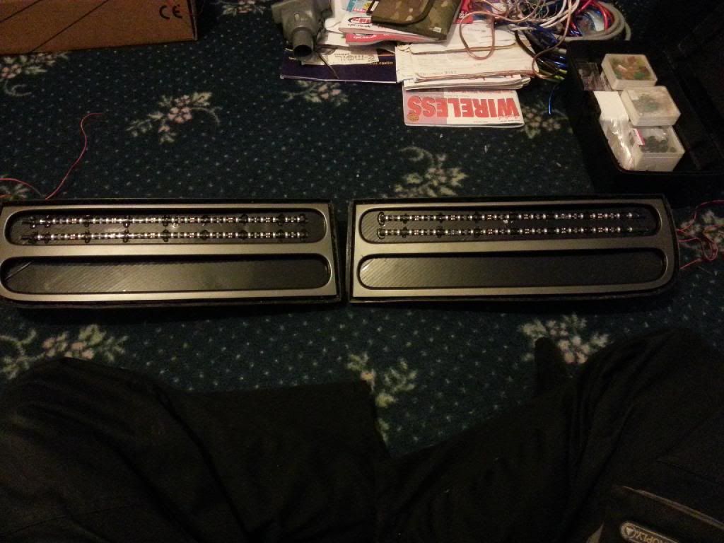

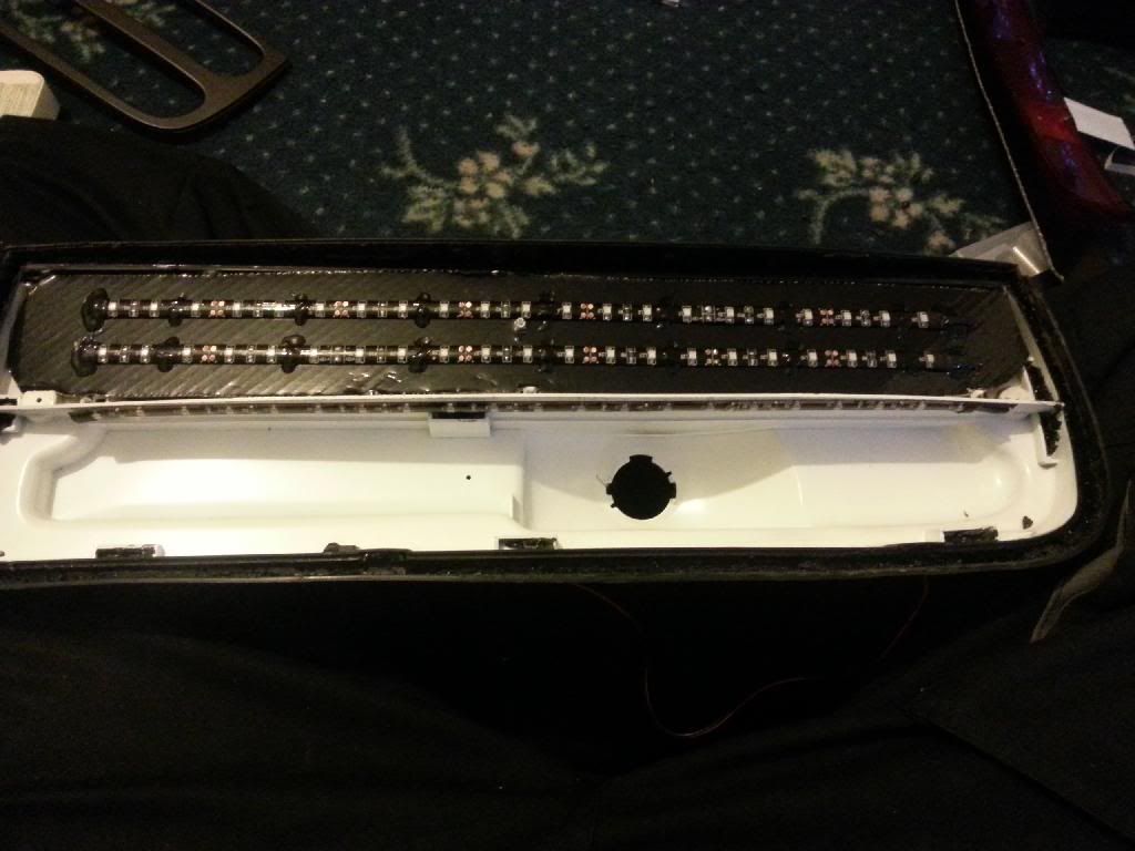

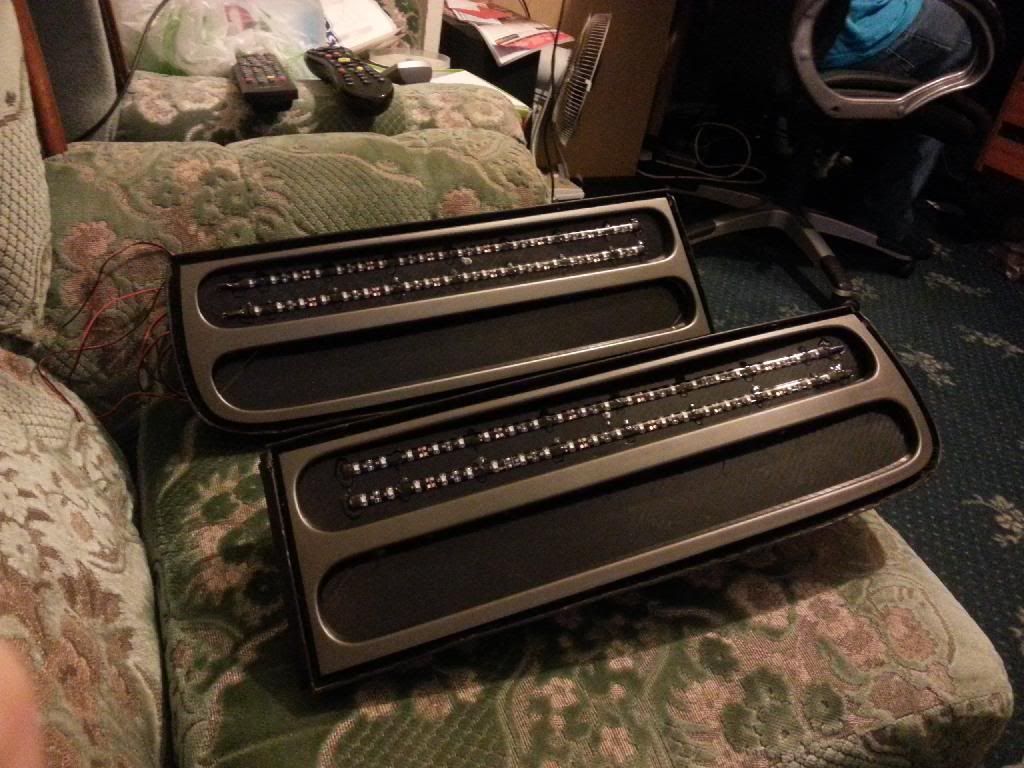

OK so I've gone for a slightly darker look with a black cardboard backing.
Fitting the lenses tomorrow.
Here it is so far....
IMG_20131221_191107_zpsnxxkew5x.jpg[/url]
IMG_20131221_194203_zpsdlh5xo0y.jpg[/url]
IMG_20131221_205754_zpspibd4onu.jpg[/url]
IMG_20131221_214532_zpsno8wqt4r.jpg[/url]

Your top two strips are both the same ? So is one brake and the other tail ? If that's the case when the brake one is activated it won't show up any brighter is what I'm thinking.
I notice you have mounted the indicator strip on the lip so this should light up the chamber very well, not sure on the need for the cardboard though here, you could of just sprayed black the backs.
Also and finally, cardboard may well dry out over time and lose a bit of it's nature, I mounted all mine on white perspex, you might also want to use some silicone to hold stuff in place as hot glue is not flexible.
As for insurance, I would of thought highly unlikely it'll be an issue, unless your rear ended and they start looking really closely into their workings, especially if there is a witness report saying that lights weren't on or were dimly lit.
Another thing bumblebee what the hell you thinking in keeping these on the sofa, you obviously have a death wish with the wife cos once that black stuff is on, you'll have one eck of a problem removing it :thumbdown:.

No gf or wife... It's my mates couch and most of the butyl is gone

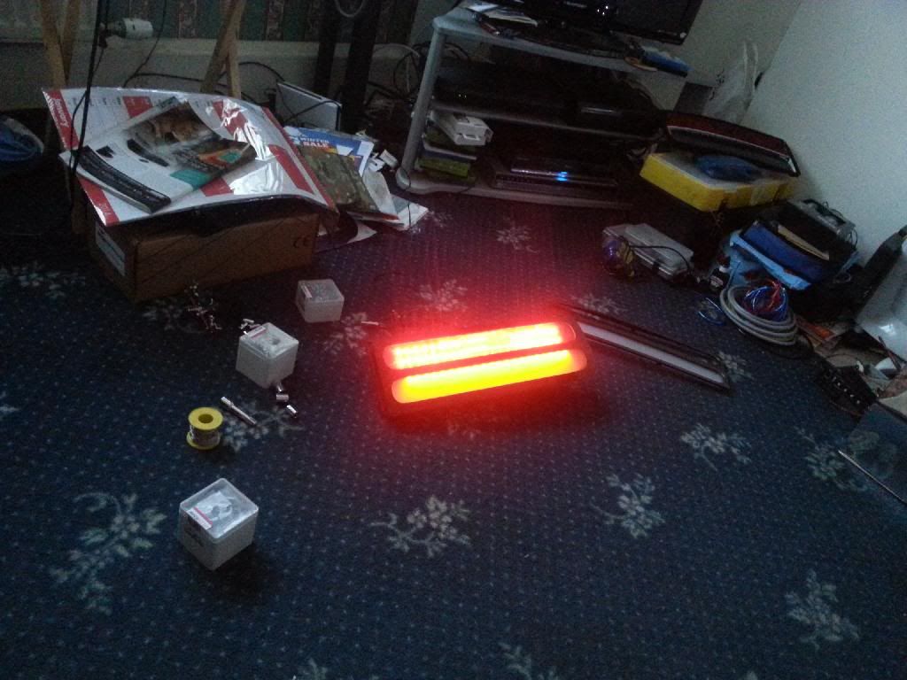

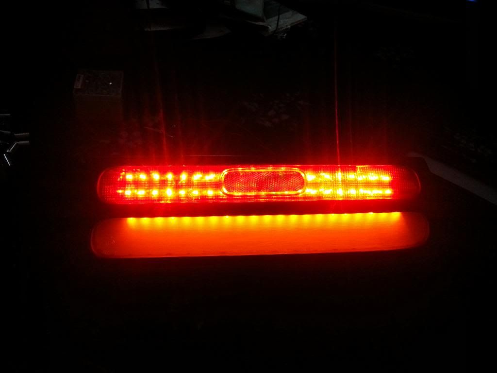

I did one shot in daylight...
I am in the process of wiring in a resistor to emulate the presence of a bulb filament. I think the relay is going to throw a wobbly otherwise.
Hope some of you like it.
Was the worst thing I ever did but was fun.
Just hope I don't see any steaming up or faliure on the LEDs.

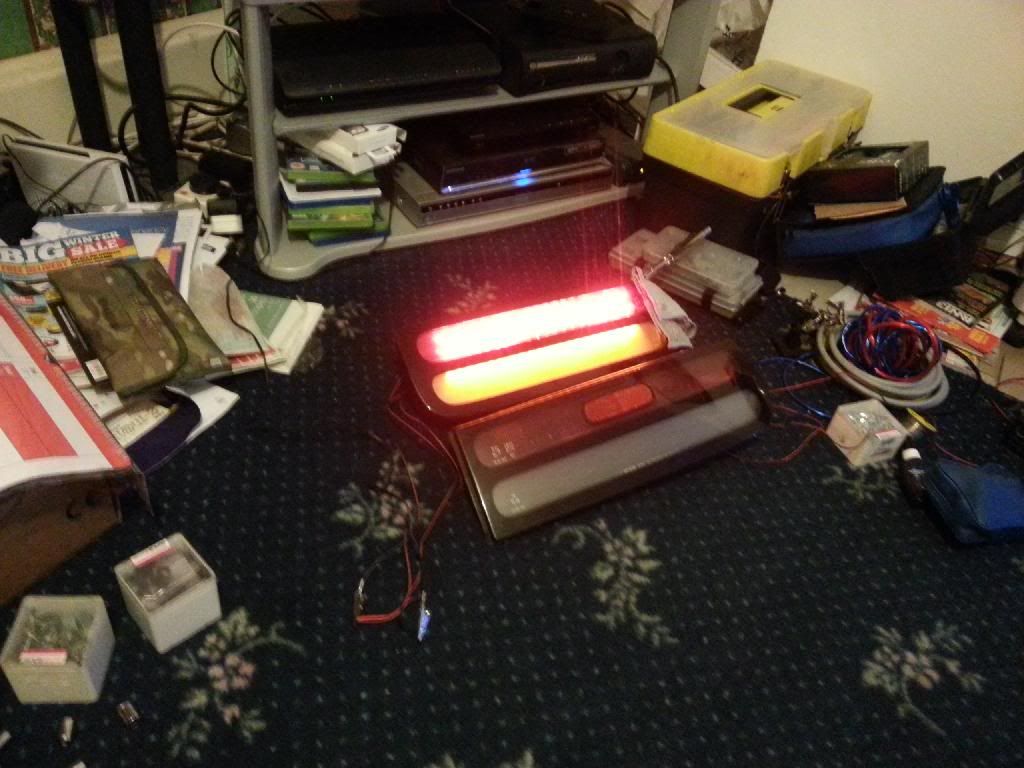

I wanted the rid the orange carrots mostly but thought I'd have a go at LED conversion too.
On the top tail strip I put an inline 510ohm resistor on the positive line.
The stop bottom strip is soldered straight on the same as the amber indicator strip.
Figured the colour codes for the wiring:
Red wire with green stripe - stop
Green wire with red stripe - tail
Green wire with yellow stripe - indicator
So tail is about 25% dull I'd say now.
Will get some pictures after they go on the car.
