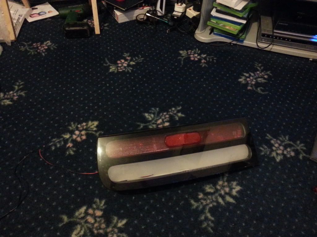

Start of rear tail mod.
Kudos goes to Medallionman for an amazing guide he sent to me without request to my email address.
I now hate Butyl/Tar and it's the worst stuff I've ever worked with.
Got through it though and got most of it off the car.
Here is how far I've gotten so far...
The heating for 5 mins didn't work for me.
I went for a bake of around 7mins in the oven itself.
The lights glided apart like butter.
No marks on the lenses and no cracks etc.
Well happy.
Watch this space on the mod I'll be doing.

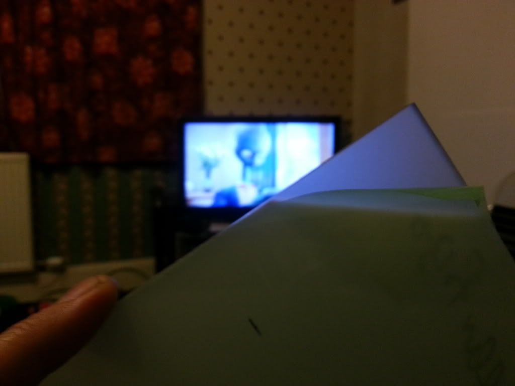

This is the material I ordered I'm planning on putting in front of the LED strips.
Fingers crossed it won't look tacky and won't see the LEDS.
Will update the thread when I get the LEDS

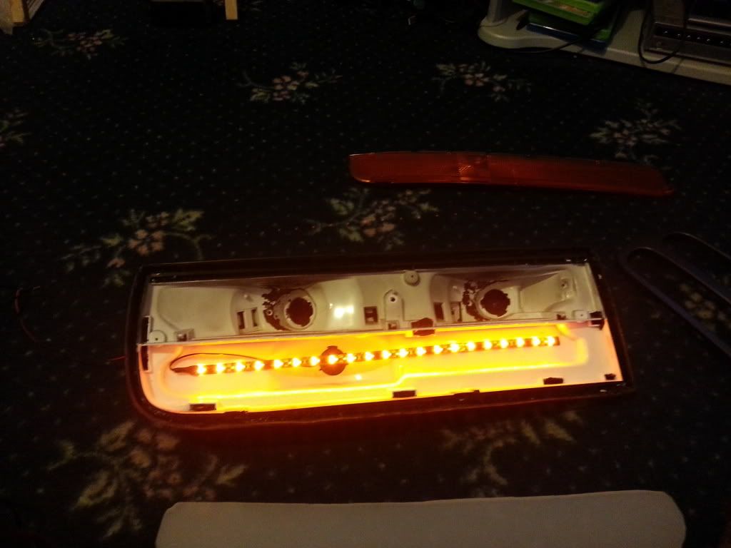

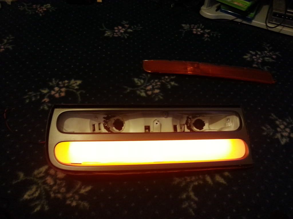

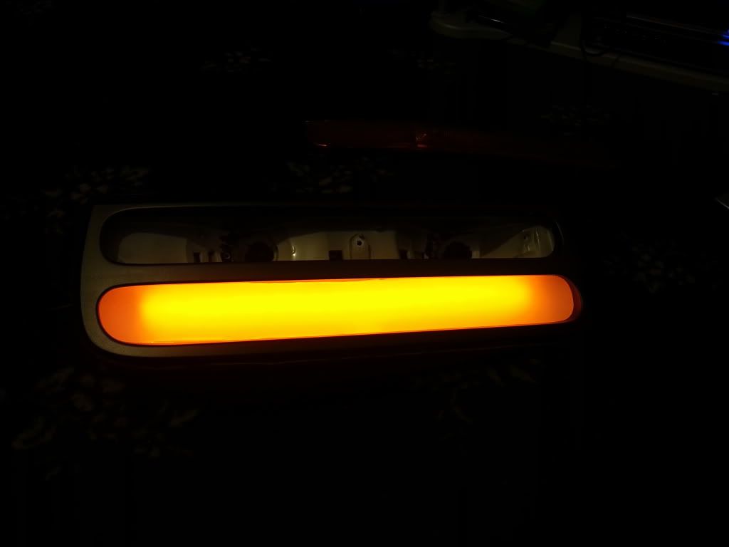

Well here is a tester.
Doesn't help I'm crap at anything DIY like cutting and measuring up... think I'm going to have to go to some sort of shop to get out cut to fit (the perspex)...
It's cone out exactly how I hoped and can't wait until I get it in and the LEDs glued in properly.
Anyway.... Here is the tester.
I didn't have the indicator on a relay. I held my phone and stimulated it with my other finger on/off the +12v lol.
I have recently nicked some frosted perspex from my sister-in-laws business as I was gonna try it this way (before I knew you were gonna do it).
I cannot decide if I like it or not now though!
Maybe a mod can fix the video link?
Not working on here.

Thinking the normal red lense should go back in on top.
No perspex... Just leds behind.
All down to taste Lexx. ...... 'marmite' bud ;)
I think I'll need to see it when the unit is back together and the "gloss" effect of the light cover is there too.

The frosted opal perspex came from a company called Arcola on the Trinity Trading Estate.
You can Google it, send him an Email and he'll send it to you.
It was around £28 for a 700x400 sheet.
I walked in and bought it and he advised me in the best light spat without seeing the LEDs which is what I wanted.

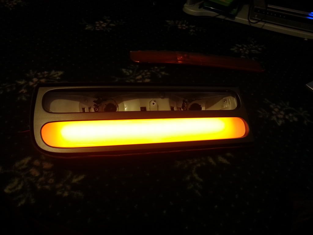

And update for Lexx.....
Obviously you can see the cable when it's off as I've not cut this section carefully enough yet.
Will get a shop to do the proper one tomorrow now I'm happy.

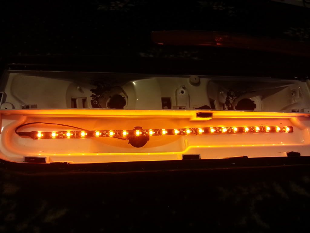

Phatmusch....... One strip of LEDs are in the bottom.
Going double in the top.
One strip will be brake... Other will be tail...
I'm working on this bit.... I may put the tail on a reduced resistor so it only glows 3/4 or 1/2 brightness if it doesn't work.... but leave the brake on full.
I'll have to play bud.
Edited by oobumblebeeoo
Good luck with your playing but I don't think those strips will be bright enough for the brake part even on 100%, but they're in front of you not me.
You might find these brighter for the brake part and are the ones I used or use, no sticky bit on them though so you'll need to get some silicone on and around them so they don't move.
http://www.ebay.co.uk/itm/2-X-24-RED-LED-24CM-Linear-Flexible-Strip-Car-Light-12V-/280600457132?pt=UK_CarsParts_Vehicles_CarParts_SM&hash=item4155172fac
