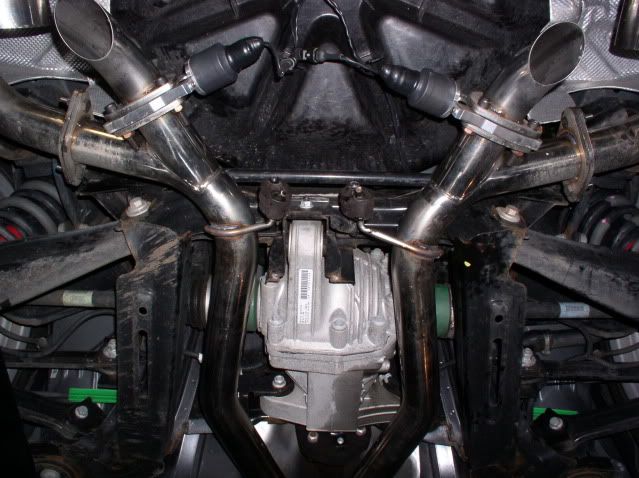

See this vid of my VXR8 when I had them fitted:
Love the vx8 there different valves to the ones on ebay
Or this one 261031706327 but could struggle with space ?
Same theory.

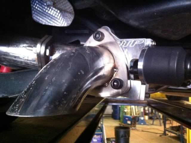

You see where the cut-out pipes are bolted on to my exhaust? Well that's where the valve is (same kind of butterfly valve as your ebay link)
Think about it for a moment - how would placing that valve quieten your exhaust if it was placed in it? Well, actually, if it was closed it would - it would cause so much backpressure your engine would stall and you'd have no noise at all.
These valves are designed to be placed just before a cut-out pipe.
So you could get a garage to modify your current exhaust and fit them into a Y pipe on each side. But you would still have your current sound when they are closed, and louser when open.
