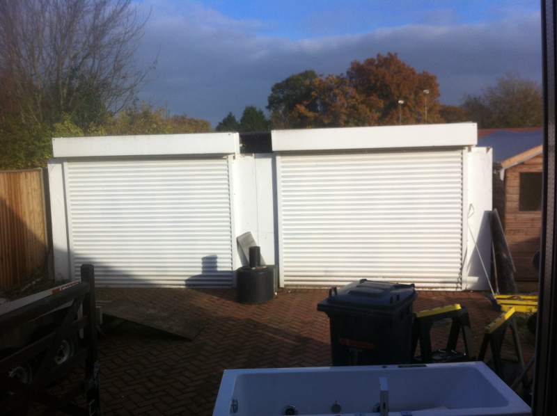

Electric roller shutter doors are best, not particularly expensive and any size can be made or cut down. Go as big as your local council allows if you're not going for planning permission but there are rules which you'll find on your local website. If you are going for planning then it's a different story. The best advice I can give you is that if you're building a brick garage then fit the piers on the 'outside'. This gives you more room inside but also most councils measure the garage size based on the internal dimensions and that would be between the piers losing a fair bit of space. Look at the photo these pair of single garages I built last year as it was beneficial for me to have two single instead of one double. External piers and flat roof single ply membrane provides the biggest internal space. I can fit my trailer inside either of these and close the door :)

A double front is more limiting as two singles are future proofed against a change of use later. For example you might want a garage and a gym or workshop. Two single doors even if you don't split the garages entirely will give you loads of options at a later stage. Costs more money though :( Yes you can buy insulated roller doors. Here's a link to a very good supplier and cheap too and always keen to do a deal in my experience
