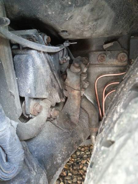

thanks chaps , no cats there long gone. when i get some new pipes ,decat pipes ill take it of then tell now ill just take this black box out drain it and replace. thats a summer job, to cold now and i dont want to take up my brothers ramp again after last week.

can you describe whitch bit on my photo? just drill a small hole in the bottom side of the black box?
the inlet air elbows before it goes into the aiv, so when its working it has to suck the air through the pool of water at the bottom. its probably easier to bin them altogether as you say you have no cat's anyway. at least disconnecting the vacuum line from the AIV sov on the bulkhead would disable them and stop the noise.
