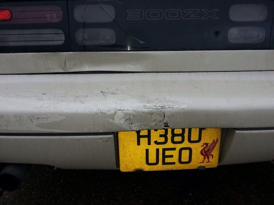

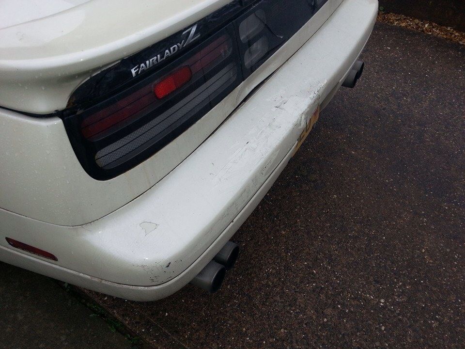

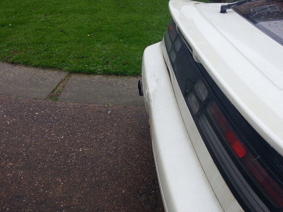

Here's the damage from earlier, I must insist no mention of my cars value is NOT to be mentioned in an open forum for insurance purposes. Thanks.
So that being said how much do we think this lot will cost. The rear panel is fubar! The metal panel below is huge and goes all the way round to the doors so that's un replaceable the rear bumper is also a bit of a mess and isn't straight anymore.

Cheers mark, was expecting that to be honest, you should see his car it's a bloody joke. Sod all damage just a bit of a nick right under the bumper and the rear lip as come away slightly. Thanks for the reply though.
Hmmmmmmmmmm........need to see in person but can't see anything that isn't repairable, Paint will be the bugger to match!

Looks like :
Centre light panel - replace
Rear bumper - replace
Rear panel damage - repair
Bumper reinforcement beam - Possibly needed, hard to tell, you would need to check
Insurance repair would be quite significant and would'nt suprise me if they wanted to write it off. However as a non-insurance repair its very easily salvageable with some 2nd hand parts and a good bodyshop.
Edited by Yowser
As said above really, Manta would need to see it to be 100% but the obvious parts can be bought second hand, hidden damage is always an issue before stripping, however the rear panel under the light and the bumper damage is quite high this would most likely make hidden damage to be less likely.
The panel under the light is best repaired with a slight pull and some metal working, the only bit that is difficult is paint matching either way still going to be around £500+ to repair yourself, an insurance repair would be more like that in labour +paint and materials and £1k for parts ( all new from Nissan) by the time you have added vat its a £2k repair madness I know, and until the other party admits fault you will have to pay your excess and claim it back.
Note: The rear spoiler would not be done under any insurance claim as it looks to be suffering from water ingress already, so it would be "betterment" so you would end up paying for it.
