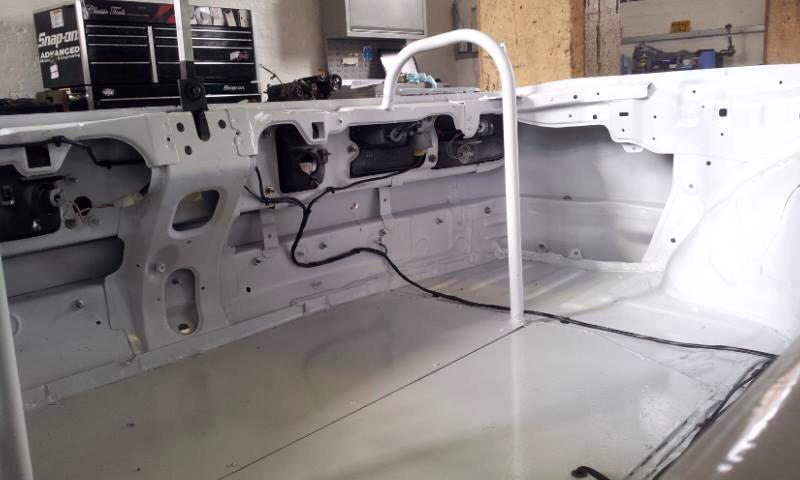

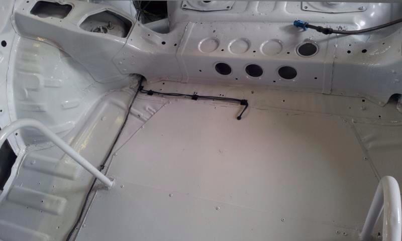

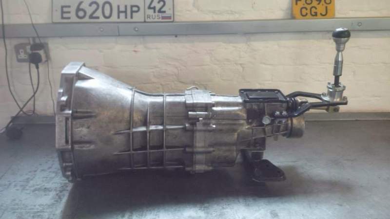

Slow but sure have been seriously held up awaiting parts but now they're all in the UK and things are taking shape. Here are a few photos showing some of the work taking place. Engine being finished by Jimmer and he has lent me a dummy engine so Dan can use it to cut and shut for the turbo install. Look how clean and simple the wiring is looking. The target is less than 1200kg and more than 900bhp should be fun!!!

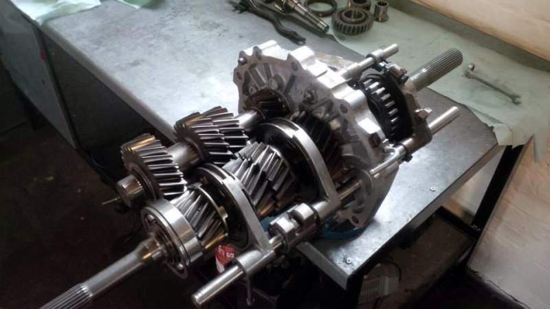

That's a five speed PPG helicol cut dogbox. It really held me back last season but hopefully we have ironed out the wrinkles and this year it will prove to be a winner. TOTB anyone????

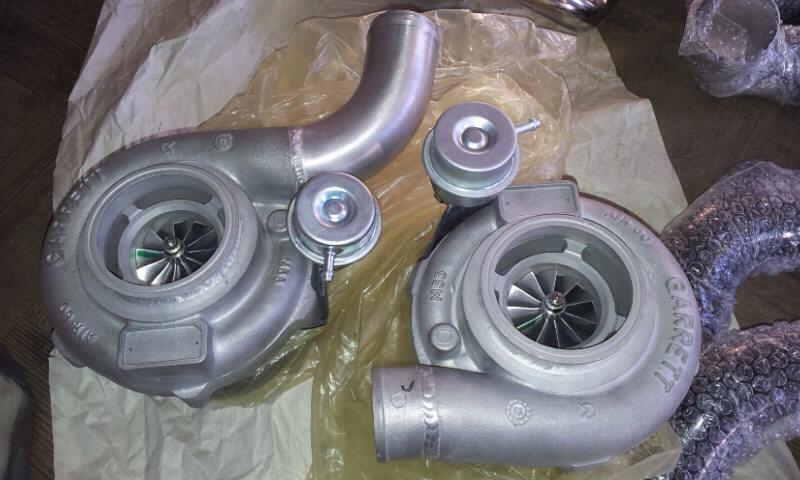

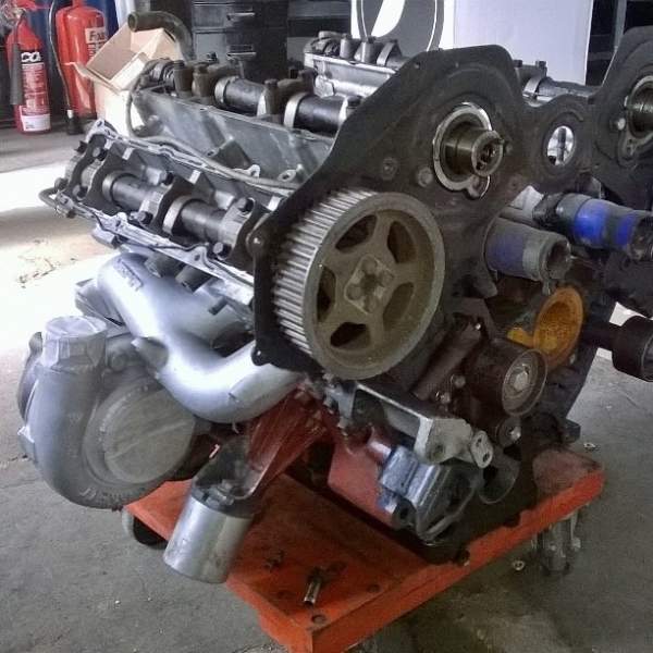

Just an update on progress. I picked up the engine from Jimmer on Friday and it is now at Advanced Motorsport Engineering. Current programme we hope to be on the rolling road in about 4 weeks with first testing a couple of weeks later. It is a long and slow process not helped by various suppliers being very slow! However this was always going to be a major rebuild and I expected some issues along the way. Most of the rebuild has been shared on the following Facebook page and I expect AME to share there as we progress. I will try to update here from time to time too
https://www.facebook.com/bob.dixon.737/timeline/story?ut=43&wstart=0&wend=1396335599&hash=-5633238575779497180&pagefilter=3

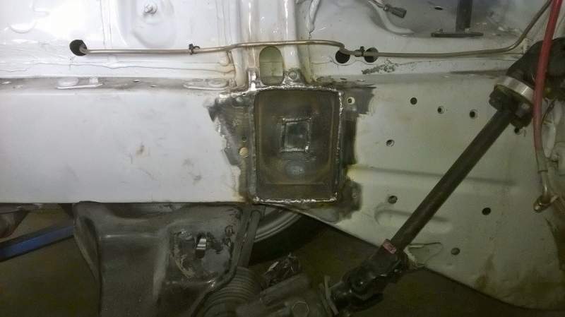

Jimmer has done a great job on the engine and will continue to liaise with AME over the coming few weeks. We need to do some welding to the chassis rails but by end next week the engine might be sat in the car with two rather large GTX3071R turbos nestling in there :-)

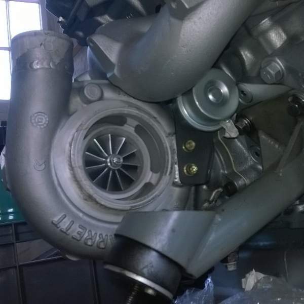

A couple of photos to share. One shows the turbos fitted to the dummy engine (thanks Jimmer) which we used while the race engine was being built and helped us to see where the chassis rails needed modifying. We're just cutting into the right side (see photo) the left just needed a couple of taps with a large hammer. Then a photo of the race engine and a slightly damaged engine mount which needs replacing. The crash at Cadwell damaged the car from front to back and we're still finding things but hopefully from now all plain sailing :)
With a bit of luck in three weeeks will see it on the rolling road and first test run. Maybe a little video will be on it's way :)
