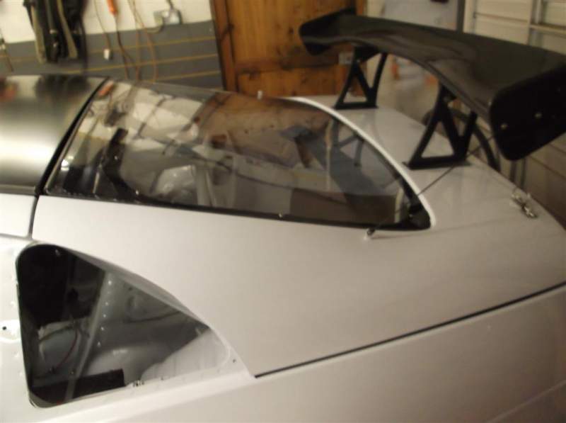

i got the new rear polycarbonate screen in place for a trial fit and drilled all the holes for the securing screws. This is always a nerve racking little job as its easy to crack the polycarb.
As Paul wasnt available today I summoned Danny my daughters partner to assist with lowering the polycarb on to a nice thick bead of Sikaflex marine grade. There is no room for error here ... you only get one chance to lower it in to place. First it has to be tucked up inside the top trim strip then lowered evenly on to the Sikaflex
It all went well .
We then carefully nipped up the securing bolts n nuts to keep a little pressure on the polycarb while it cures.
I will probably need to leave some heat on overnite to keep the temp at a level where it will bond properly
lastly I re made one of the rear wing securing stays so it bolts on the little securing mounts that Bodymech fabricated and fitted for me.
Paul is booked in for tomorrow so we can move to the front of the car..............................
A couple of pics......................

Nice steady progress, why the need for the extra wing stays, has it tried to go walkies?
The rear hatch is very flexible. So the little stays just keep the spoiler from moving too much.
Are they neccessary??? Well who knows.
Its the same with the polycarb window ... do you need Sikaflex and screws???
Belt n braces approach I suppose .

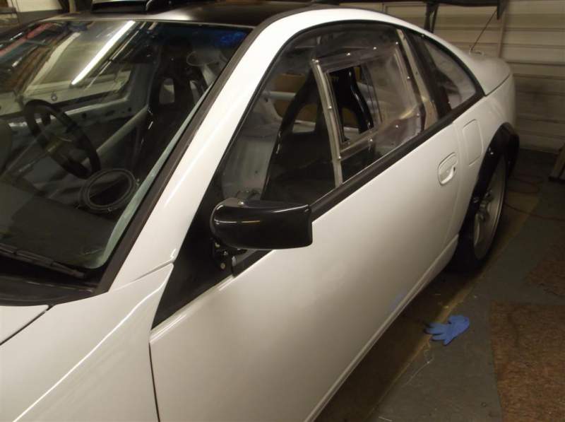

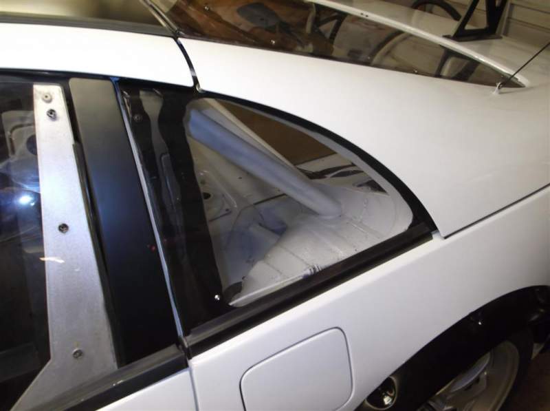

and today the rear quarter window proved quite tricky.
Paul and me had to resort to some "thermo forming"....{ hot air gun on polycarb} to get the lh rear quarter to fit nicely.
However its all in and sealed now.

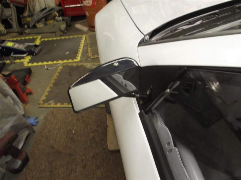

Paul took the front coilovers off and evened out the settings. swapped the discs on to the correct sides and turned the LH top arm round the correct way. One locking nut was very loose. Nothing is loose now.:biggrin:
The last bit of custom thinking and fabricating centered on the new light weight Spa mirrors. The previous ones were difficult to adjust and stay tight in one place. These ones lock in place from the back inside the door which involved a bit of extra hole drilling.
Im confident of the solution. Its all hidden by a black ally plate carried over from the previous install..
So all the tricky stuff is complete on the LH side. I just need to repeat the three installs on the RHS.
Few pics of the progress.....................

I now have all the RH side windows mirror and spoiler stay in place.

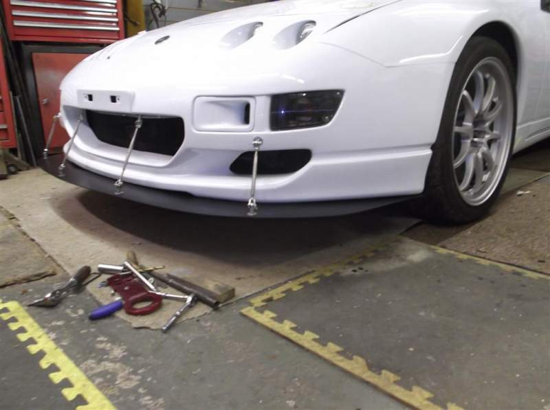

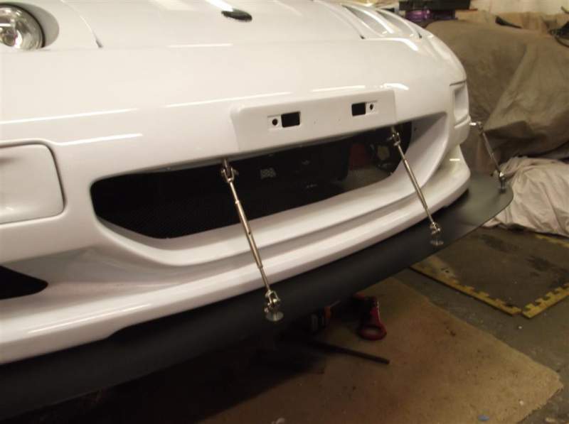

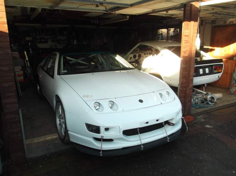

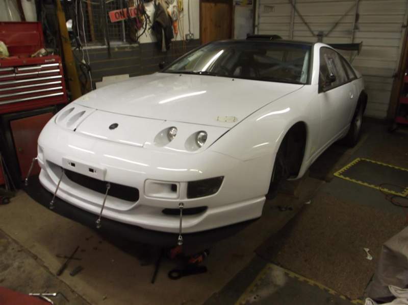

So another long session today from Paul and me sees the car 95% done for our part at the moment.
We have re fitted the oil cooler
Fitted some nice powder coated alloy mesh to the bumper.
And for most of the day made and fitted the front splitter and installed the stays.
The car sits high at the moment without any engine and box fitted.
It will drop a bit when thats fitted.
Then we can lower the front suspension to race height.
Todays pics and one from during the week of the final fit of mirrors and Lexan.......
enjoy.........................................

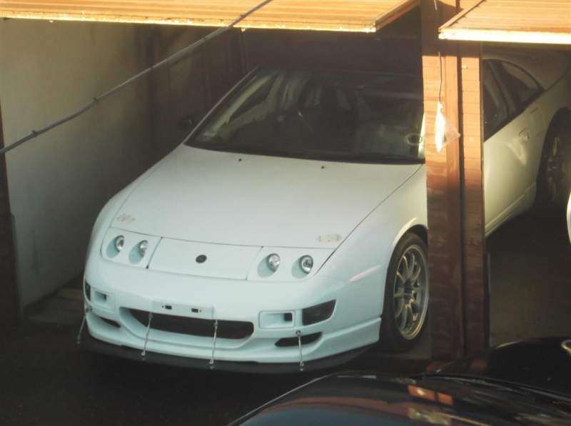

The splitter/engine under tray looks very racy guys. :thumbup1: Are you and Paul putting the engine and box back in Pete?
No we dont do technichal!!!:whistling:
Its off soon to have an extension to the weld in cage then back to Jimmer for the engine I think

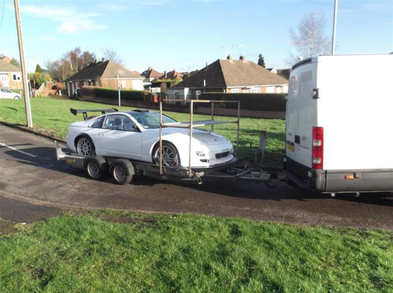

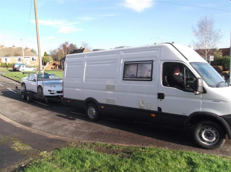

Well as Bob was coming up the motorway on this fine sunny day I was busy getting his car and boxes of parts ready for loading.
When he arrived we set to and loaded.
He was soon on his way as I bade a fond farewell to this latest phase of the story.
Enjoy the pics.....................
