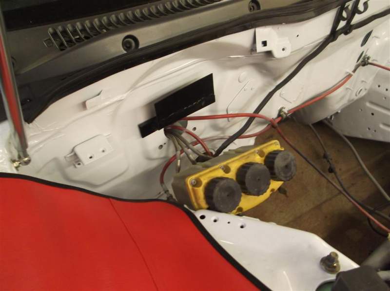

So a few pics meantime and can you spot the brake problem???
I have also highlighted some fittings that need "improving"
Check out the rats nest of wiring too!!

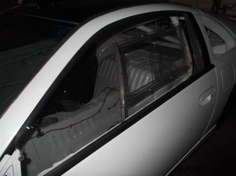

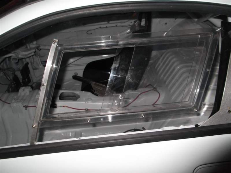

The Lexan windows and sliders were OK but suffered from two problems. The screws holding the sliders were only tapped in to the perspex so as the season wore on some pulled out . We didnt notice it till Brands round when the wholw windows were flapping alarmingly.
We have replaced all the srews with longer ones with nylocs on the end now.
We have also added a cental stiffner made from box section ally and bent to shape.
Its not a particularly elegant install but it does look like the windows wont flap out again.
I will probably paint them white so they dont stand out so much.

Drivers side window has been re assembled and awaiting re- fitting with some new longer set screws which arrived today.

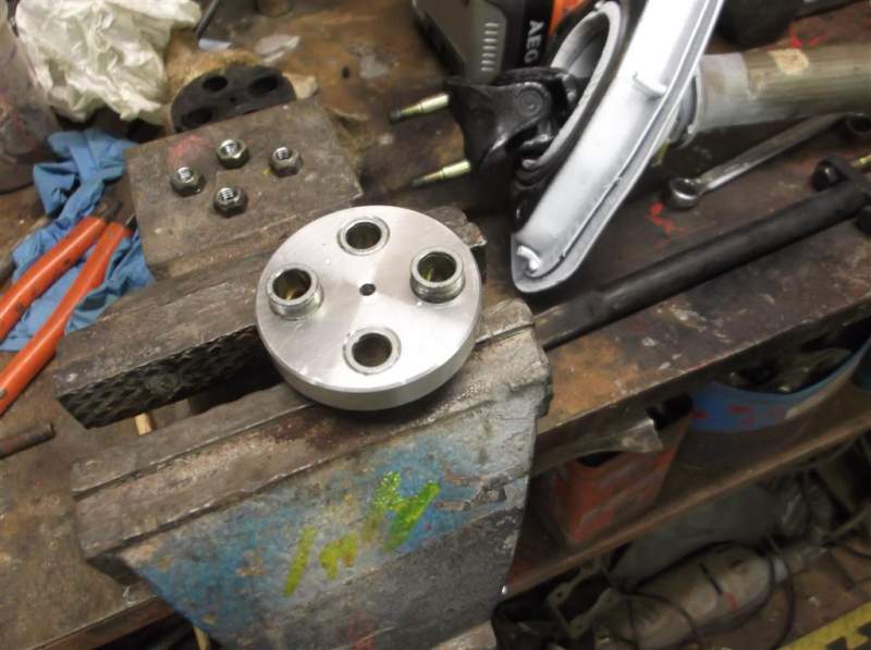

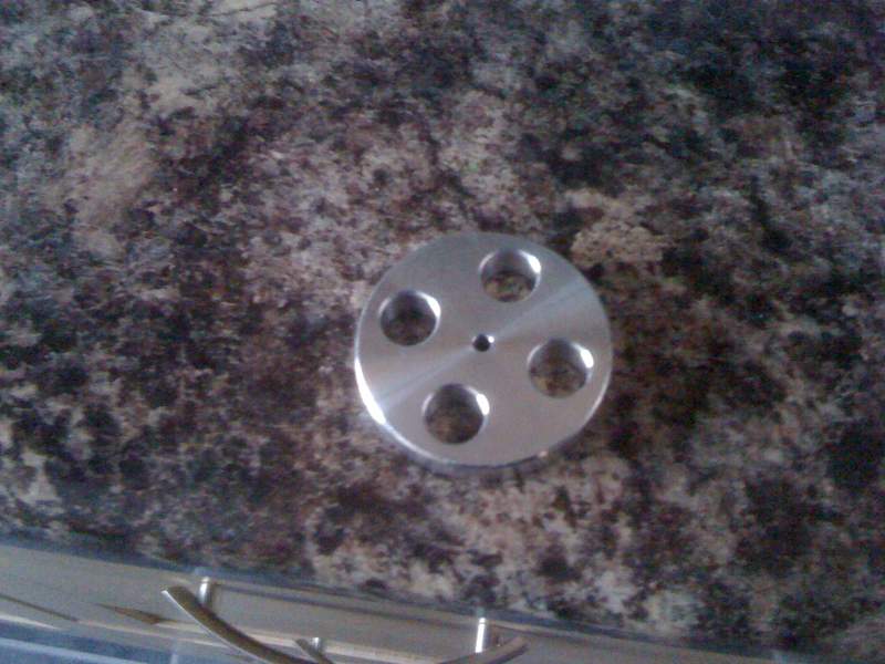

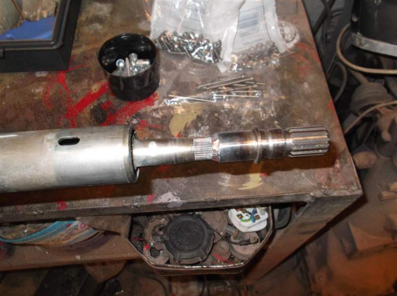

My fabricator Tig welded the quick release boss on to the steering column.
Next job is to fit the new solid coupler to the column as the Nissan rubber item is well gone!!
Thanks to Manta V8 at Bodymech for supplying this lovely light weight alloy item. It should help sharpen up the steering response.

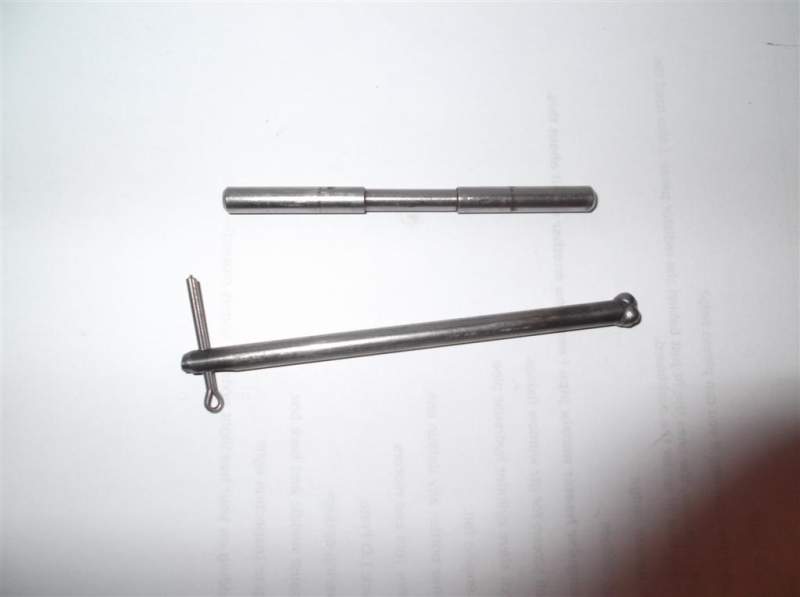

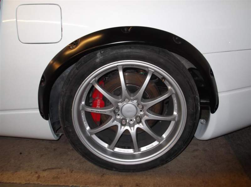

There was a "missing" brake pad pin on the rear Stoptech caliper.
This is an odd looking push in interference fit. I have ordered a repacement but Im sure with Britain in "shut sown" mode it wont appear anytime soon.
Since we want to get the rear end finished this weekend I made one today in the conventional style to do for now!:biggrin::biggrin:

[ATTACH=CONFIG]75870[/ATTACH][ATTACH=CONFIG]75871[/ATTACH]
are these things any good, heard a few good/ bad reviews.... from causing vibration, to not feeling right for a road car etc... also heard they make good improvements to feel.. so a proper view would be great as i know their fairly cheap from driftworks.

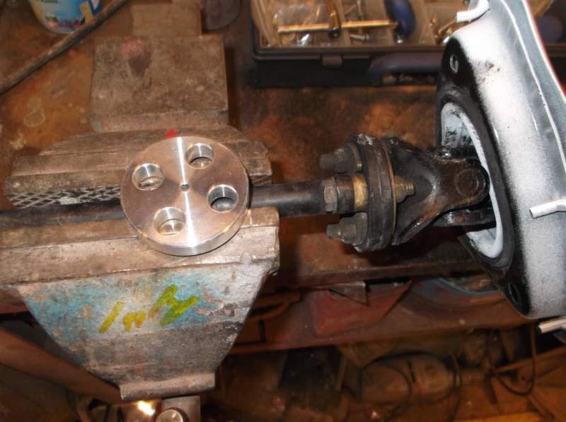

Funny you posted this I just saw something about these in the Silvia world. I can see how it would remove slop from steering input, not that it is particularly sloppy stock. It seems a straight forward swap of a bush but, is it something that you can do on a drive without too much hassle and are there any downsides for life day to day on the road like vibration or whatever?
Thanks.
well I guess we will only know when Bob drives the car.. The current Nissan rubber item is knackered so this seemed the way to go for a replacement.
Im not building a road car so an increase in harshness wont matter. The whole car is brutally harsh anyway. Removing any of Nissans cushioning bushes is going to increase vibration. The bush doesnt cause any vibration per se. It amplifies any vibration already in the system.
What I hope it will do is eliminate any play/movement in the steering and therefore give a more precise response when the steering wheel is turned.
The Driftworks one is stainless steel I believe. This is a lightweight ally one.
i will probably fit one when I swap engines too.

I fitted a solid steering coupler to my Slicktop and no vibration or other issues.
Only £17 too, I'll fit one of those one day.

As Pete says, the one we supplied is Alloy,
Just the one left but can get more if any interest..............

Based on my 240Z experience where its common practice to swap out the coupler for a Urethane one, I expect it will make a significant/noticeable difference.
Im not sure how difficult it would be with engine in either, I did mine on the bench too as I had engine out and had the column stripped already to swap the ignition lockset.
Also cant really comment on positive differences in feel as I made so many other changes to the car if feels nothing like a regular 300zx to drive anyway.

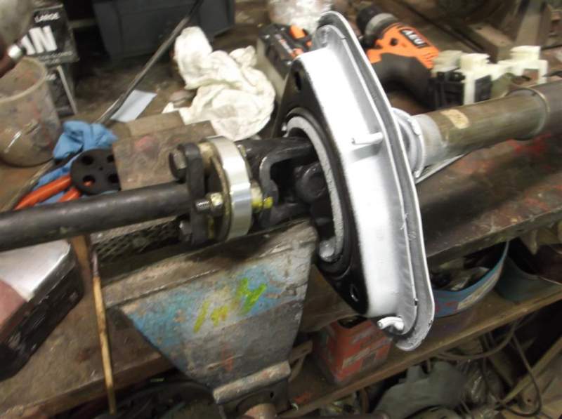

Well its been a long and busy day with Bob's car today.
We have installed the solid bush on the column. Straightforward job really. We had to be extra careful not to get the rebuilt column 180deg out as we have a non moveable steering wheel position.
This wont be an issue for anyone else tho.
As we already knew the old rubber coupler was split to bits.
This is going to make a big difference.

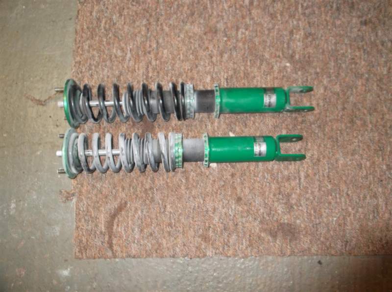

the job took longer than expected as we uncovered another suspension "issue"
The strut units on either side were around 20 mm different in length.
And just to add to the chaos one spring had no pre-load at all on it and was rattling loose while the other side had over 30ft-lbs of pre-load.
we have adjusted them equally now with a small amount of pre-load and equal tube length.
Final adjustments need to wait till the car is all back together again with engine and box in etc.
The important thing now is we have a known starting point for later adjustments. Likewise with the strut damping. They are set equally at a firmness we have noted.
Pre season testing will be the time to fine tune it.

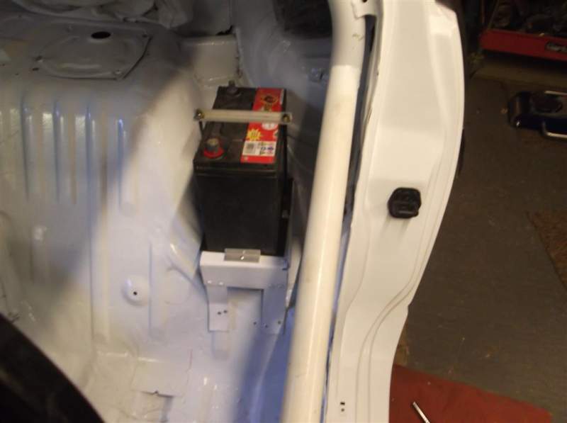

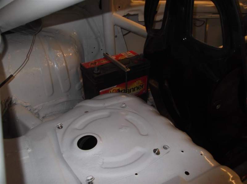

So with christmas gone I have been putting in some time in the workshop.
I cant believe how long it takes to make simple brackets and similar stuff. Even bolting in the seats is a job on its own with all the bolts hidden under the seat mounts.
The bracket to hold the brake/clutch fluid reservoir was a very shoddy item before and wasnt secure at all. I have made a new one with captive bolts so one person can install/remove it easily.
The battery now lives behind the passenger seat securely mounted on a new frame. This was wedged right at the back of the boot before with an unneccesarily long cable run.
The passenger window has all the correct bolts in it now.
I have installed a new small size washer bottle on the rear quarter behind the drivers seat.
tomorrow I plan on getting the drivers side window re installed and the new lexan windows fitted.
The steering column with its new ally spacer is back in place along with both seats and the dash roughly in place too. The new snap off steering wheel bracket works 100%.
