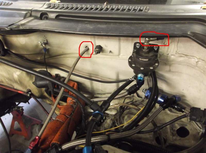

So a few pics meantime and can you spot the brake problem???
I have also highlighted some fittings that need "improving"

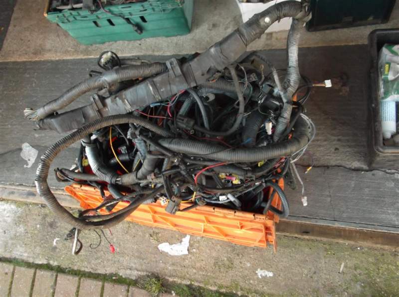

Check out the rats nest of wiring too!!

Has one of those brake lines been getting a touch toastie? Also is that a braided fuel return line posted through on a bear metal edge? Don't like that too much.
Its the NOS line!!!
It will be getting redone!!
The clutch line is scorched cos its not secured to the body.!!
Thats on the list too.

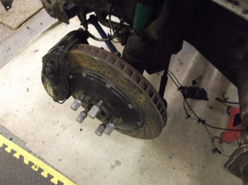

what about the brake disc picture then??????????????????

Close up of the wiring loom

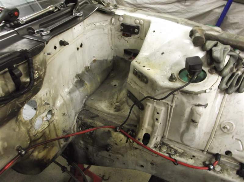

Now looking a little better with it all out
Engine bay looking a lot clearer
Haha sorry Pete just saying what I see, part of my job is walking around and going, "no that's not safe". It's hard to tell from the picture, my gut is telling me that rotor is on backwards, as heat is supposed to be vented away from the centre, however different manufactures do specify different things, so...but that's my gut reaction looking at the vanes in the disc.
Virtual drink to you!!!
Front rotors are the "wrong way" round. Heat is suppposed to be vented away from the centre indeed and the vents job is to extract it.
Strangely the rears are correct???

25kgs of wiring....................bye bye!!!

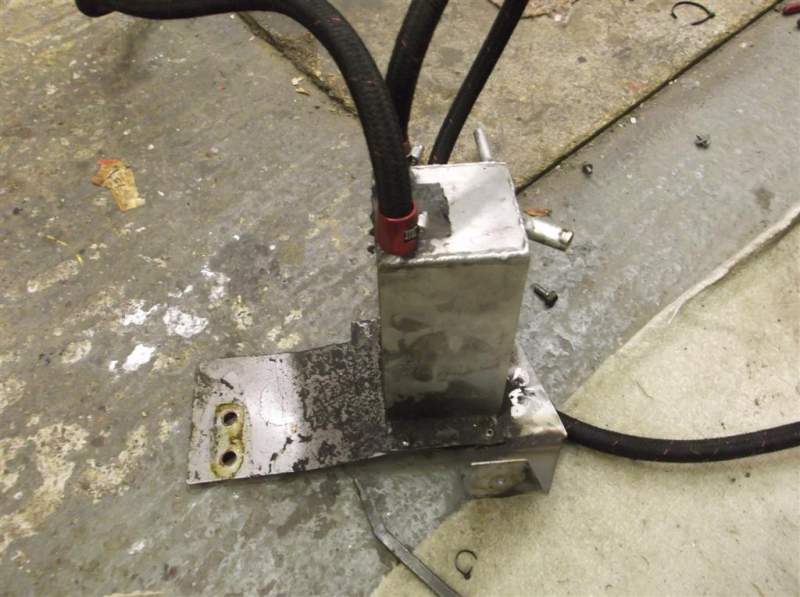

Getting rid of one of my least favorite mods done by others..............:innocent:
crudely made and installed in an inaccessable place......
