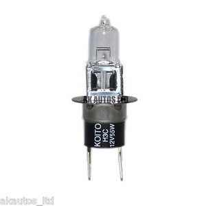

By looking online, my car as standard has H3C bulbs 55 watt ( groover , do these H3C bulbs still remove from the sockets) as i tried pulling one out and just ended up with a bulb with two broken wires,
does anyone know where i can buy H3C HID bulbs from that will fit correctly into my housing. the HID's i currently have do not fit properly so that maybe the problem with my crap vision. The picture below is what i need for my HID's to work correctly. but only available in the states or china.

When ordering HID units just search for H3 Fittment with 6k colour, ebay is full of them ranging from £15 to £40 depending on the trader and all in the UK, removing the H3C bulb can tricky especially if the alignment is set wrong, there is a wire clip that needs releasing and then the pull drops out.

The only ones i can find are the wrong carrier fittment, pretty much the same as what i have which dont fit, as my picture i posted earlier, they need to be notched, one end a half cirlce, the other a half square, cant find them anywhere apart from the USA

Hi Leeroy, you might be getting confused with which bulb goes where, but t clarify, your dipped beam H3C for Jap and H3 for UK car, main beam is H1, which has he carrier/convertor.
The HID kits: H3 will fit both models as you dont need to do an earth mod as you would if replacing with normal H3C bulb.
H3 has the notch and half circle

thats the bugger! thats what i need, for my dipped beam as its so crap and the HID kit i have obviously are wrong cos they dont fit properly which i bet is causing my bad vision from the lights. where can i buy these bulbs?? i need a pair! and it is for dipped beam, not for high beam.
You can buy just the replacement hid bulbs on ebay and use the existing ballasts as they are standard fitment, just make sure the bulb output matches the ballast capability, ie: if the ballasts have a limit of 35w, then dont buy 55w, however if you have 55w, then you could use either.

This is my problem, my dipped beam ( lower) are the bulbs i need to replace, as the stock ones are crap, so i bought a HID kit but what i done was bought a H1 kit by mistake, so all i need is a set of H3C bulbs along with the plug part so i can just plug them in, the thing is the only place i can find these are on ebay either usa or china, surely theres somewhere i can buy them in the UK?

You dont need H3C if you are going for HID, so get that out of your head now :biggrin: H3 as Jeff posted and you are sorted :thumbup:
