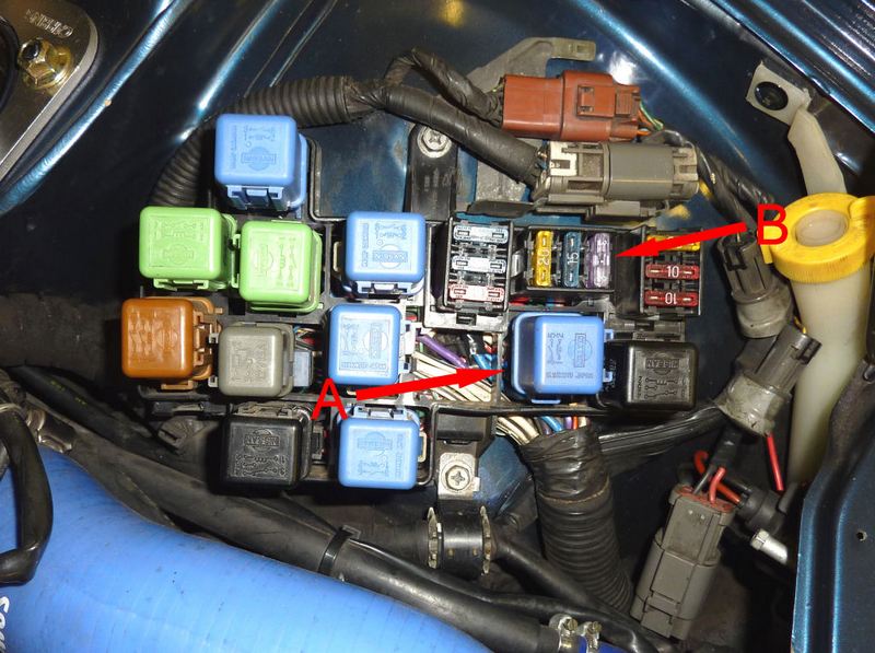

It's so that when you switch from dipped to full beam, the HIDs in the dipped beam stay on. You can do the simple "earth" modification; but that will make the full and dipped come on together each time you flash your headlights - whereas with the "diode" mod, the flash operation only works the main beam.
It's to prevent premature bulb failure in the HIDs - as they do not like being flashed on and off too much:wink:

I just opted for the easy earth mod for mine, couldn't be bothered with relays etc, and I flash people with my fog lights. just occurred to me though my fog lights will be going soon....
