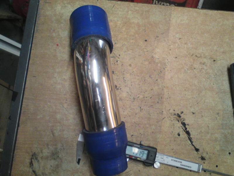

Next pic are the aftermarket pipes, which I am soon to fit (just waiting on clamps !!), with the caliper these measure approx 72mm outer diameter, so therefore these still require 68 - 73 clamps x 3 each, but the reduced part measures 62mm, so require the 59 - 63mm clamps. The aftermarket outer pipes - not pictured, are 62mm across so require the same clamps as the pic above, so that's the 59 - 63mm ones.
