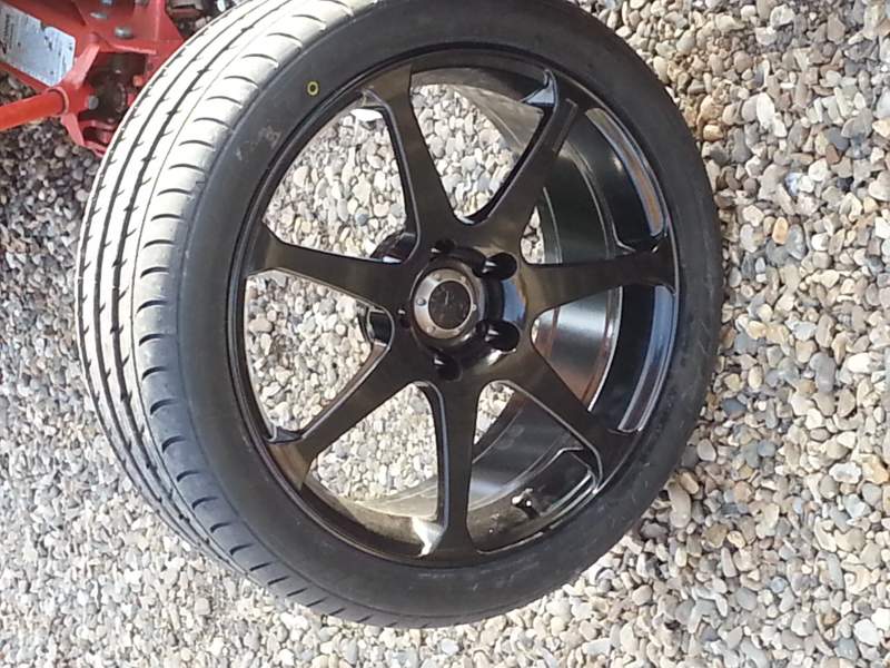

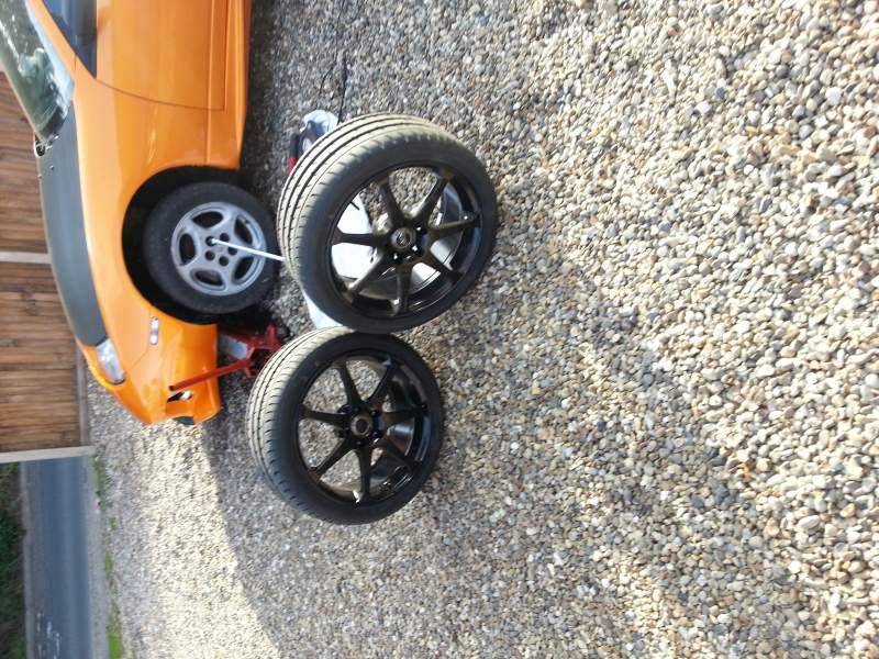

dont know just know there 18 and i measured the rears 10 inch across. ive put 235 on the front 9 inch and they look ok i was or maybe still put 265 on the rear but im thinking prob 275 cas there cheaper and will prob fit.
It's ESSENTIAL you know the offset; even with skinny tyres, they may not fit. It'll be stamped on the hub facing surface or on the inside of a spoke. It'll likely have 'ET' written before it.
All round? Not a staggered fitment? 8J for the rear is narrower than stock UK rear wheels.
Which means 365 or 275 or both
Huh? Where did you get those from? 8j wheel would normallu take a 215-225
Well i used to have on them running 235 40 18 on the 9 inch front and 265 35 18 running on the 10 inch rear and car seemed to like that set up and from what i remember was a comfortable ride with no tramming or anything so might do that again oh and i think it said made in china or more lickly japan. Look nice thou.
