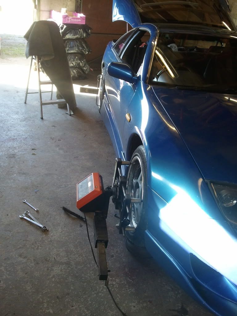

i ended up splitting the difference and having 1mm toe in on the front, and 2mm toe in on the rear. at least it pulls straight with the wheel centred now. took about an hour for me to do it. spent some time cleaning up the threads for the track rods
