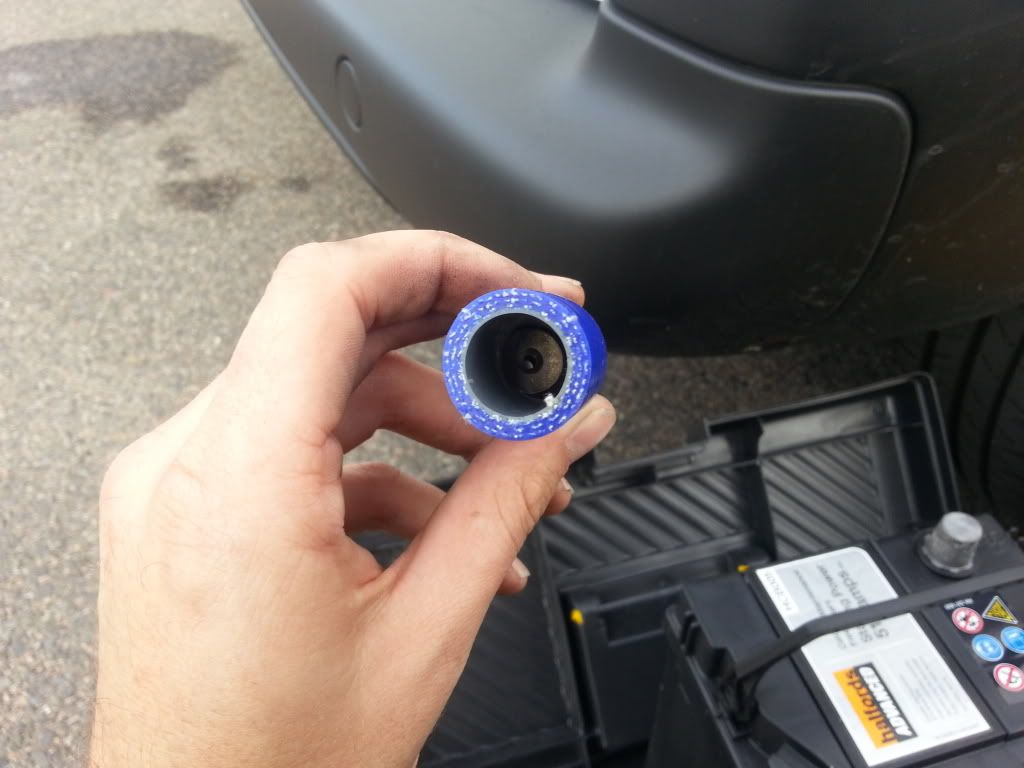

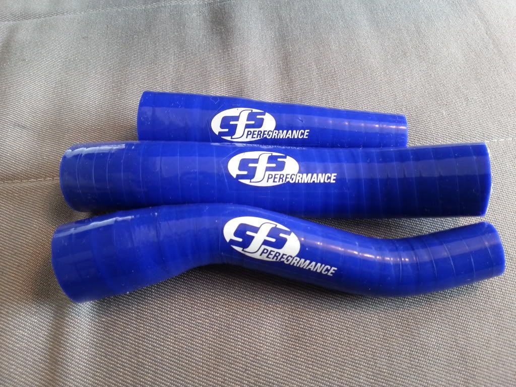

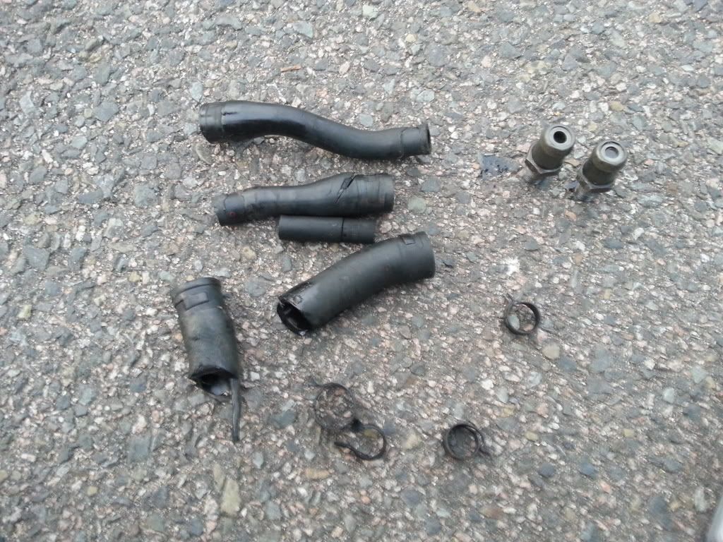

Both pcvs done with all 3 sfs hoses fitted.
As you look at the engine the drivers side pcv was stuck.
Had to shake it like fook to get it to come unstuck!
So that should be correct... If drivers side pcv was stuck and passenger turbo was smoking on the overrun then that's spot on.
I did double check all old hoses as Terry said there is a breather.
I found it on the rear pipe of passenger side hose, took it out and put it in the sfs hose (picture below).
The picture at the bottom.... Note the right hand pcv... that's the drivers side.
