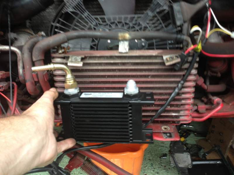

Is this to small?
Right you know how it is you buy stuff for the Zed, and forget you had it stashed away in the garage yes?
Well I suddenly remembered that I had bought an uprated oil cooler for my car from DTA, yes thats how long ago I've had it, circa 2 years.
Seeing as the car is going off to Jimmer soon for its engine swao I thought I'd quickly throw it on the car, whilst doing all the other jobs I have to do.
Anyways the cooler is a Setrab 13 row (50-113-7612) and as you can see form the pic is a bit small, :thumbdown:
Before I go and order another one from CZP is it defiantley a no go?
I can't believe Danny sold this as an upgrade for the Z32 maybe its for a non turbo?
Thoughts gents. If anyone has a use for it, it may be in the for sale section soon
I would doubt that Dan would have sold that as an uprated oil cooler. Looks more like an autobox fluid cooler, which would be an upgrade to the one built into the rad?
Can't see the point of fitting that bud. Just my thoughts...
It's quite probably for the autobox. As they dont really have a proper cooler, so that is a mass upgrade. I'd say that's too small for an engine oil cooler. It's dinky lol.
Yes Dan was always spot on with everything he ever sold to me, guess I must have cocked up somehow :oops: looks like it will be on ebay soon.

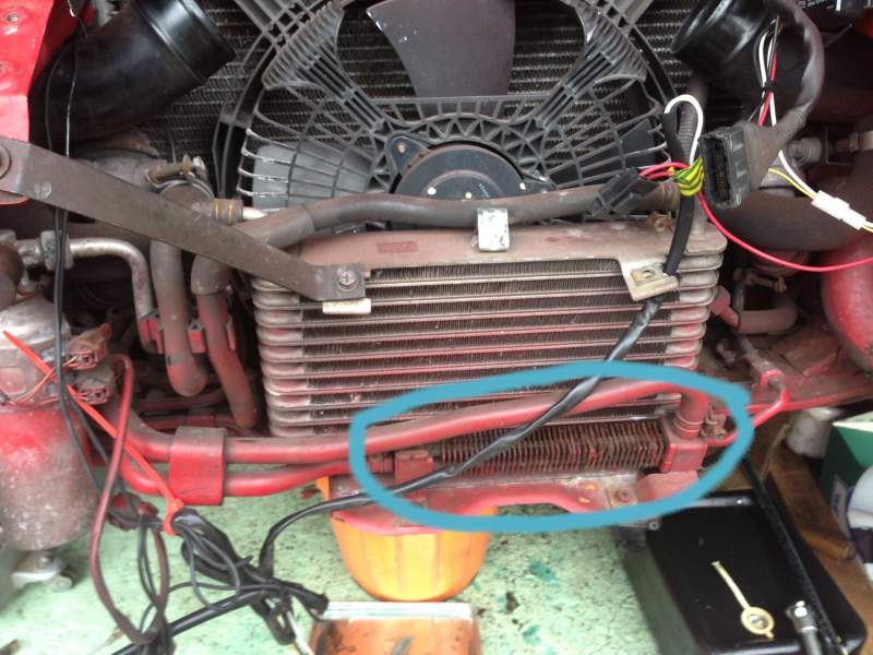

Could I use it replace the power steering/hicas cooler in front the oil cooler? As my OEM is shot
[ATTACH=CONFIG]73519[/ATTACH]
Not an expert on this, but I can't see why not.
