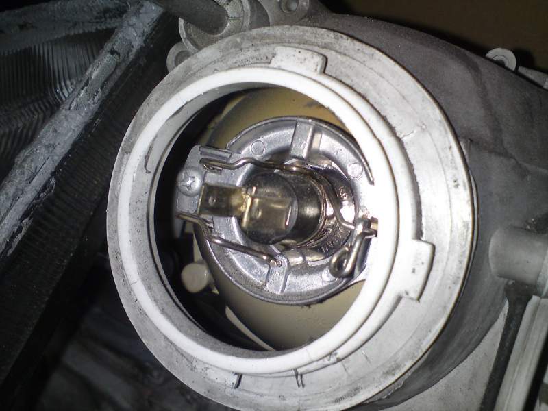

So in both my projectors I can only assume that previous owner has had trouble with getting the h3c bulbs as I found what looks like a h4 twin element bulb but completely massacred and wedged in to fit h3c fitment...
Both filament positives had been soldered together and then a ground soldered to the base??
Needless to say, it doesn't work..
I have since bought myself a set of 55w 6k h3 HID's, only to now realise once I'm standing in front of it trying to work out how the HID's fit, that I have no bloody spring clips...
I'm sure I can just rob a pair off of another h3 car, or fashion my own from something..

Do I have to remove the whole assembly to fit a new set of spring clips??
Anybody got photos of how the spring clip is to fit the assembly?

You will find it very difficult to work in this area with the lights in situ, you need them on the bench really.
The spring clip at the left hand side on this pic is stopped from falling out because that screw is there, there is a screw at each side and the alignment adjusters need moving to gain access to these one at a time.

Thanks very much for the pics, links and explanations they have opened my eyes to the situation, there is indeed no easy way other than unit removal, sigh..
I have this Sunday free for a little while so will make a start then!
I've got a couple of bits of stiff wire laying around, so I'll have a crack at making my own for now
