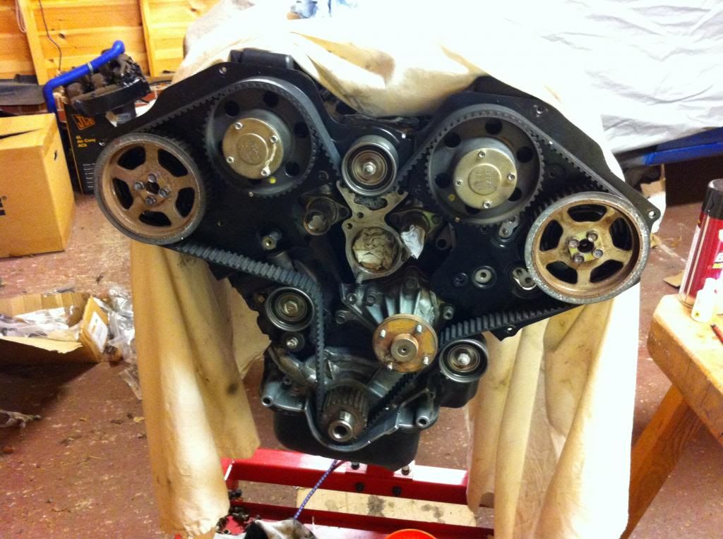

Its leaking from the thermostat housing. I thought I was the water pump to start but after a closer look can see its from above the water pump.
