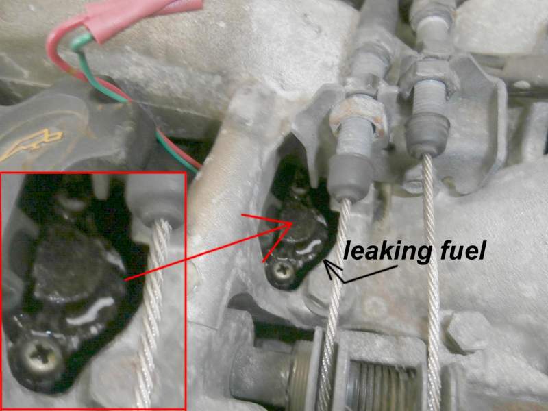

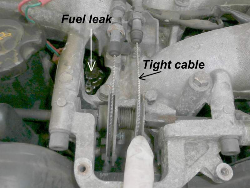

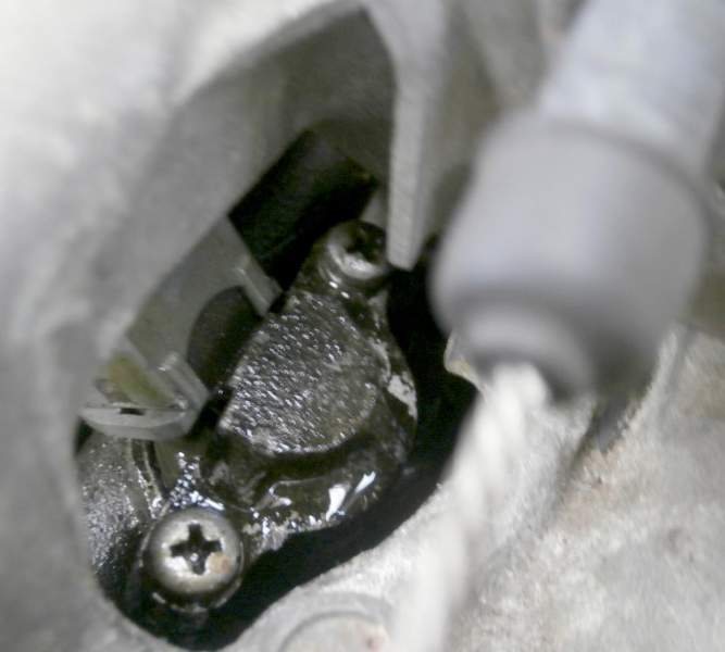

With the throttle cover removed the fuel smell source was revealed.....No 1 injector was spraying fuel sideways out in to the centre of the engine, this continued even with the engine not running!!
So knowing the injector had been replaced recently it was clear the "O" ring was having some kind of an issue keeping the fuel rail pressure under control and was going to need removal.
The accelerator cable and bracket need to be removed and at this point it was clear the cable was too tight and was holding the throttles open slightly, remember the odd tps setting from earlier??

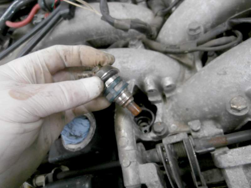

So with the pressure released and the bits out of the way the injector was removed, fortunately this one is accessible with out any dremell work.

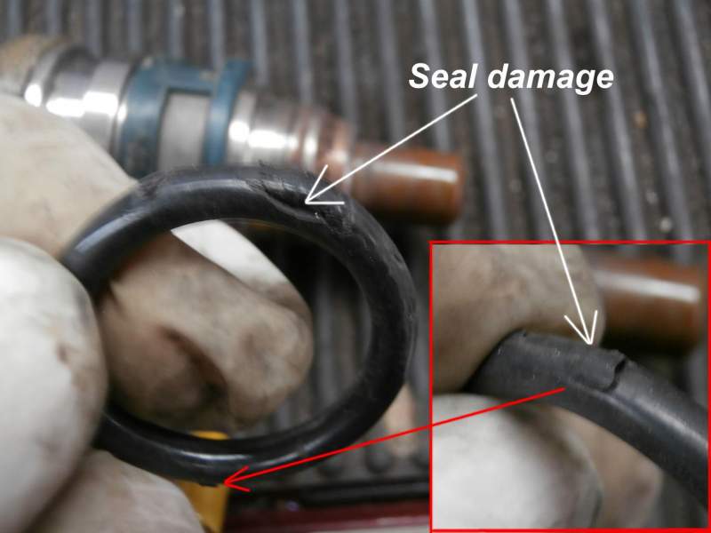

So with the injector out the seal could be checked and the damage to it was clear...

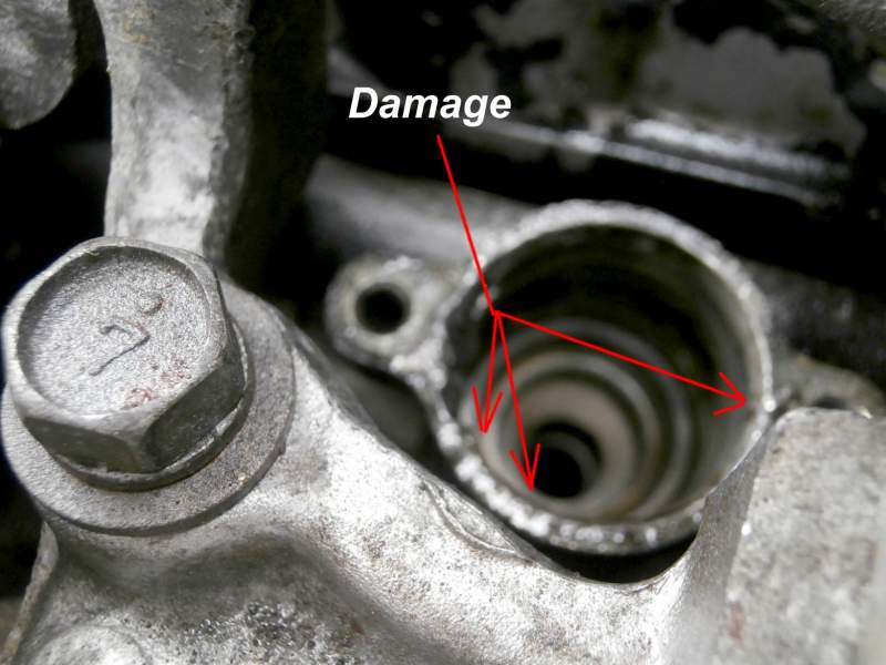

Now the seal looked to be new but damaged so at first it appears it was badly fitted previously, however a further look into the fuel rail revealed the damage to the section the seal sits in!
Lucky a little work with a needle file got rid of the high sharp spots, this must of been caused by what looks like screw driver marks?? the seal never stood a chance!!

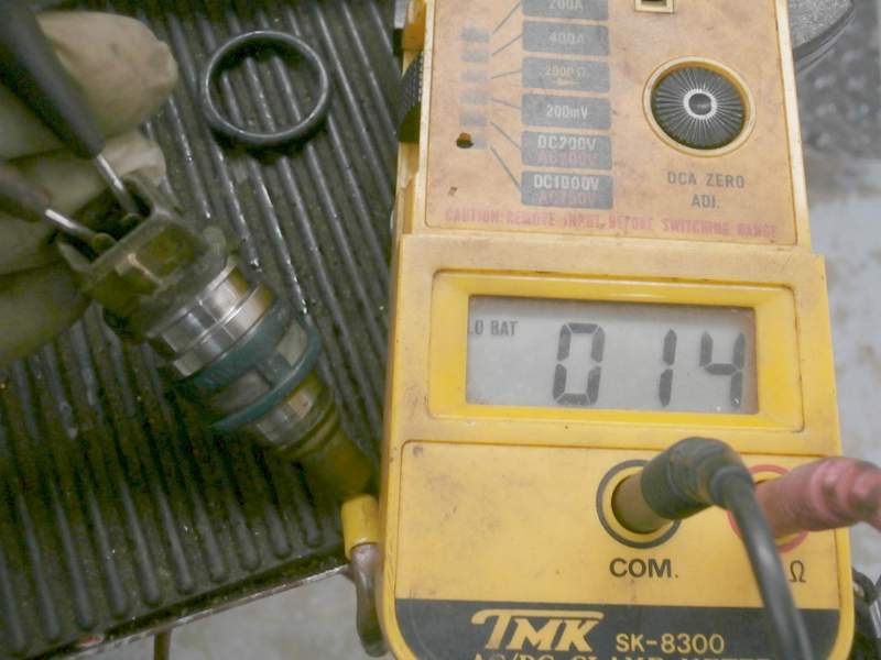

So now before fitting any injector always check its electrical integrity first, as sometime they can pop off for no reason..

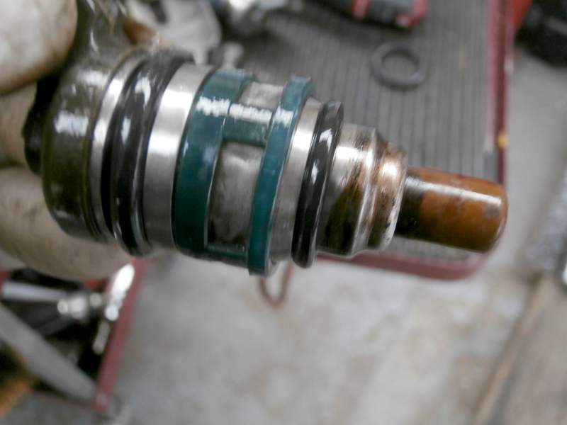

So all good and the injector seals all lubed up and ready to fit...

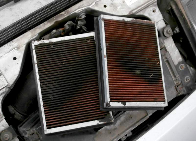

The fuel was now all kept where it should be and ready to be checked over again but not before the filthy filters were replaced..
