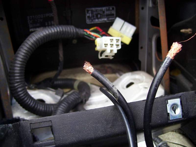

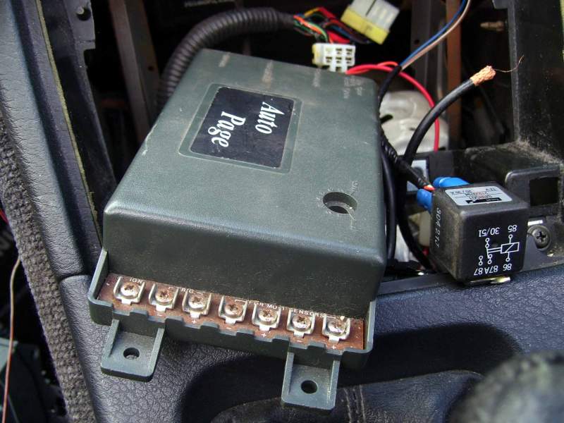

Something that I have been meaning to do for some time now, is remove a redundant pager that had been spliced into my alarm system.
It had also been spiced into my audio antena.
Can anyone advise me as to if there are male to female connectors available please?
I do not want to splice back together as previously.
Hope someone can help.

You'll see the correct size mate. One is standard ariel size and the other is smaller, for sky boxes etc. Judging by your pic I'd say you need the satellite sky box size.
Yep, Theres not a lot between them, the larger is for RG59/RG6 cable the other for Ct100 sat cable, you could use either but it will be tighter or too easy to put on. At a guess looking at the core you have the larger cable size, so even if you buy the smaller size it will fit albeit tight.
Measure the o/d and let me know I will find out the type you need.
The cables in the picture are of the original cable fitted to a UK model.
I think I will check my SKY cable tomorrow for a comparison.

Hi SteveE, looks like I spoke too soon! The sky connectors seem to be too big, I had too wrap tape around outer cable just to get the threaded connector to bite. Worst still, the inner wire is so small in diameter that it does not touch the inner bore. If I jiggle it around it intermittently makes the odd connection.
Any ideas mate?
Do you know the cable size inner and outer core?. I should have some smaller F-type connectors I can send you, or you may have to go the BNC connection route but you need a crimping tool for a tight fit!! you also could probably get away with soldering the cables using m/f RCA Video connectors.

I had one last attempt last night, (nearly running out of cable! lol) managed to get a good connection by doubling up the inner core by folding it over. seems to have done the trick for now. (fingers crossed) That said, I really do appreciate the offers of help and advise though guy's.
