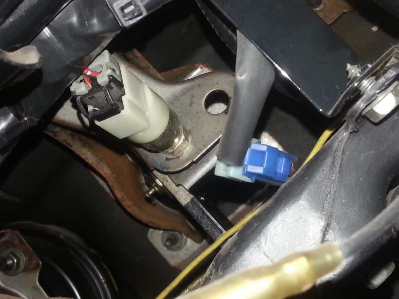

[ATTACH=CONFIG]72433[/ATTACH]
It would appear (although I could be wrong) that this little thing when It was whole, fixed on the bracket on the break pedal and poked through a whole to push the switch in (N/C contact) for the lights, however as mine broke the switch was extended (closed) all the time leaving the lights on.
I'm not proud of it, but I have bodged it, using a small headed screw I had lying around I've managed to get it through the hole on the bracket, secured of course. and it now appears to work. I could of done a better job but it's a god awful position to be in, and to have to keep pushing the pedal made it awkward and I wasn't prepared to take it off.

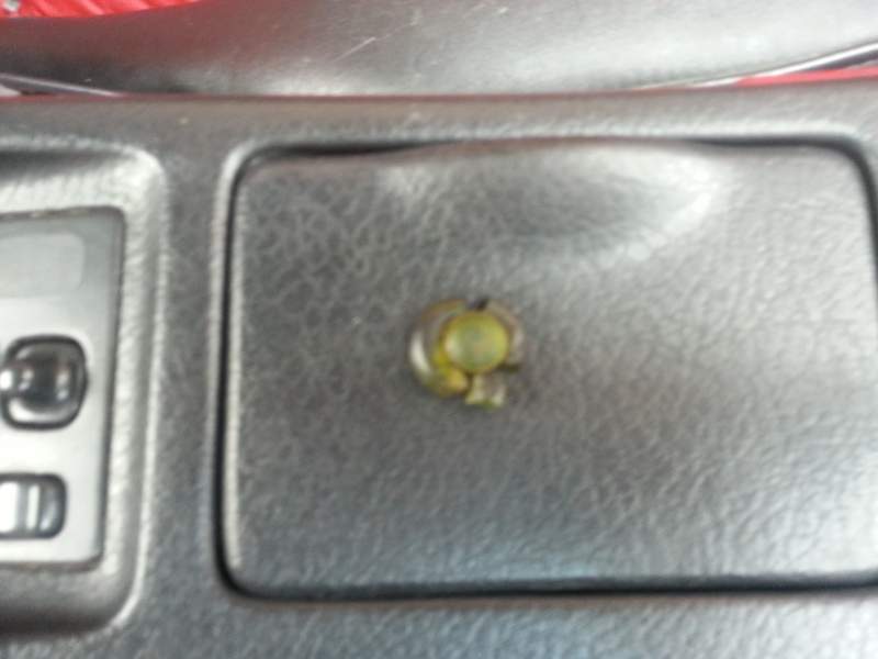

Here's a photo of the back end of the switch to try and give an idea.

I've solved it, turns out the fruit polo had more to do with it than was thought.
