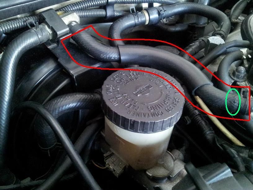

....I have a split and for the life of me, don't know what this hose does and don't know what's it called as I've never had to take it off, so never paid attention to it. Well, the darn thing has a slight split in it and I wanna replace it.
What the hell is it? Assume it's something to do with the brake servo? I can't find it on Courtesy Z or in the manual.
That's will be your clutch booster mate, there are silicon replacements available now
Righty ho...that obvious! I feel so stupid. I should have known....but I've never had to deal with it!!
Cheers! :)
Correct, had to nip out to the car to check lol, this might help though
30664 on the image above. it goes to the vacuum tank gubbings for the clutch booster. (above image is for a LHD model, but its the same layout but reversed.)

I would check your brake fluid level too lol, looks a little low
It's funny lighting. Fluid is half way between Min and Max...or rather just a little over. Cheers though. :)
