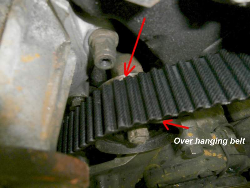

So once stripped down it seems the belt was not that old looking, however it was very oily from the cam end seals as I expected, however the run of the belt was not to good especially over the lower right hand pulley, closer inspection shows the pulley had been replaced by pressing a new one, however it was on too far and the belt had been running over the pulley by 4 mm or so......not nice.

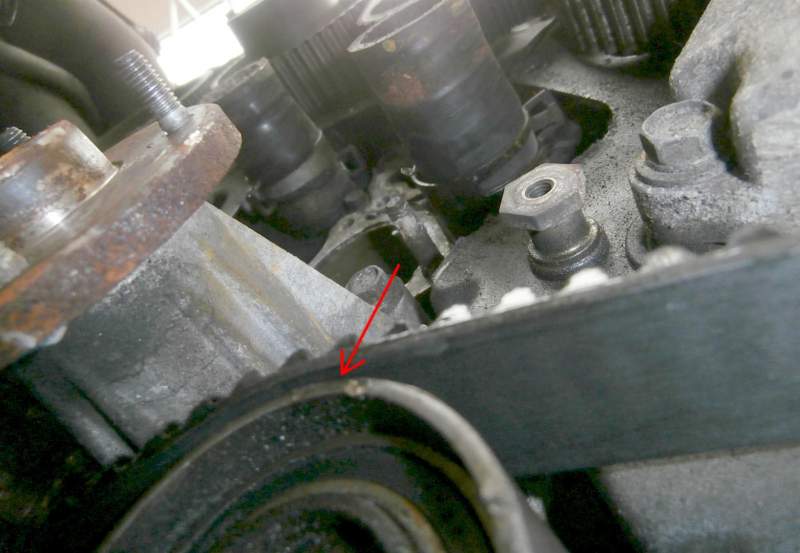

You can see witness marks on the pulley leading edge where the bearing has been changed over on the adapter without the correct tools.

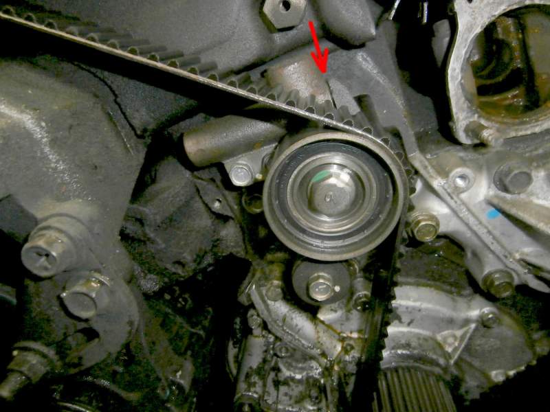

So moving on, a nice clean (new? ) belt tensioner was in place but set completely incorrect, a similar case last week was highlighted for the same reason, little point of setting it in the closed position??

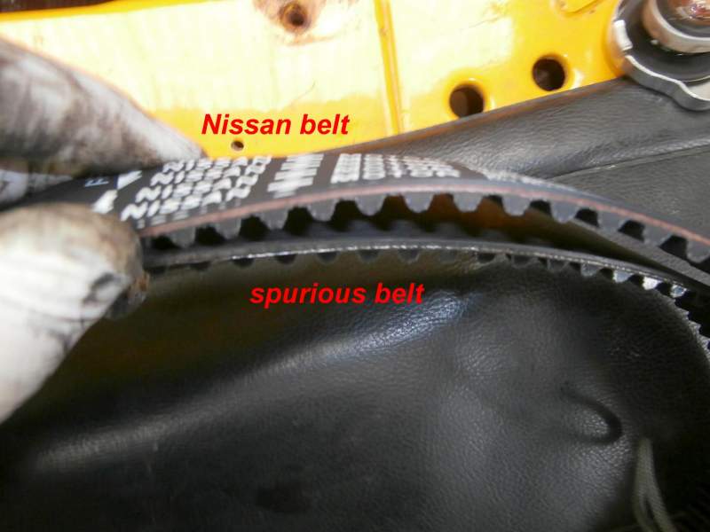

So onto the belt itself, if there are still any doubters out there ( sincerely hope not ) the argument for my campaign against non genuine belts is clearly highlighted by this unbranded item, when compared to the genuine Nissan item the belt quality and structure is much superior on the genuine one, given the belt lacked any timing marks I made a tooth count and compared the two belts and although only slight the difference was significant over the 5 timing marks it was enough to be of concern, maybe why the cas unit is so far over?

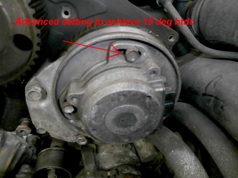

On the last picture where you have got advanced setting to achieve 15°. Is that meaning its advanced further than it should be?
Yes the cas unit position shown is how it came in, assuming this had been set at a strobe light tested 15 deg btdc then it is not in the middle of the adjustment slots, and appears to be in a + position ie advanced, one warning though sometimes cas units can be less acurate than we would like and on occasions even with a belt installed correctly the center position is not always possible, however this is more likely with a non genuine belt, or of course an incorrectly fitted belt.
