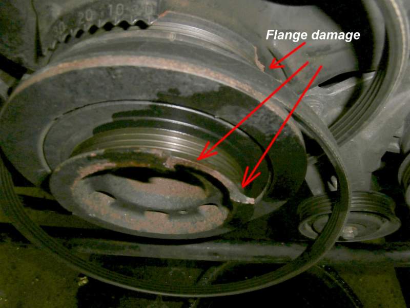

Whilst doing a second cambelt change yesterday I cam across one of the worse bottom pulleys I have seen in a long time, not only was the back section damaged where a previous attempt by someone to remove it wit a hammer but a large section was missing from the front flange, a badly fitted/ used puller seems to have shatters the section clean off!!

Of course fitting a good used one sorted it, just bad practice really and feels wrong it spinning around at 5k with a lopsided front...not good.

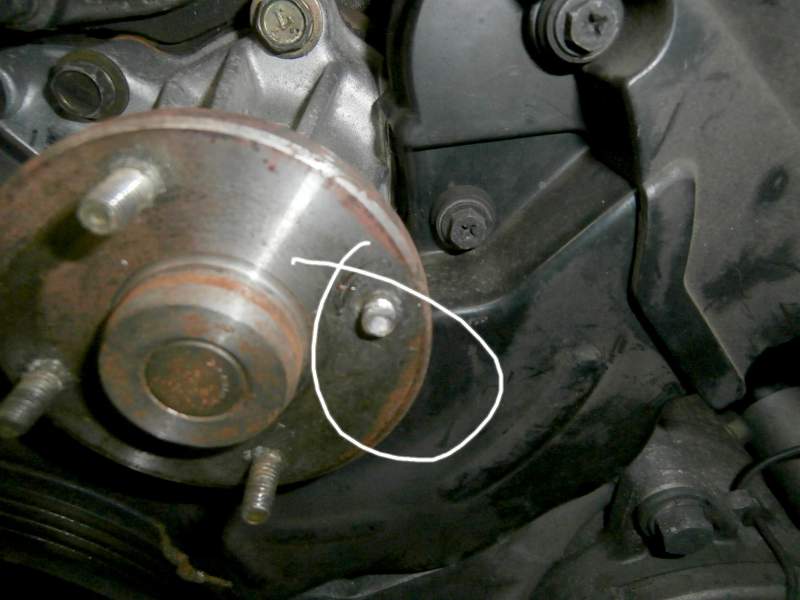

To top it the water pump had a sheared bolt and the loom to the cas unit was unclipped and ready to catch in the fan blade.....
