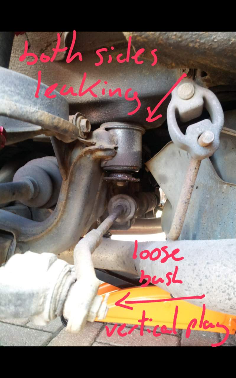

I can't drive my car because the back wheels catch the arches and the brakes judder the entire car violently.
I have raised the rear using my miester rs but clearly it wasn't enough and I'm not prepared to stiffen it further. While I was under there both back sides have collapsed bearings. I don't know quite which but they are apple sized and wet with grease beneath just forward of the hubs.

I know you are trying to tell us as best you can but there are some oddities in the whole scenario.
Wheels catching arches.... What offset/size/tyre etc are you running. This might or might not be related to other issues.
Juddering under braking??? Not always the brakes that cause this.
Rear bearings??? Do you mean the subframe bushes??? Your description suggests this?

I don't know which bushes are gone I hoped it was a distinctive failure.
I was wondering about the bushes being subframe because they don't look like any of the aftermarket parts they look too big. As I say perhaps 2in tall 3in across cylindrical black rubber with a metal outer wet on the bottom with a sludgey grease.

Better to diagnose the real faults first before buying anything. A picture would be helpful.

This is what I should have done first time round rather than try and remember from miles away from the car.
Looking at the play on the hicas arm it's only slack up and down so I don't think it's gona make the back end too vague. Obviously I will still fix it asap.
Subframe bushes are the big ones you are pointing at leaking.
Get rid of the hicas and get a lockout kit fitted regardless of any play.
At the front I would hazard a guess at your tension rod bushes being shot which would cause issues under braking and cause a snaking feeling...chances are al your bushes are probably pretty worn and could do with replacement with standard or polybushes - decide if you are going to use any aftermarket arms though as this will reduce the number of bushes required.
Thanks misty, what is the impact of the leaking subframe bushes?
Subframe will move under load.. ie when driving braking cornering. So needs fixing before any other issues
It will be adding to you wheel catching issues maybe and also the shuddering under braking. Im with Misty blue on his guess that your front tension rods are fckd like your subframe ones. They are the same type of bush.
Pics are worth hundreds of words!!!!!
It makes the job of trying to help soooooo much easier
Bouncy rear end, a new set will firm things up no end regardless of wheather you go with rubber or poly for replacements.That along with your tension rods and a hicas lock out kit and it should handle as intended. If you start putting aftermarket arms on then you'll get the bug and end up spending a fortune...but it does look luuurvly :laugh:
