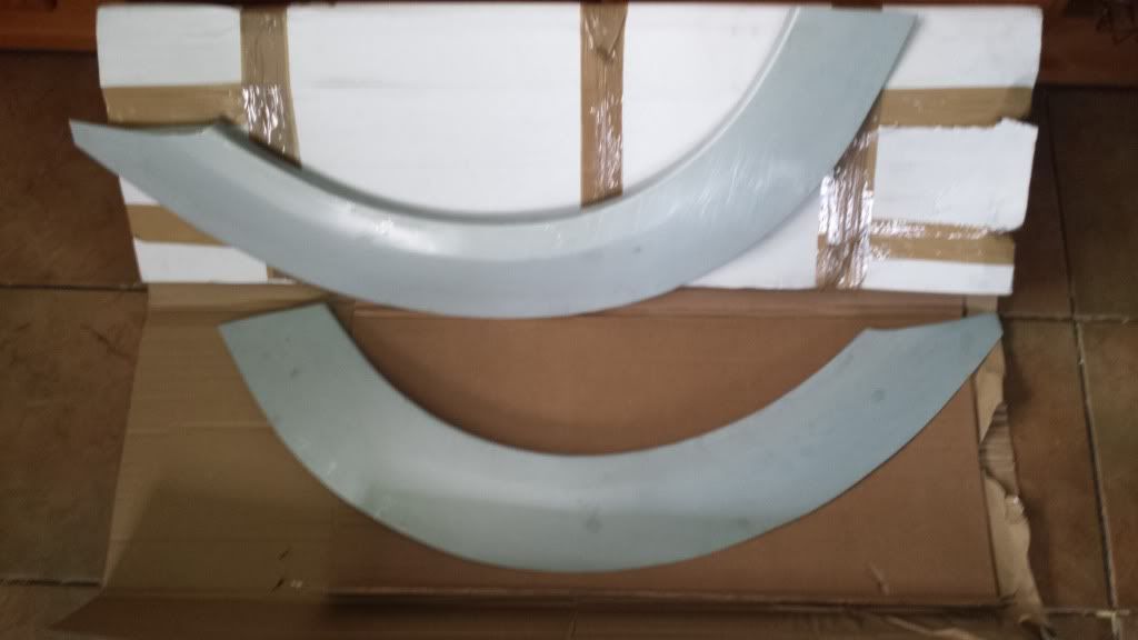

Rich try this link off the forum a guy on ebay does sills and arches heres the link
http://www.300zx.co.uk/forums/showthread.php?170324-Where-can-I-get-outer-sills-for-a-2-2-from&highlight=rear+arches
I paid 120 for them delivered, even 50 delivered got to be worth that....
