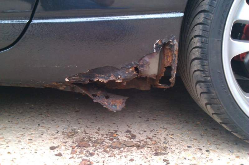

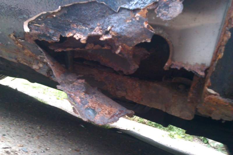

Just got back from the body shop with a couple of photos of how bad the rear of the sills are, he's started on the worst one first so let's let the photos do the talking.
Obviously not very good!

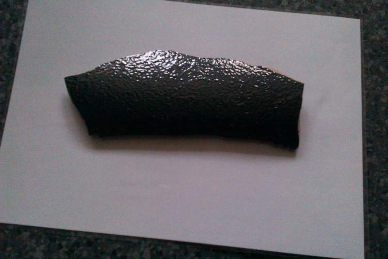

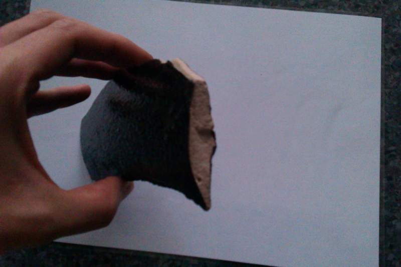

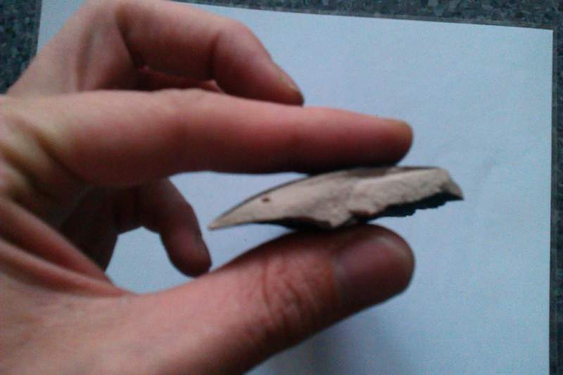

Before he got to what you see above, he found what's in the photo's below...
Now that is one hell of a lump of filler!
Why don't people do a job properly in the first place?
Who ever did it went to alot of effort to hide the fact it was there!
And all this is because of the bloody targa drains, thanks Mr Nissan for such a stupid design!
