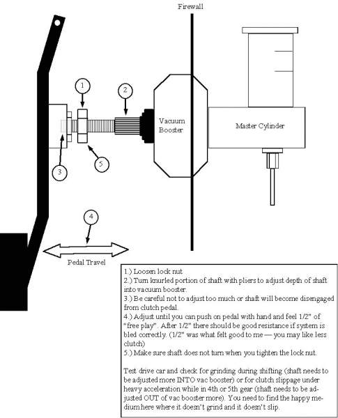

The procedure is best done by laying on your back with your head placed just below the clutch pedal (so yeah, a good idea to shake the crud off those floor mats prior to this drill). With light in hand, look towards top of clutch pedal. There is a clevis with a rod (pointing towards front of car) and jamb nut attached. Loosen the jamb nut (14mm). See below for which way to rotate adjusting rod. Note that rod rotation direction is when viewed from the DRIVERS SEAT perspective.
BEHAVIOR: Engages too close to floor, may grind when putting into 1st or reverse.
REMEDY: rotate rod clockwise (rod is unscrewed from clevis making it longer).
BEHAVIOR: Engages too far away from floor, slipping may also be present.
REMEDY: rotate rod counter clockwise (rod is screwed into clevis making it shorter).
Working room is quite tight and a pair of long needle nose pliers work nicely for rotating the rod. A little rotation goes a long way so don't rotate more than several revolutions between test drives. If things are getting worse you are probably rotating the rod in the wrong direction. It is sometimes difficult to see if the rod is even turning since you can rotate it only about 1/10 revolution at a time (due to aforementioned tight working quarters). Take a thick tip felt pen and place a few marks on the shaft to help monitor rotation progress. And don't forget to tighten the jamb nut when through.
