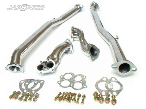

i have this
and im looking to get this in the future
are these a simple replace with old ones? or is there another kind out there? i currently have a vielside exhaust and not sure if it will fit. or am i better off getting the whole thing replaced.

The the decat pipes japspeed?

Actually, I'm thinking they look like the 2fast2cool ones from eBay?

Should be straight bolt on as long as you get the elbows with it as in the picture, no good without them.
And I'm pretty sure 2fast2cool on ebay are supplying Japspeed ones, they just take the chance and start 99p auctions with them...and then end auction early if it doesn't reach the price they want.

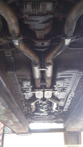

looks like your aiv pipes are still on all conected these will need a bung in think its a arch linner off job cant really remember .I went for the na front pipes complete with the cherry bomb style silencers for a few reasons .1 didnt fancey snaping dump pipe studs and trying to drill bolts out for hours
2 thought the silencers would keep noise down after cats were removed
3 thought the extra back pressure of the silencers would hold the turbo seals better

no its not from 2fast2cool its someone else whos breaking their car. the listing did say they are japspeed. and it looks like it to
thats the one on japspeed. looks the same.
taff, aiv pipes?
Air injection valves they will need plugging both sides it's an emission thing .

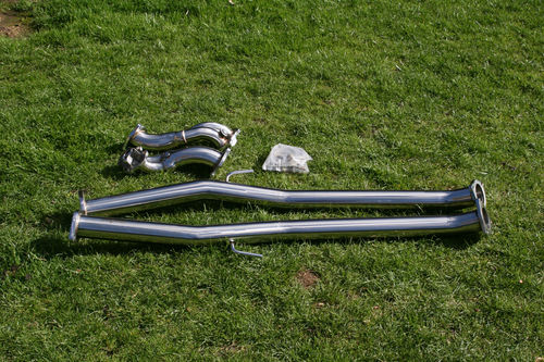

Would that one fit?
Mine has stupid greddy turbos and the exhaust side is only 3 bolt (triangle) so I have to keep the elbows as all the downpipes I see have the usual 5 bolt pattern. Pita really.

bird - i would expect so, providing the elbows on the greddy turbo finish in the same place as the stock ones.
