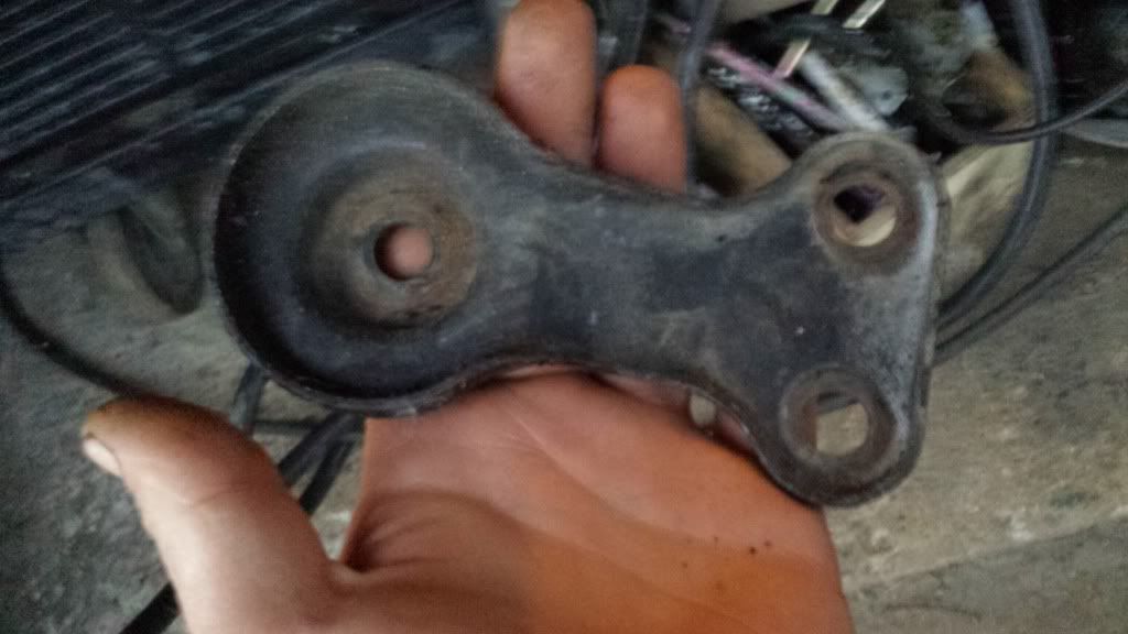

Can you identify this part?
Just wondering, what is this part? marked blue
Probably something simple, im just not under my zed right now! :rofl:
its a Sub fame to chassis support .. and yes its needed as if you dont have it u will not be supporting the Rubber bushing with in the sub frame correctly and it could pull down under high/shock loads
wow, you are fast. have a bag of rap that man!
is it the same part NA and TT?
edit: rep not rap. or both?
What this part...
it holds the subframe on, 2 bolts in body and 1 bolt where the subframe slides on.
if u need them probably got some spare u can have for free...
is it on all four bushings or just the front two?
Im bowled over by the swiftness of the replies by the way guys!!!
Thanks Terry, i will check and let you know bud.
you should have those 2 bracket-cups on the front 2 bushings and then two round cups for the 2 back ones

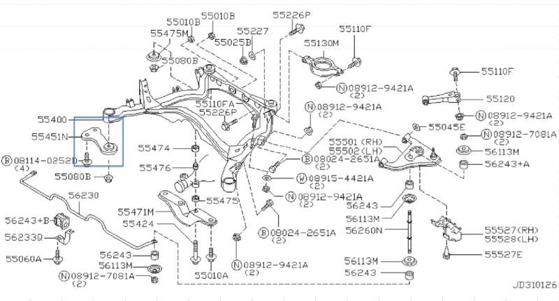

OK next question,
Which of this merry lot (marked blue) is the bushing? (i.e. the one that gets replaced by PU). I'm assuming the nut is captive in the subframe?
And what is this fella holding on (bolt marked red)???
55474 55475 is the bushing 55475 is the bushing anti squish washer/tube
if your rebuilding get the uprated polly ones
Ok so i dont need any of that, got the PU ones.
Any clue on that mystery bolt?
Ok won't be needing that boy then!

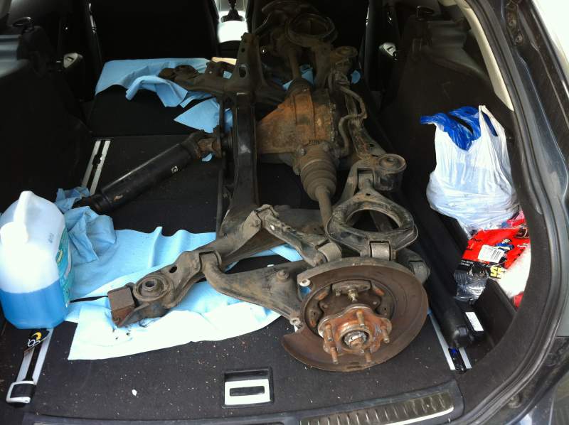

Sneaky 'before' pic below, for some work that is currently happening :shifty::shifty::shifty:
Yes... :confused: The frame is also off a SWB, but im not sure there is a difference?
Nice .. so you doing NA conversion then ...
dont u have an SWB ?
