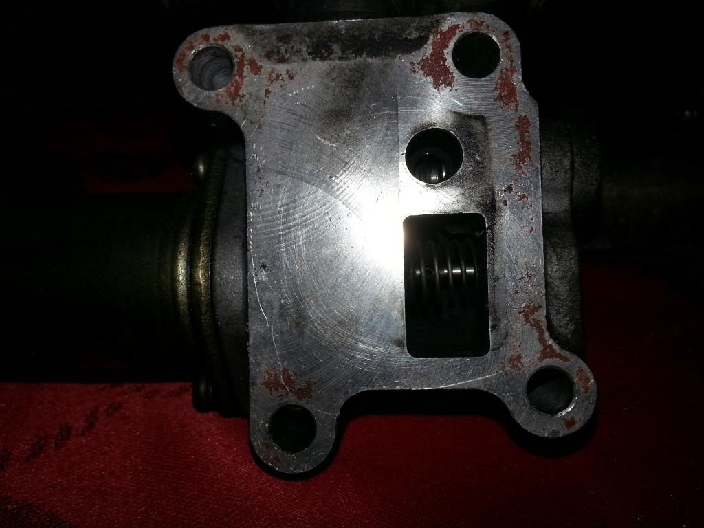

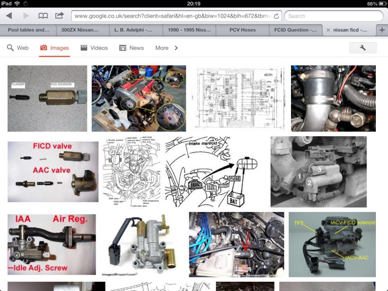

The FICD might be different too. When I took mine off I dropped the plunger out, there was no spring in it so I thought I must have lost it. But just found this picture. You should take yours apart (left one) and see if it has a spring in it
Membership No 0780
INSURANCE GOOFA
Mine is as the one on the right.
Once I had cleaned it and refitted, I could get my AAC reading to between 15% and 25% when hooked up to Data Scan.
I could even fine tune the base idle so as to hit mid limit, 20%
As Rolandas says, might not be an OEM one on the left.
you don`t need to take it apart to see the spring :)
Not that spring mate. The one in the FICD (hexagon shaped bit with grey connector on the end)

Im hoping rolandas takes his apart as I'm curious now whether I've lost a spring or if that ficd didn't have one
Membership No 0780
INSURANCE GOOFA
Yeah, the aftermarket one reads pretty much spot on the same as the normal one when on data scan etc.
i will take it apart for you tomorrow
Brilliant. The FICD will just screw out but mine was on pretty tight so you might need a big spanner or something

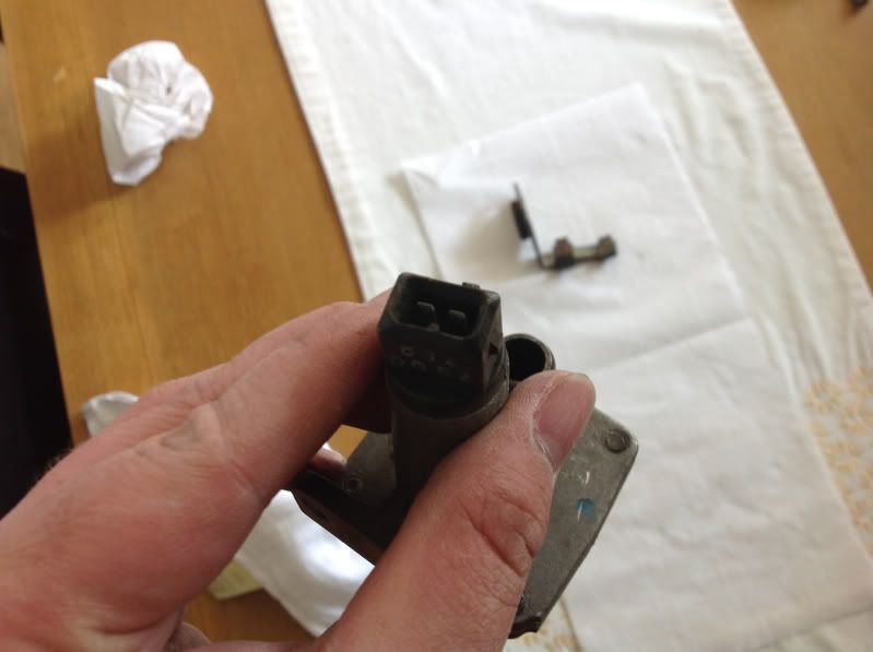

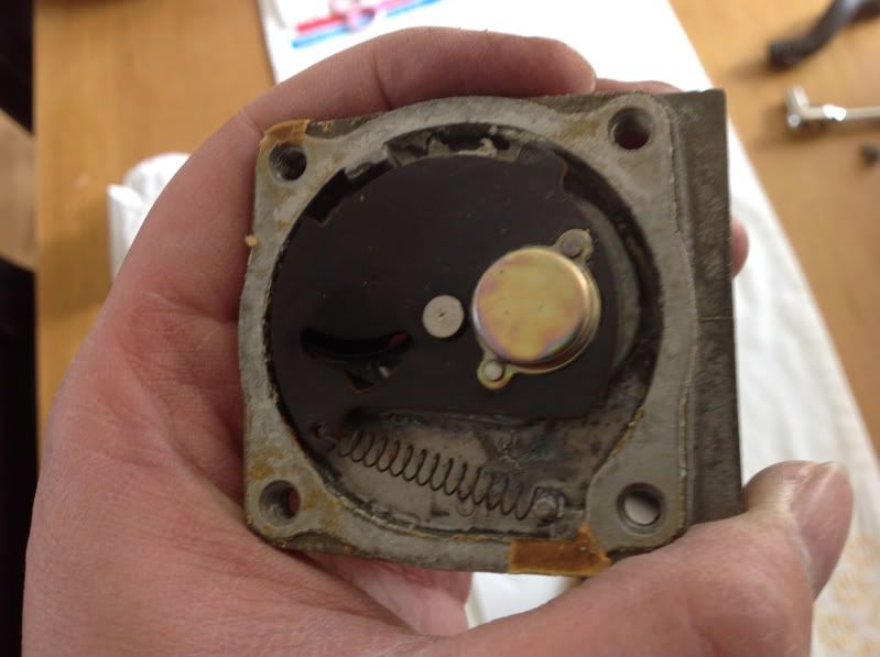

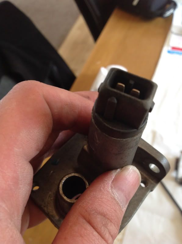

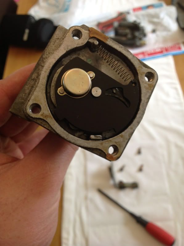

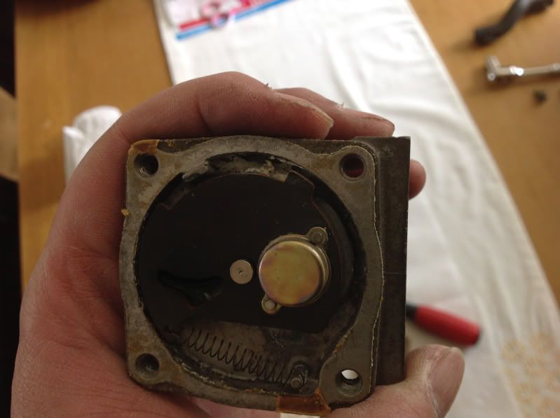

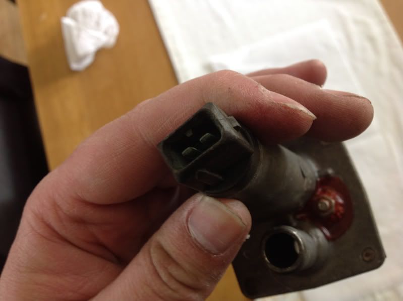

So decided I would try and take the one off the car to look at. Then when trying to get to the bolts I thought... There's nee way ill get this back on the car when I'm done lol. So I decided against it. But did decide to take the air regulator off (I haven't.a clue why I though this bit by itself would be any easier. Anyway, I took the air regulator off and gave it a clean. There was some white gunk inside and it didn't seem as fluent when moving the insides (only comparing it with the one I was messing with last night)

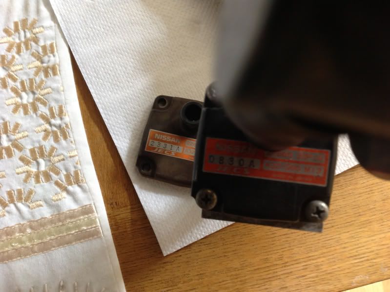

You'll notice in the below pics that the codes are different on the one I took from the at and the ones I used in the previous pictures...
What do ya's think
Dirty
And cleaned a bit

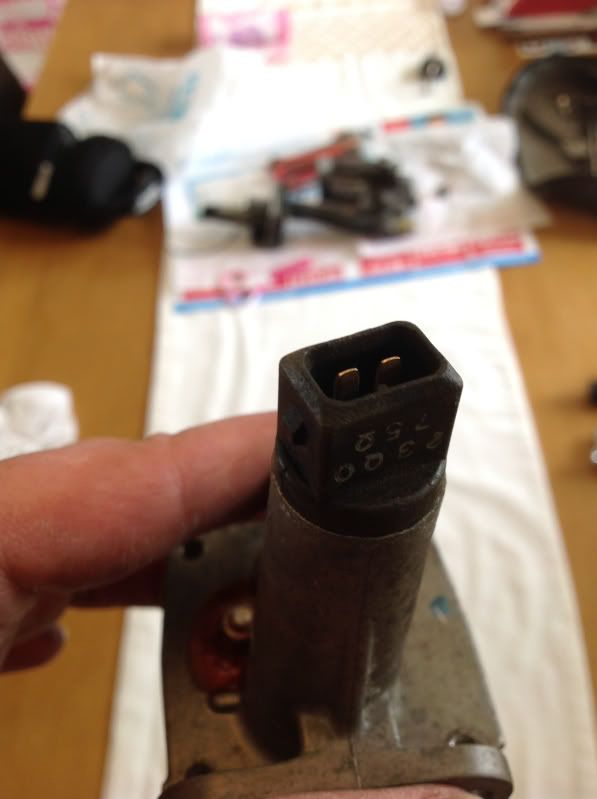

The different item numbers
Edited by bird
Membership No 0780
INSURANCE GOOFA
the black numbers stamped/printed in are the S/n .. the Product codes is the yellow writing
S the product code is the same then, but why would the serial number be different?
Membership No 0780
INSURANCE GOOFA
That just seems like numbering stuff just for the sake of it lol
Rolandas, thanks for the picture, I've obviously just lost the spring.
