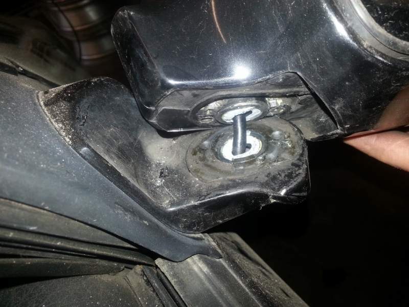

Hello guys.
There is any way to fix this or i need whole "new" folding mirror?
you can fix it so it doesn`t fold :) or you can get a new folding miror any color and use your housing
I'd say it's goosed, the bit that rotates is in the base still 3 bolted in when it should be attached to the mirror part.
You could try superglue on what looks like the white bit for a quick fix but complete mirror assy's are not expensive anyway and are plentiful :thumbup1:
I mended mine with JB WELD and a piece of metal tube through the middle of broken bit, Tight fit and glued either end...... lasted 2 years till some teenage twit snapped it off again.....lol
But then I am very tight......lol
i have pair of black mirrors with all connectors on that i can split if you cant find a new 1 or cant fix that.
