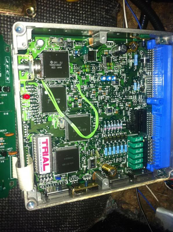

What is in my ECU?
Guys,
Any ideas on what this is and if it is any good?
Thanks.
Ive heard of Trial, its along the same lines as a Mines ecu.
They give a decent increase but they are tuned for japanese fuel which has a higher octane level than us, if i was you i would sell it ( i got 350 quid for my soarer v8 mines ecu, loads of folk love those jap tuned ecu's) and get a turbonoz remap.
That way its for your car, and is tuned for the fuel over here
Thanks for the info mate, selling it and starting over does seem like the best option, I have been searching and seen that turbonoz does them, just need to sort out my blitz dual sbc which will not run anything apart from
standard boost!
