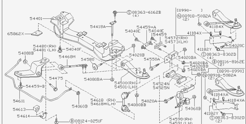

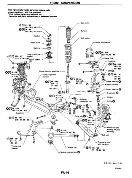

Hi I've just put back together my front susnesion and I've got 2 big washers left over there big about the size of a 50 p .the 2 options left is under trackrod end nut or under nut lower front shock mount both places don't look right can't find a diagram on web with washers on any help please thanks Taff
