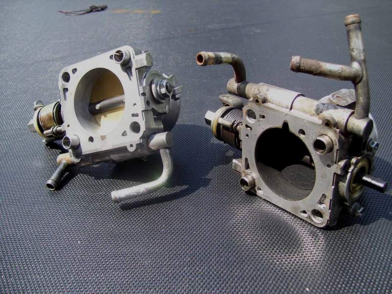

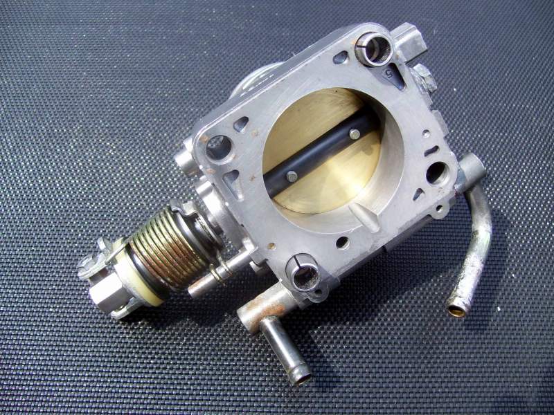

Thought I would spend some time cleaning the Throttle Bodies before the re fit.
I thought they might be a bit dirty but did not envisage just how bad they were.
Took me bl**dy all day to do them both, worth it I guess though.
First picture shows a before and after, second picture shows a close up of the first one finished
