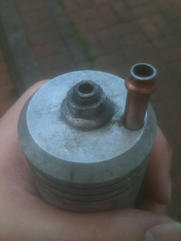

I've been trying to move a bolt that's been stuck for many years as JeffTT said previously to try tightening an Allen key bolt with a nut round it. I just cannot move the dam nut.
Any ideas on the best way to move it?

Thanks Kev. It's doing my nut. It's this bolt

Plus Gas overnight, heat nut (not too hot as it may damage seals in dump valve I have these and IIRC they are aluminum and heat transfers very quickly) Use 5mm allen key and some stilsons if you round it off anymore a nut splitter cos you'll need a new nut anyway, also clean the threads up with a wire brush when its off :)

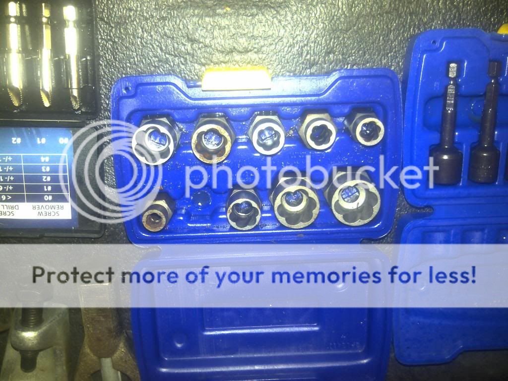

These badgers are perfect for this kind of thing, I swear they are one of the best things I've ever bought. Pop the right size on a ratchet and it grips the nut allowing you to undo it

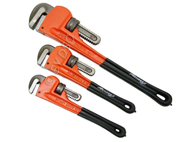

What are stillsons mate?
they are what cowboys wear... lmao... i have some you can borrow, or a trade card you can use...
Yeah they look like the same thing mate.
i got a set of them, great until they also chew the crap out of the rounded bolt / nut you are trying to remove lol
Oh yeah they do make a mess of softer metal nuts and bolt heads. I had a rounded nut on my red zed's upper camber arm mount that was a propper bastid' and whatever I tried the thing wouldn't shift. I bought these and it came off with no trouble at all, but yes I agree they aren't great if you want to re-use whatever it is that you're trying to remove.

Also the other hex things are Brilliant and have pulled me out of the shit a few times, I got some from machine mart years ago but they are in 2 sets 9,11,13,15,17 and the other set is 12.12.14.16.18 Something like that BUT they are £20 each which one do you get?? or both for $$$$

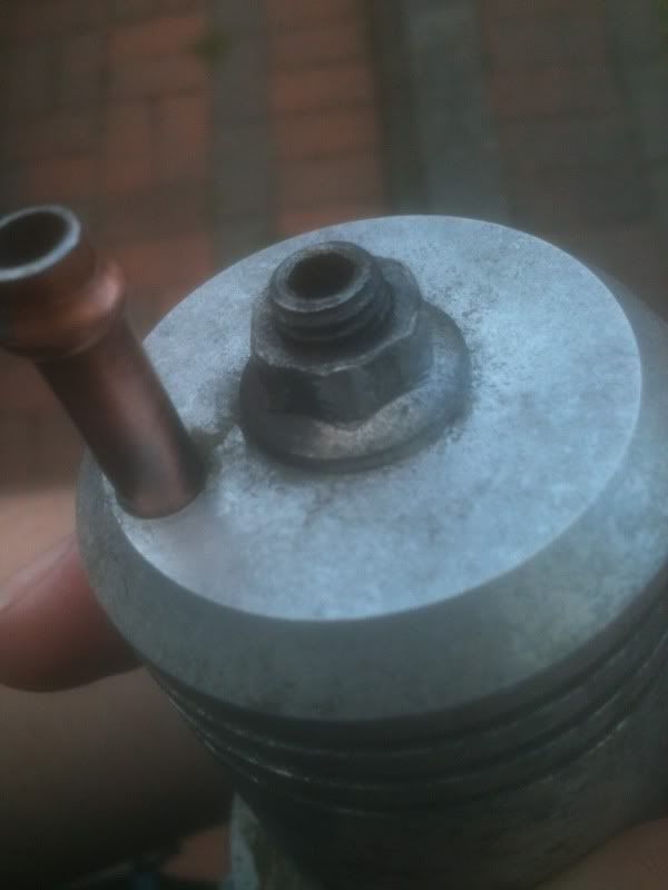

I think one of the problems I'm having is getting a tight enough hold of the bov to be able to really turn the nut

I've just been round PaulZX's and he couldn't budge it either. Tried with the Stimpson or whatever it was called.
Might have to be a nut cracker like
