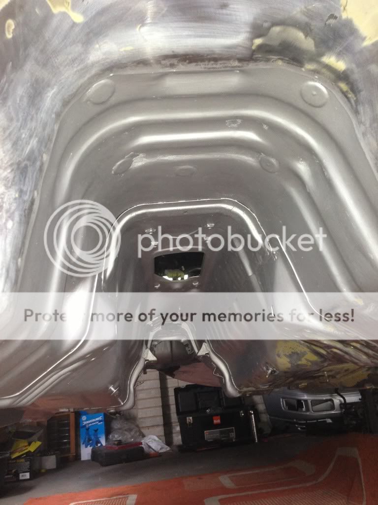

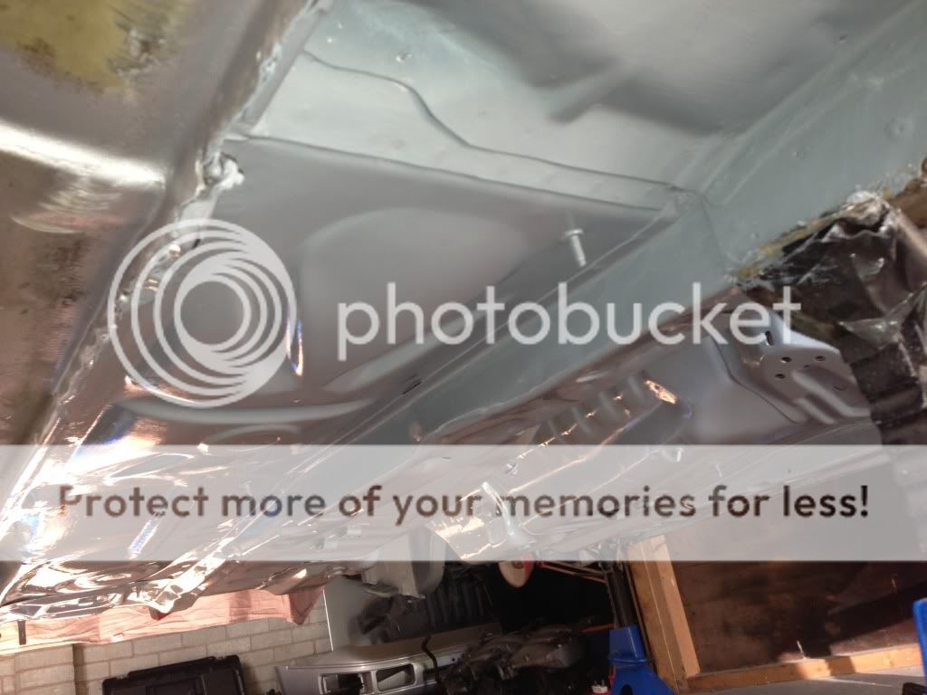

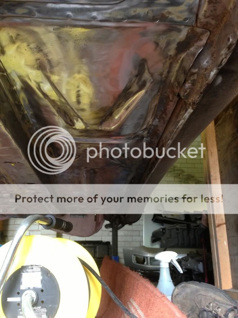

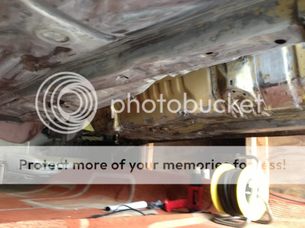

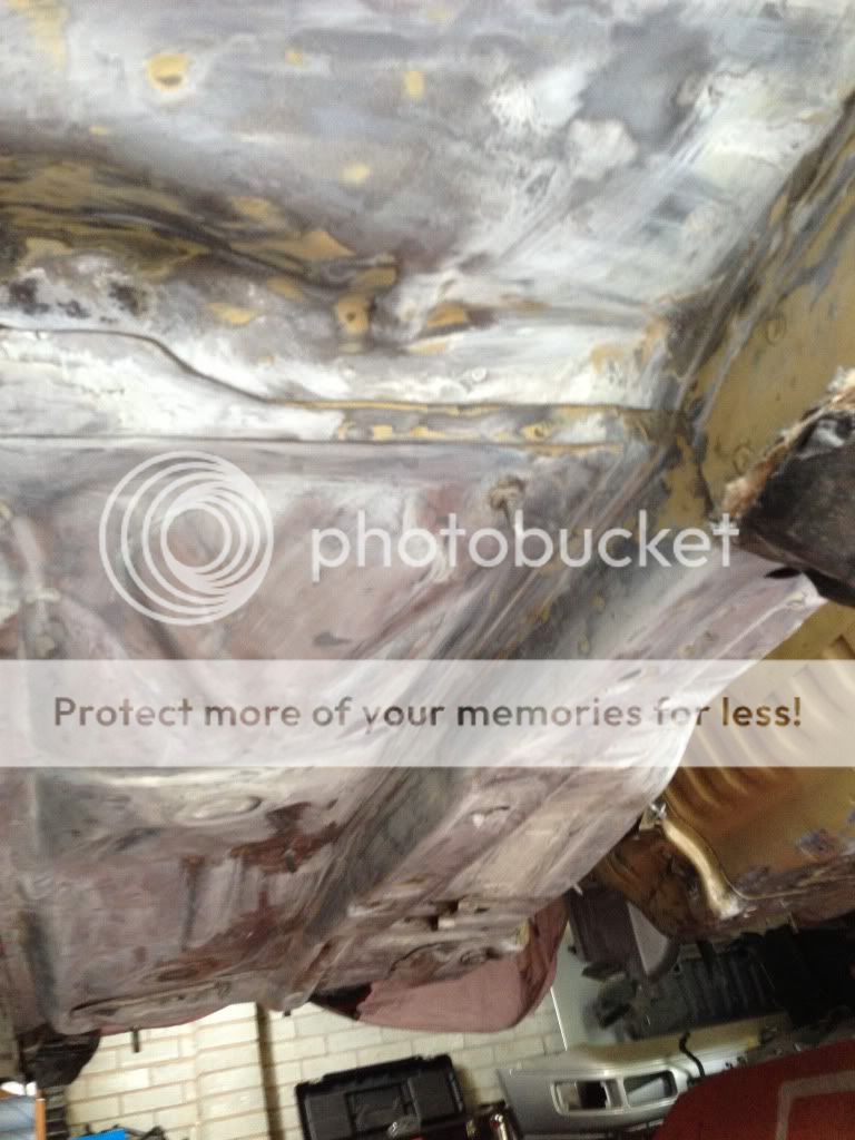

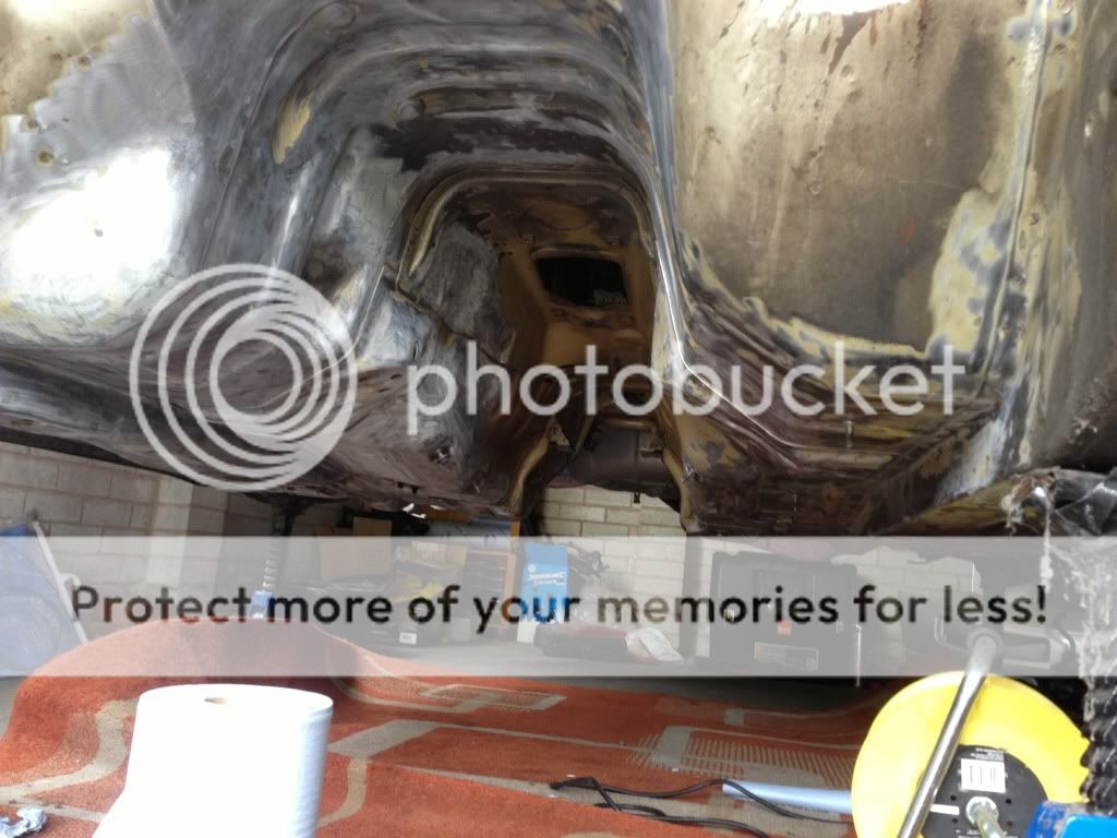

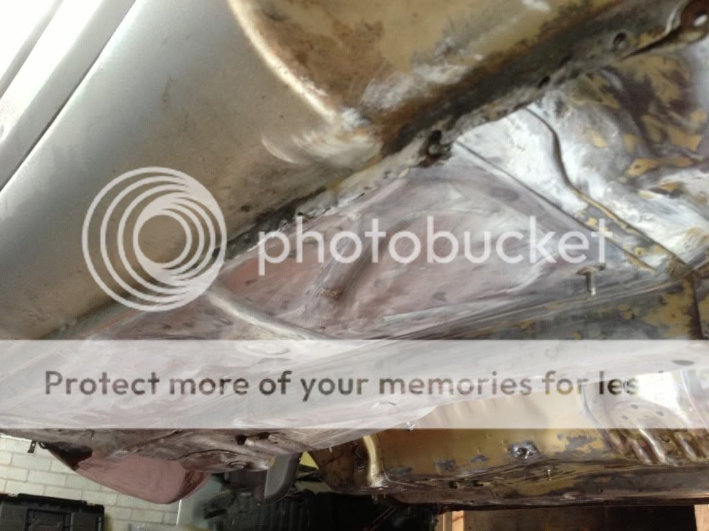

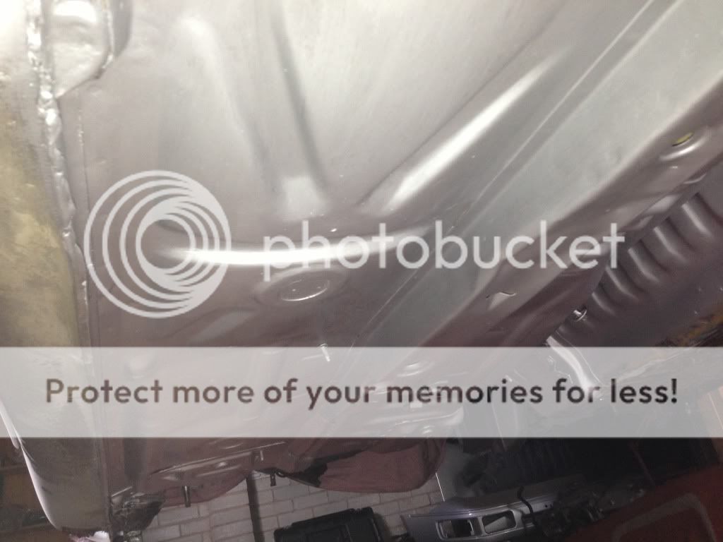

The drivers side sill where most people use a scissor jack on the seam was absolutely mullered, it was practically horizontal in both directions. it wasn't a pretty sight. i don't have a before pic but you can see from this one i bent it back into what it should look like. Also you can of course see my progress with grinding the underside and it gets more and more annoying as it just seams there is much thicker sealant even where there isn't a seam!

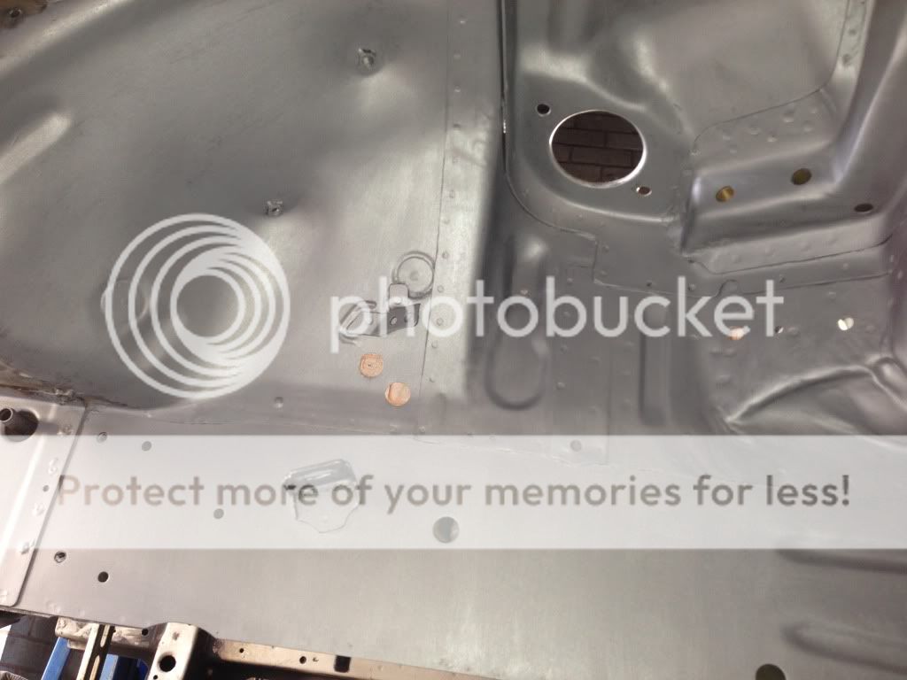

This pic is just the metal after being acid etched with some metal blast
Its the final prep i do before applying the lurvley rust bullet but i also soak it in as it helps to remove lots of crap

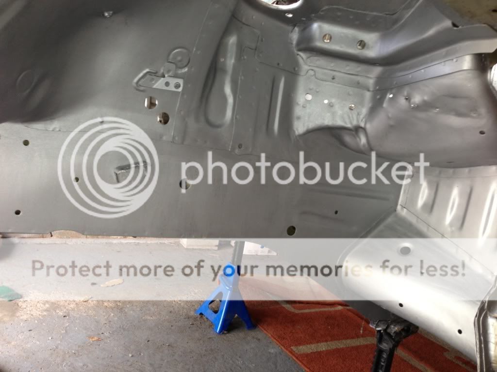

Now for some more painting!

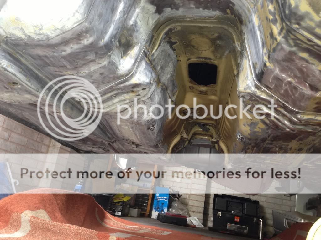

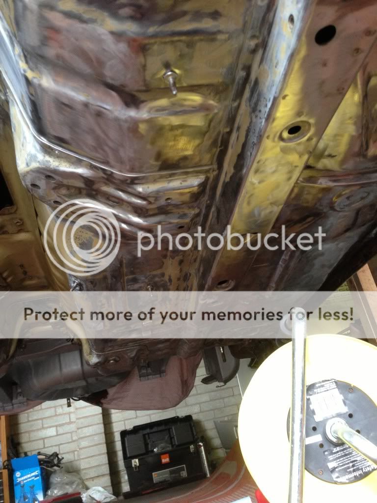

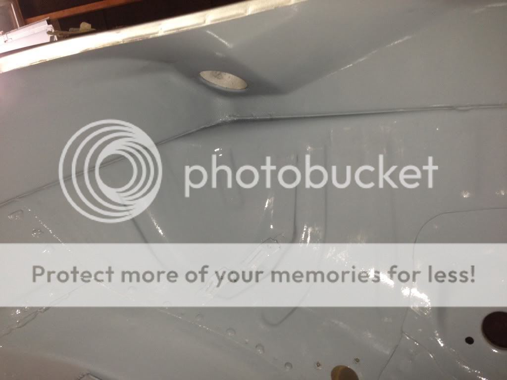

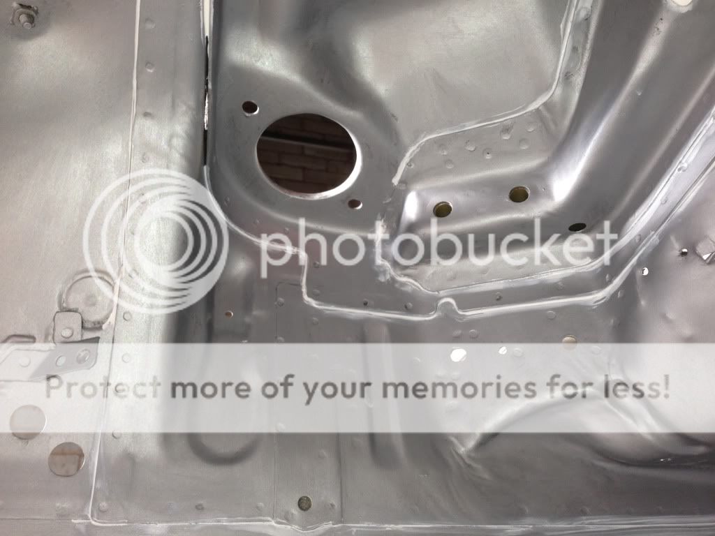

This is the Drivers side floor pan
..Transmission Tunnel. I didnt go any further into the engine bay as i plan to treat it with zinc then spray it the colour of your car of course.

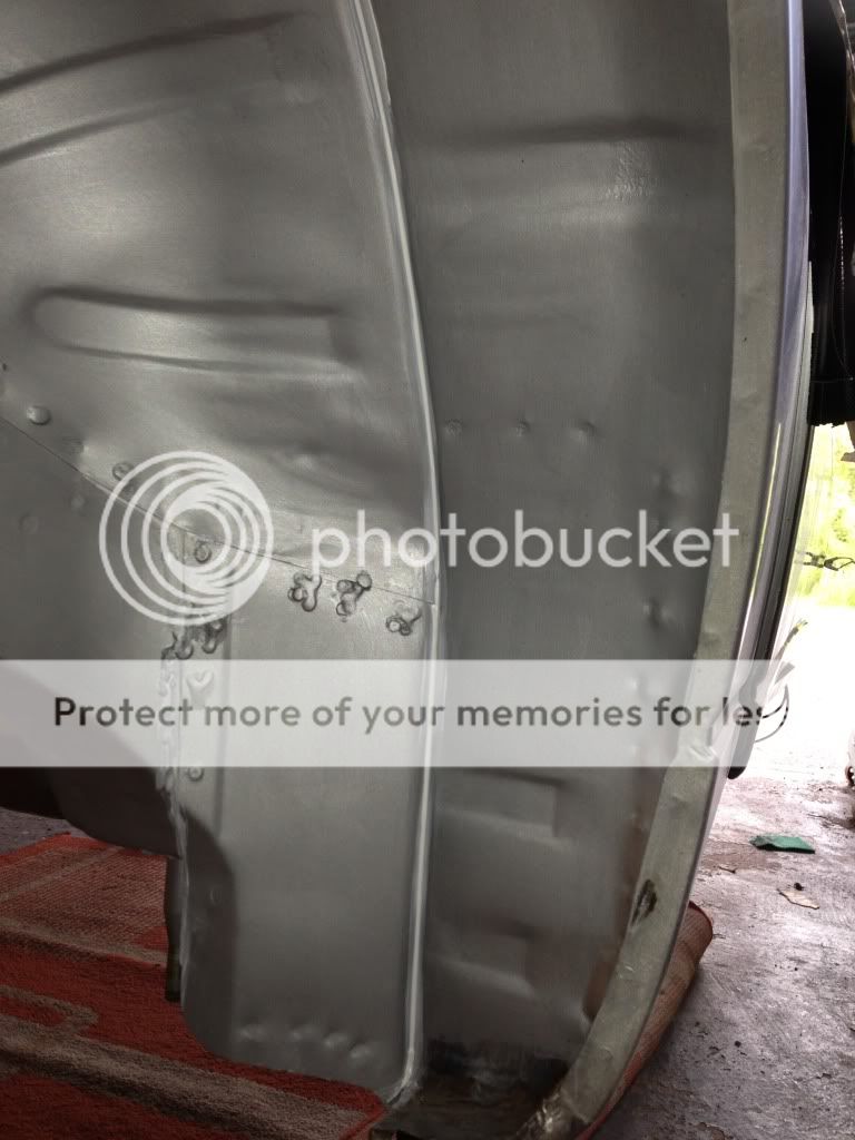

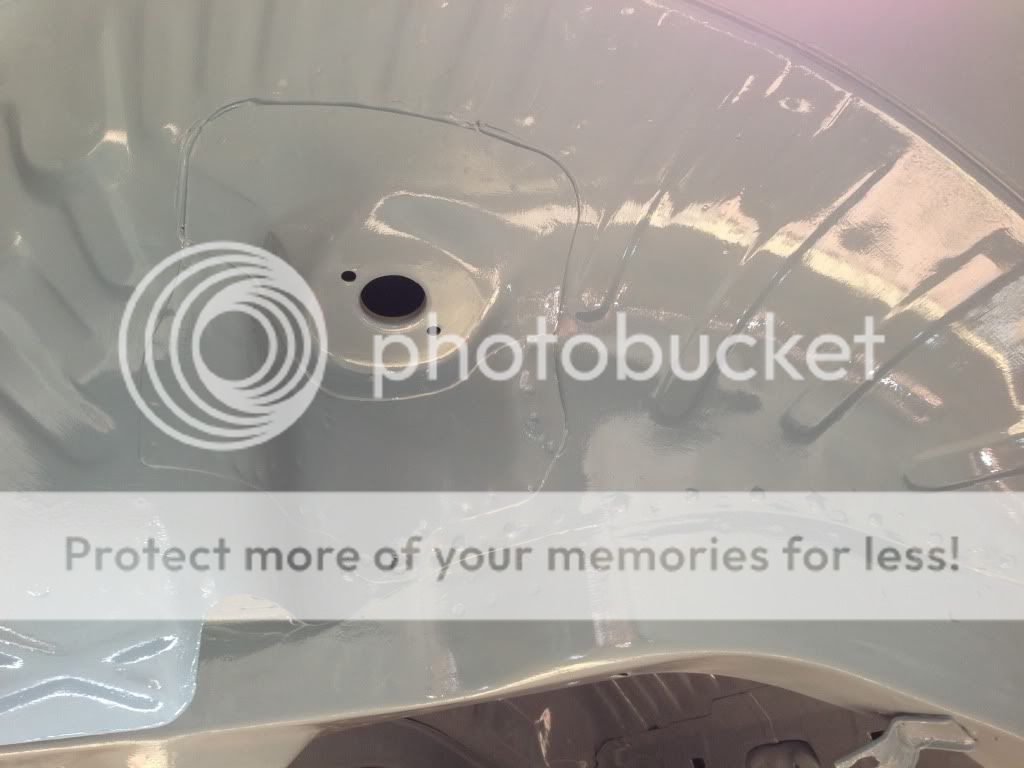

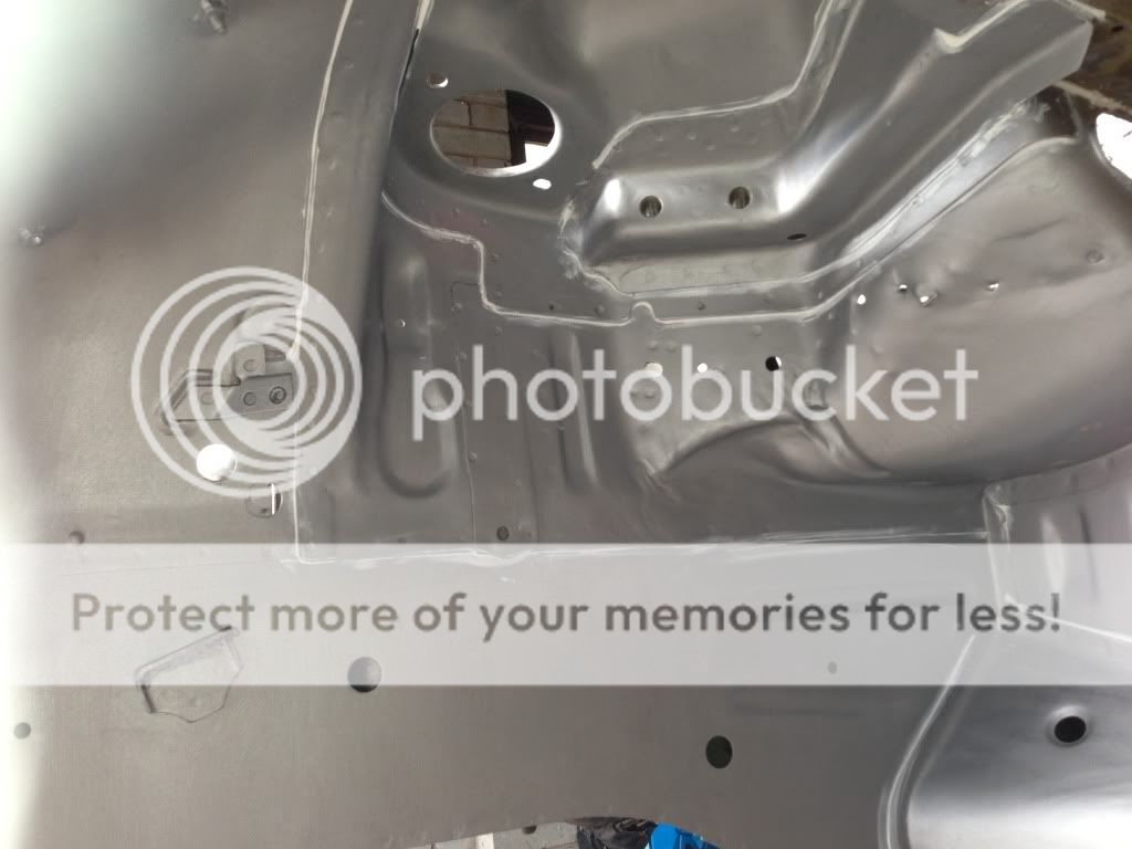

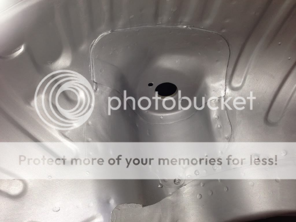

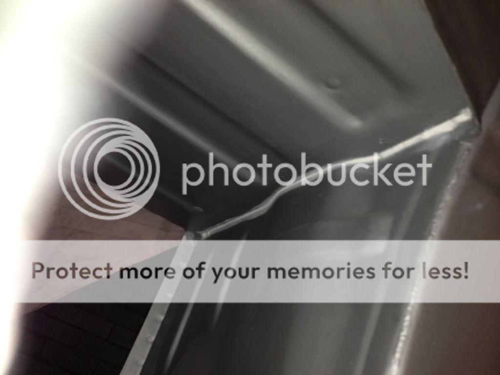

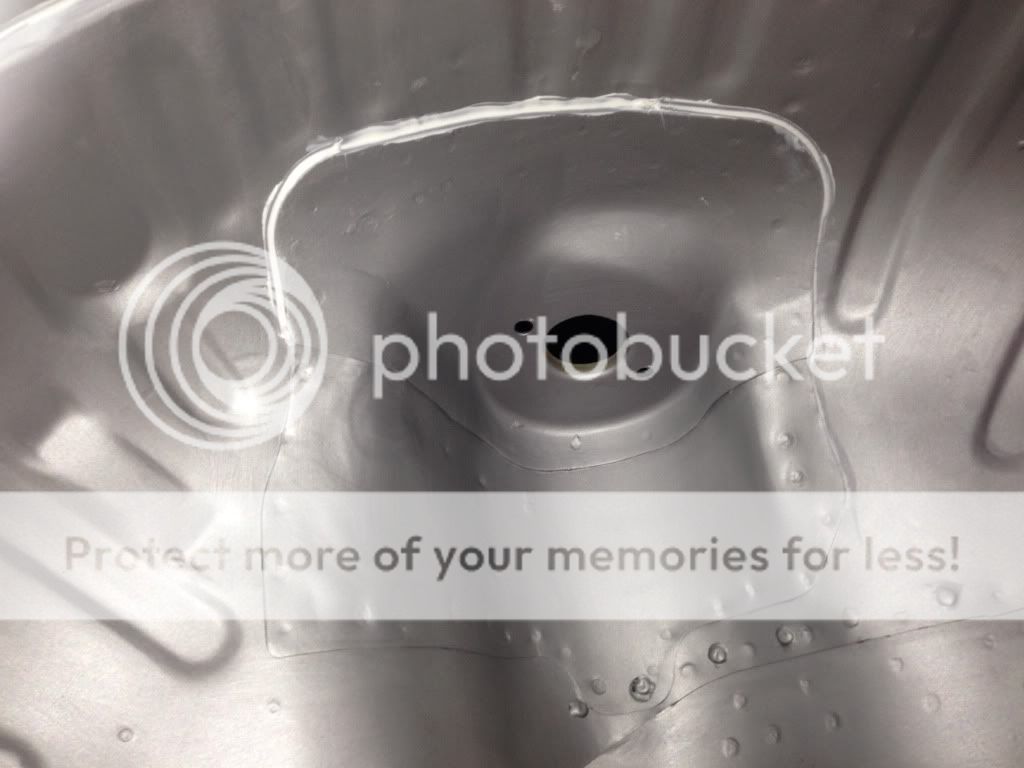

whilst cleaning the metal up i removed all the seam sealant so here is a pic or 2 of the new seam sealant. Looks a bit messy maybe but i cleaned it up after, then forgot to take a photo :/
Because the top coat im putting over the rust bullet wont sit very well on top of the sealant i have to reapply rust bullet over this to give it a good surface to bind too. Plus doing it this was not only makes sure rust bullet is on the sealant stopping it from rotting, but its also behind the sealant should it fail to do its job, because even though ive been pulling massive amounts out it defiantly proves more isn't better as there has been some rusty stuff sitting behind it in most cases.

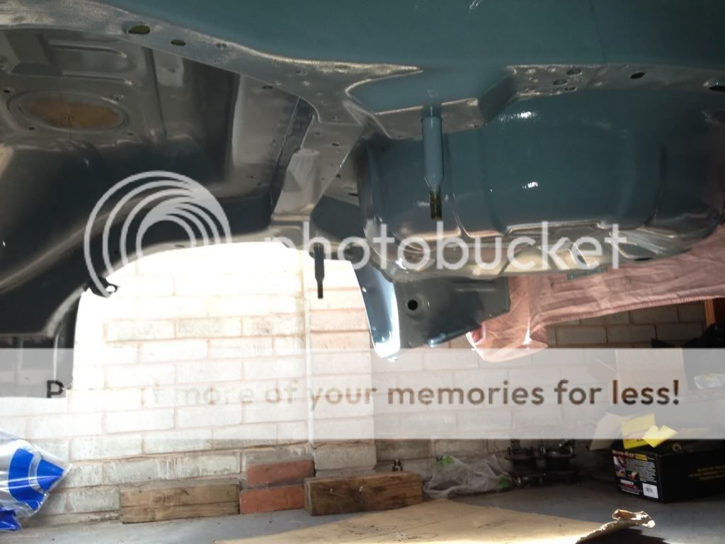

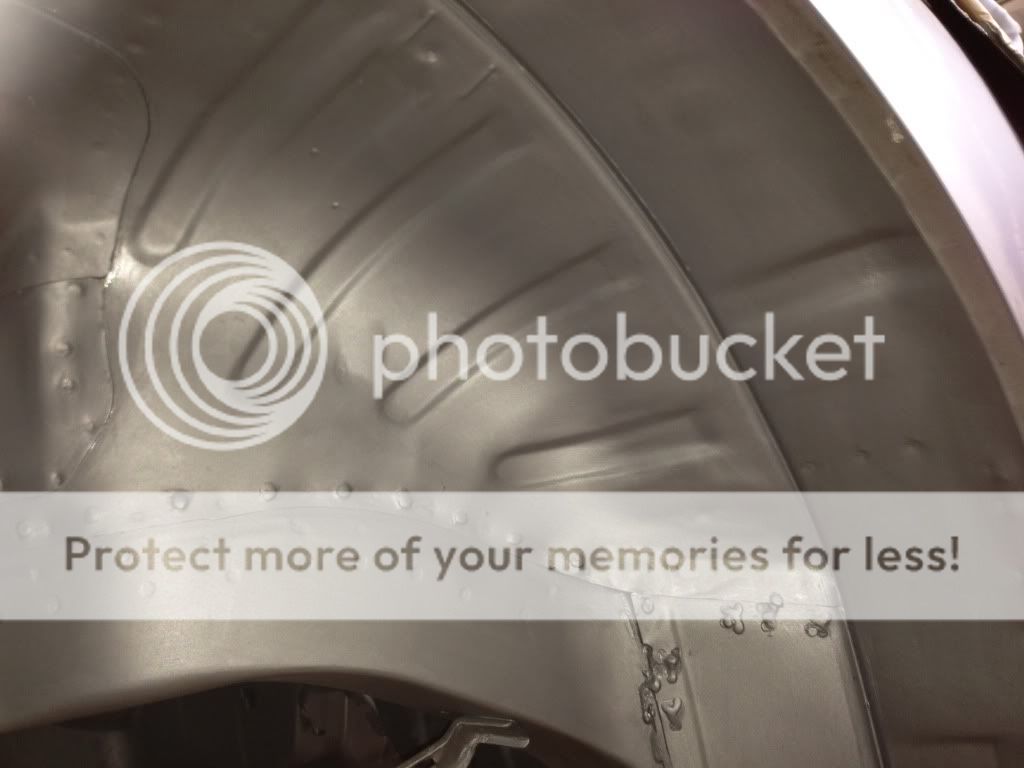

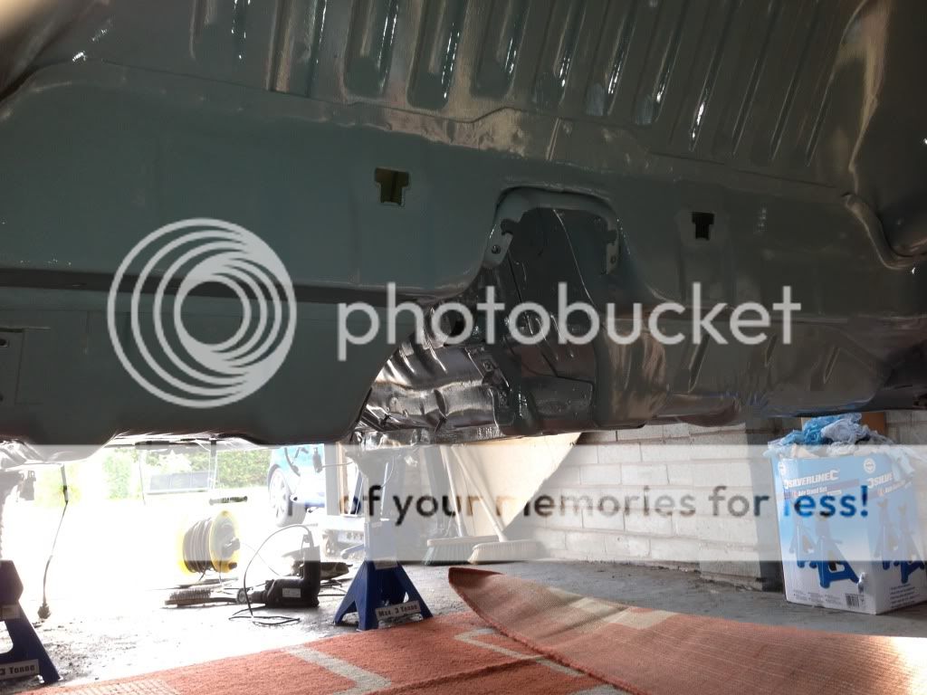

Front passenger Arch here. among other random snaps.
Again this is the front passenger arch being seam sealed, a few more seams to fill this time..

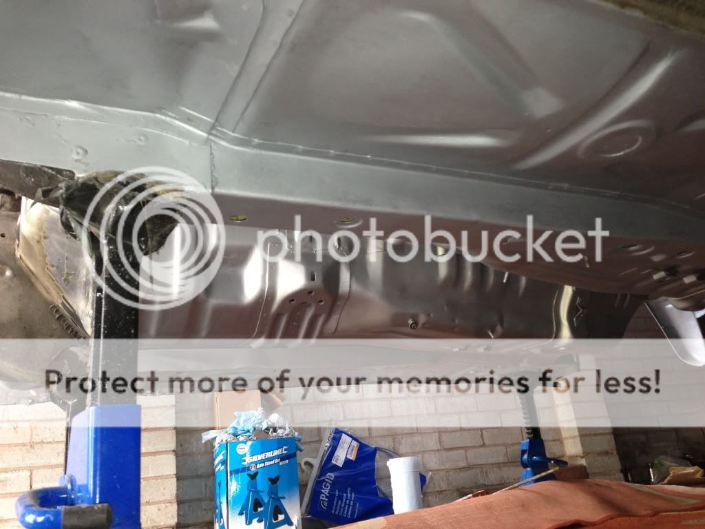

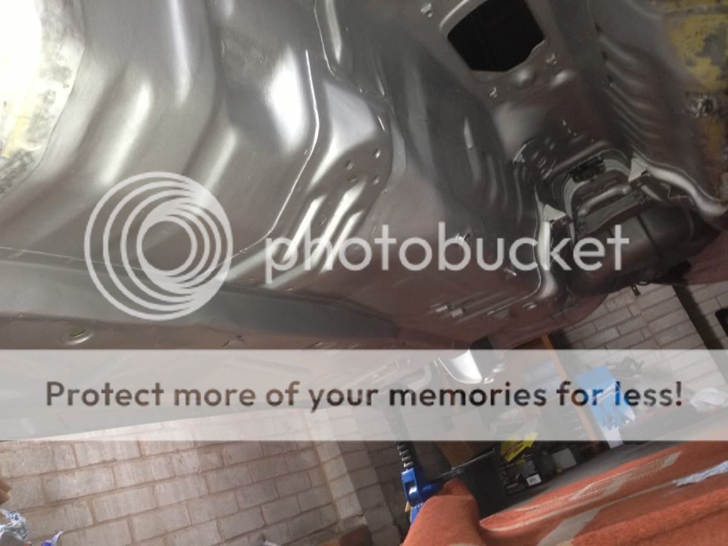

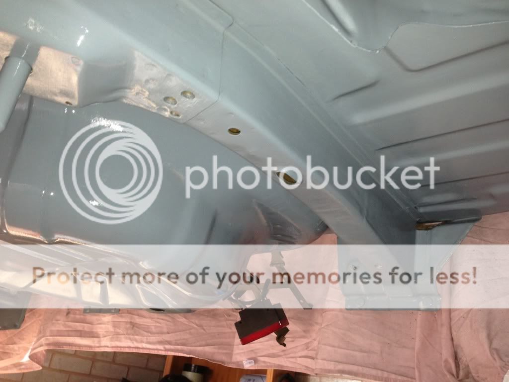

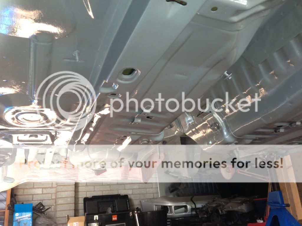

Now for the top coat which ive been dieing to apply!
Enjoy..

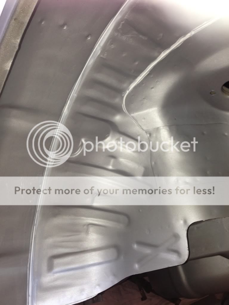

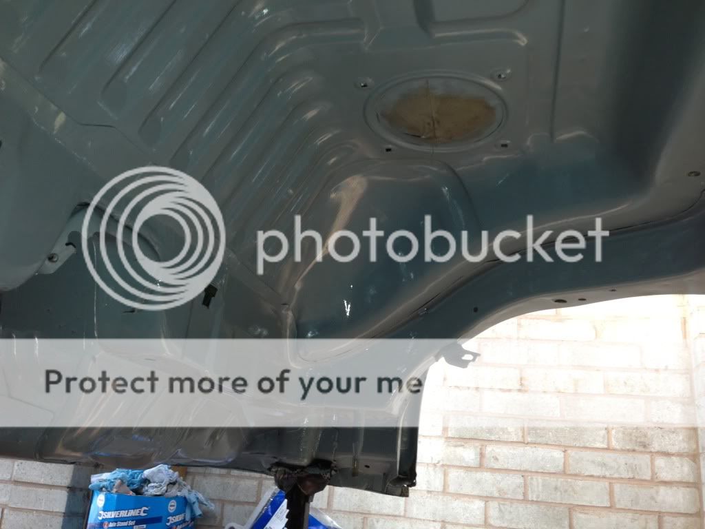

Passenger Rear Arch
Fuel tank area
Drivers rear arch

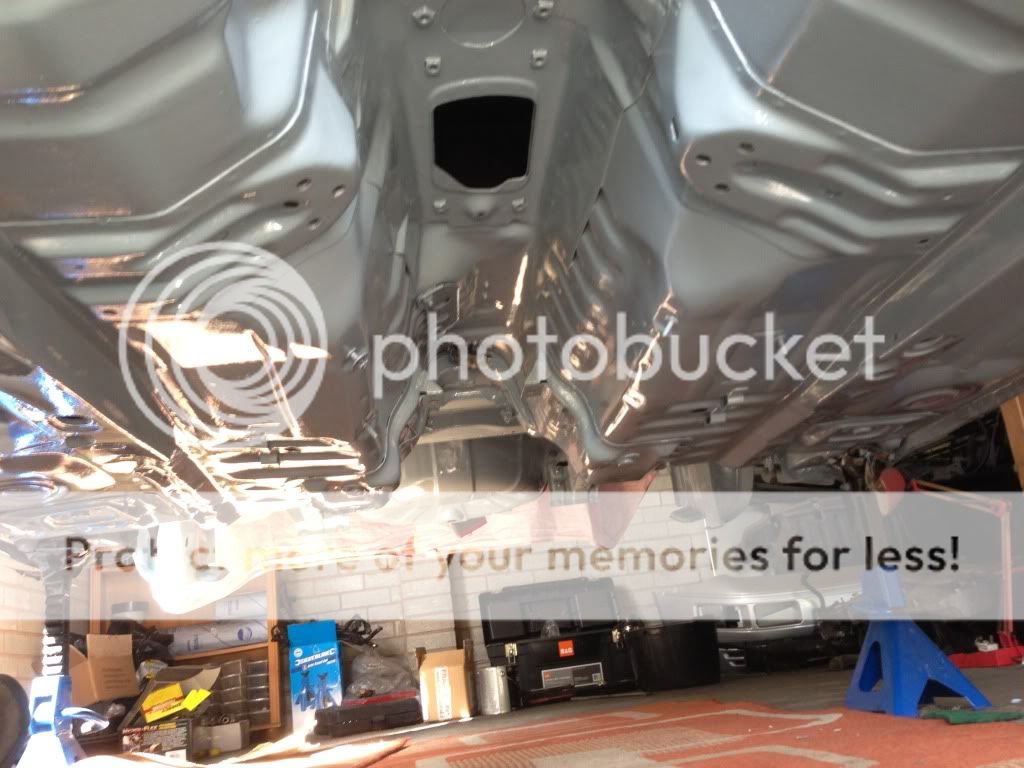

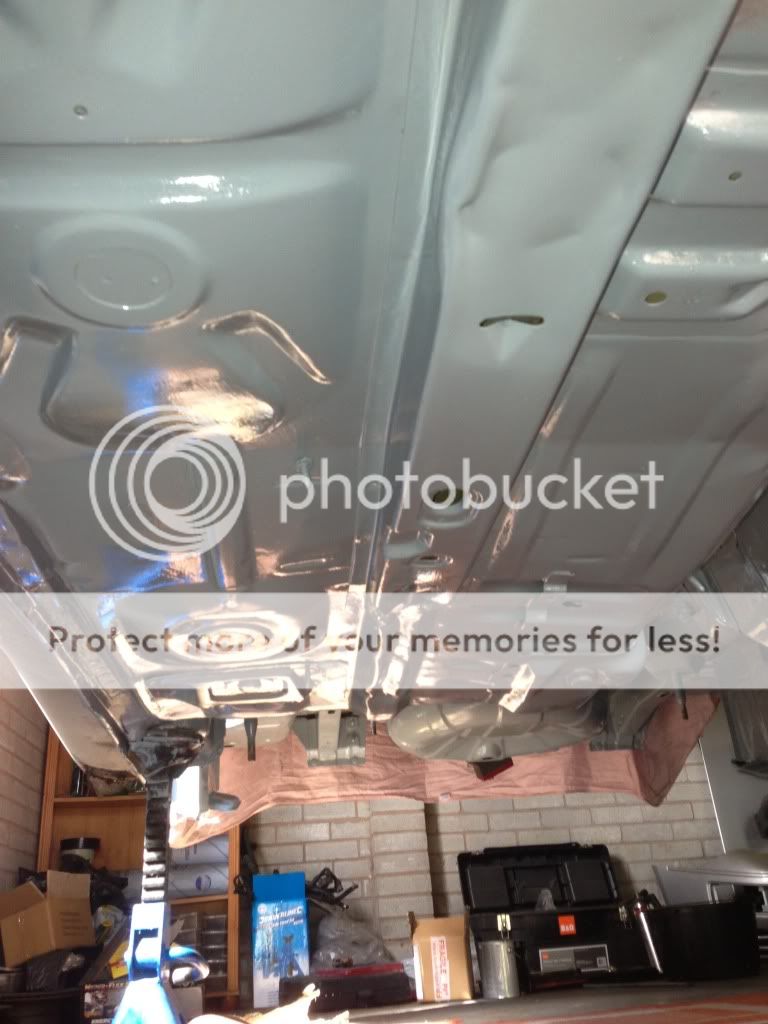

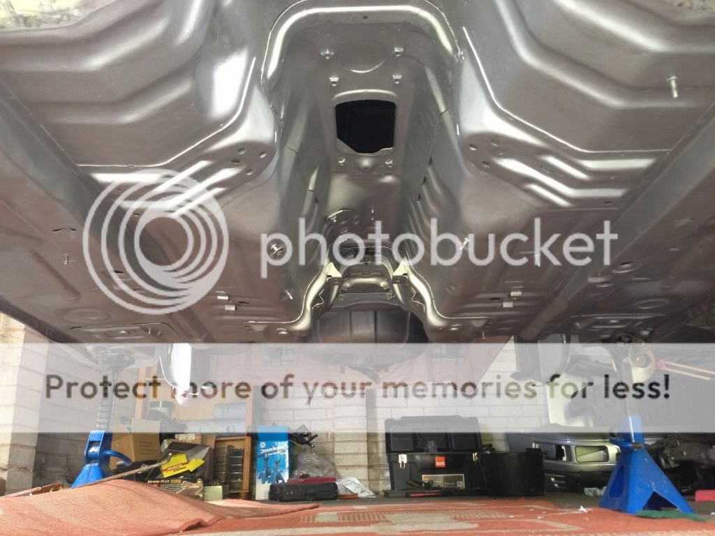

Drivers Floor pan
Transmission tunnel
Hope you enjoy,

Lol In the last pic you can see the marks from a trolley jack on the chassis rail... Couldn't do much about them.
