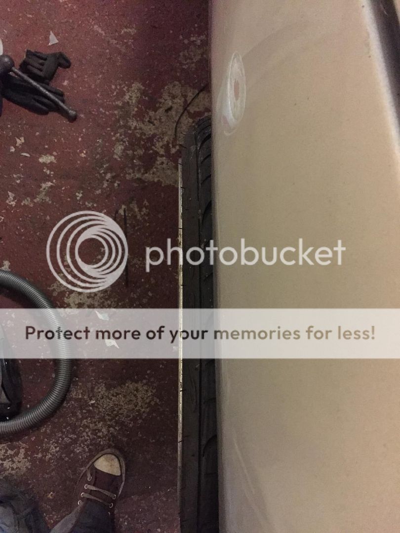

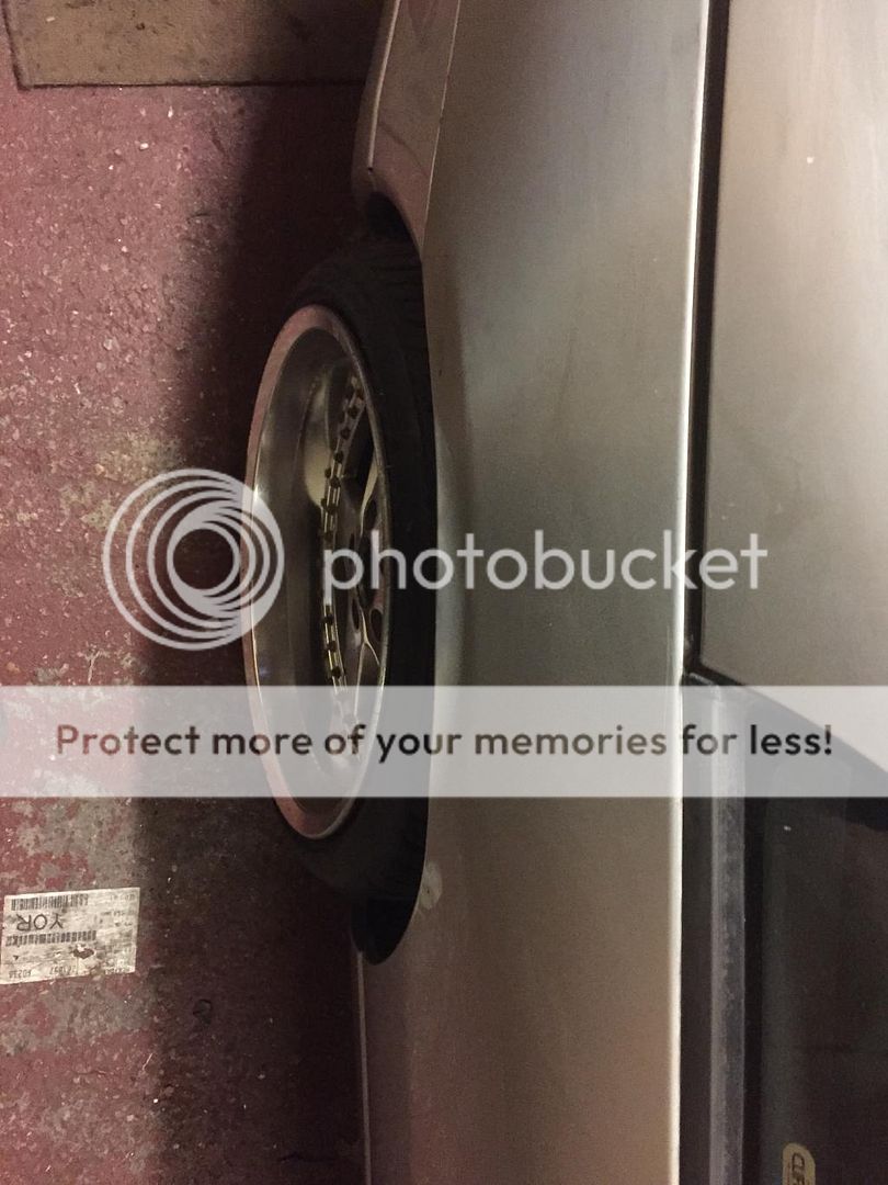

luckily it was only just too big and never damaged the rear of the gearbox. Well after consulting with Jeff and lynda once again and the pair of them being ever helpful once again i fitted it all back together but in the meantime I received my arch rolling tool.

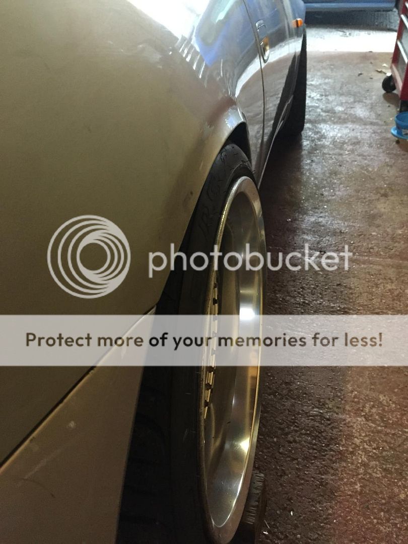

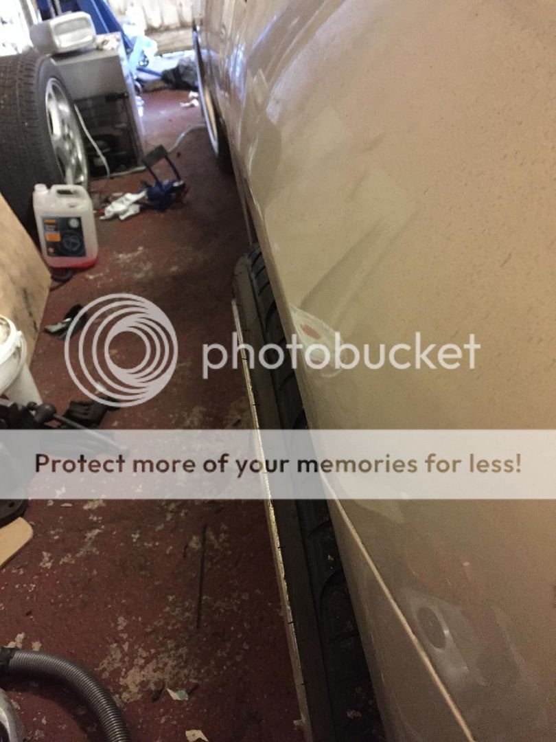

Before
After

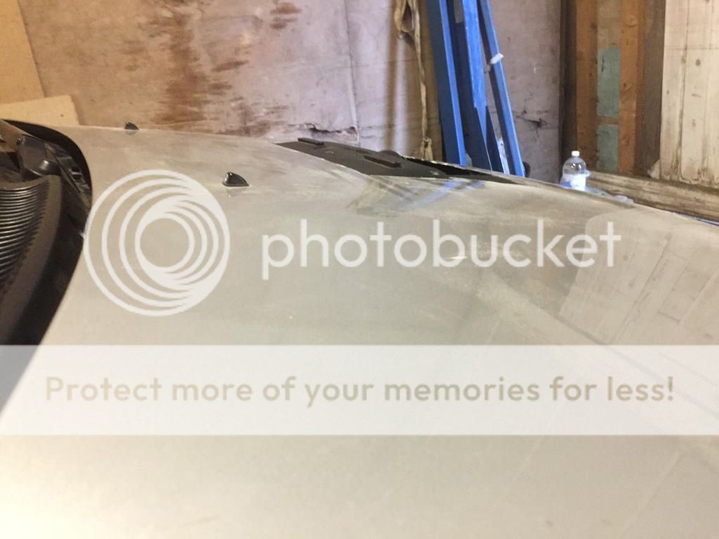

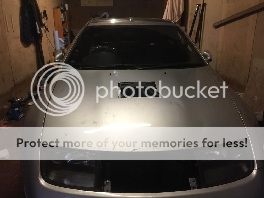

Heres a pic of the revised bonnet as the engine sits high

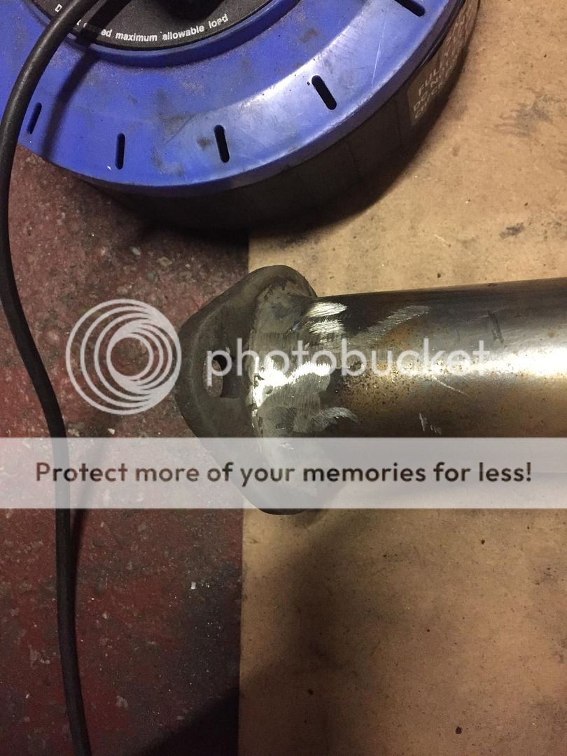

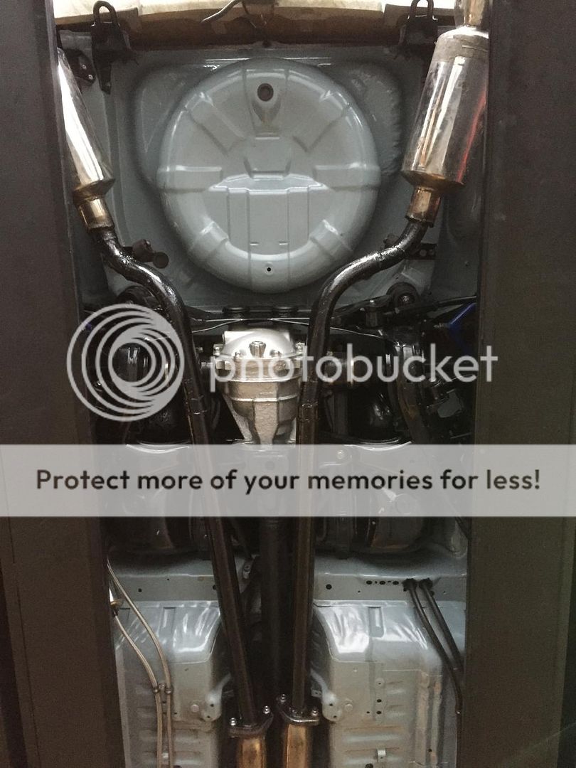

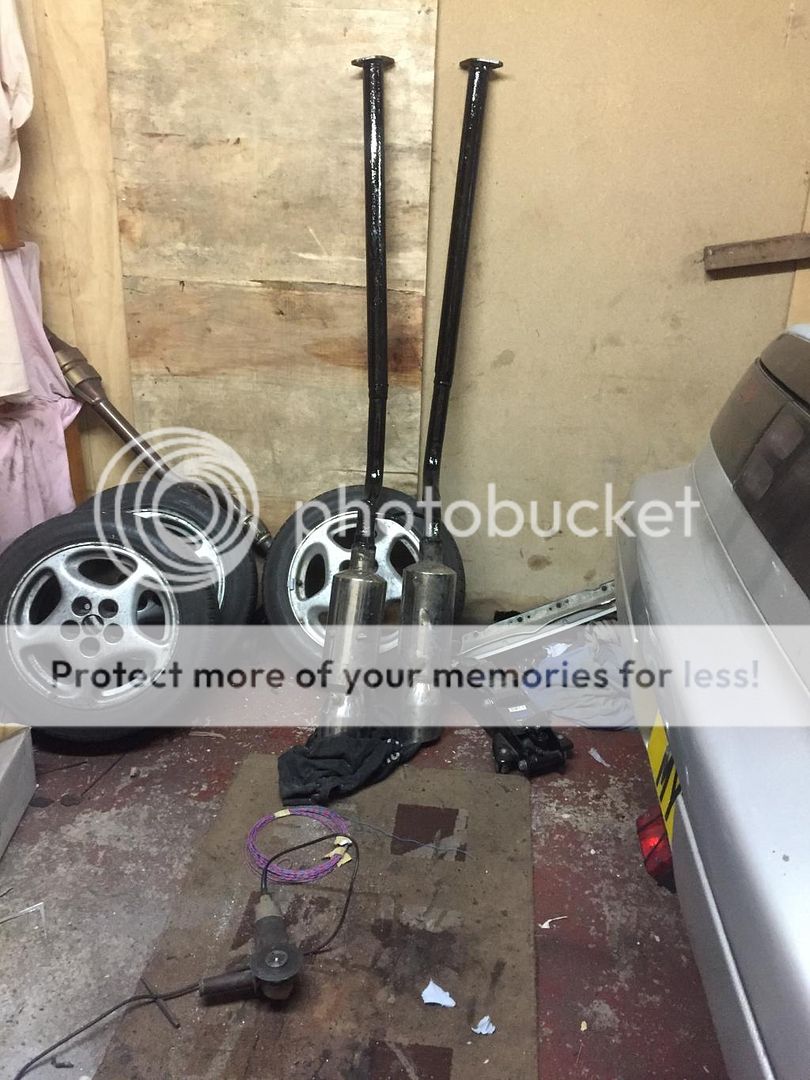

Heres my temporary exhaust i made from scraps of tubes and back boxes donated from Lee Dent :wub:
As the majority of it is mild steel i gave it some paint to stop it looking hideous so quickly.

Looking good mate.
Just thinking on your bonnet. What's the plan? FFS don't go sticking a hidious vent on it.
When Nissan changed from the VQ35DE to the VQ35HR engine in the 350z they had to change the bonnet profile and give it a "hump" to allow for the higher engine.
Maybe you could do something similar and graft a hump into a standard bonnet? (I'm on my phone so can't post links. But the bonnet style changed in 2008).
I completely understand what your saying, and im hoping to get another front subframe to chop up and lower the engine around just under an Inch to avoid any humps at all because i think they look Sh!te! However i cant do much about that at the moment so engine poking out of he bonnet it is for now. As you can see the bonnet i have chopped up is slightly dented here and there so no matter. I already have a fresh bonnet to put on as soon as i have lowered the engine.
Edited by Hollings

The arches will need a bit of work but suits the car not having flares on them :thumbup:
Alan, I don't know why your telling me they need work, your the one who's going to be sorting them ;) (i hope)

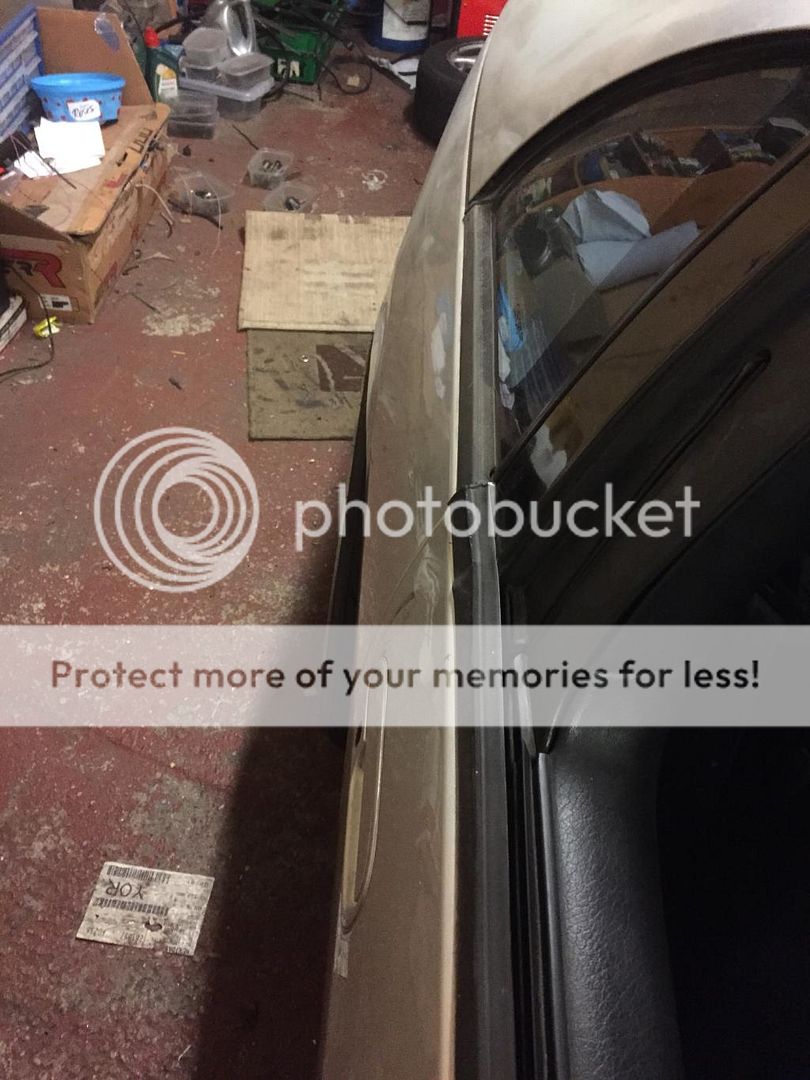

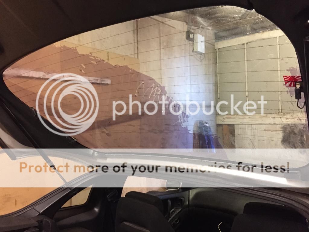

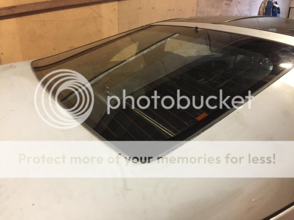

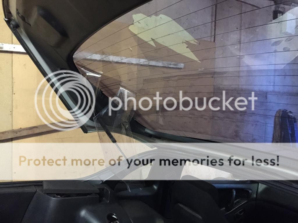

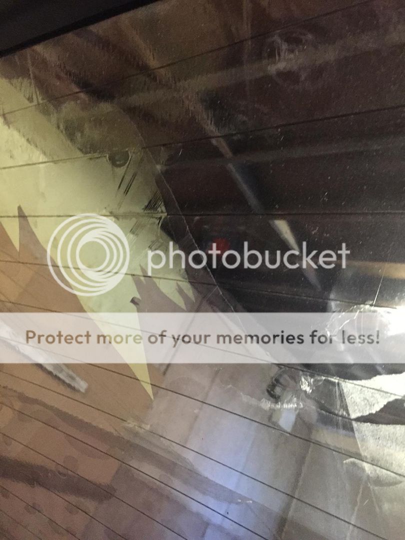

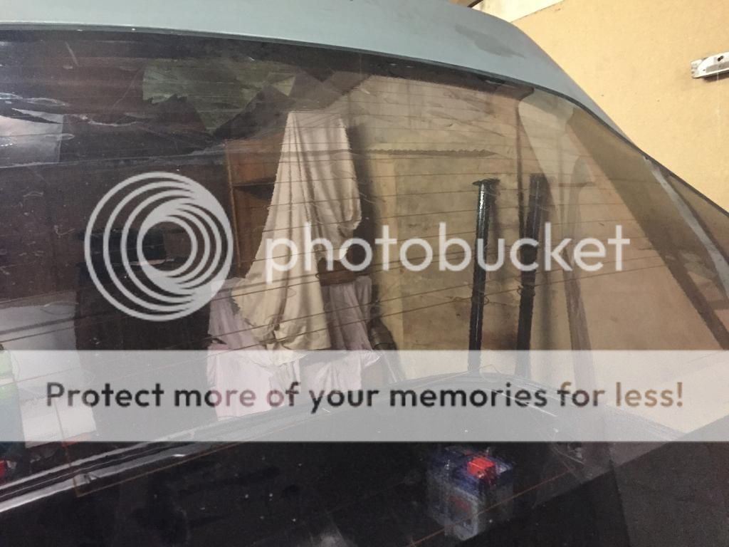

Had a tint on my rear screen and had bubbles in it so i started to get rid....then i found out there was 3 tints one on top of the other and i was peeling it off in strips!
And Finally.

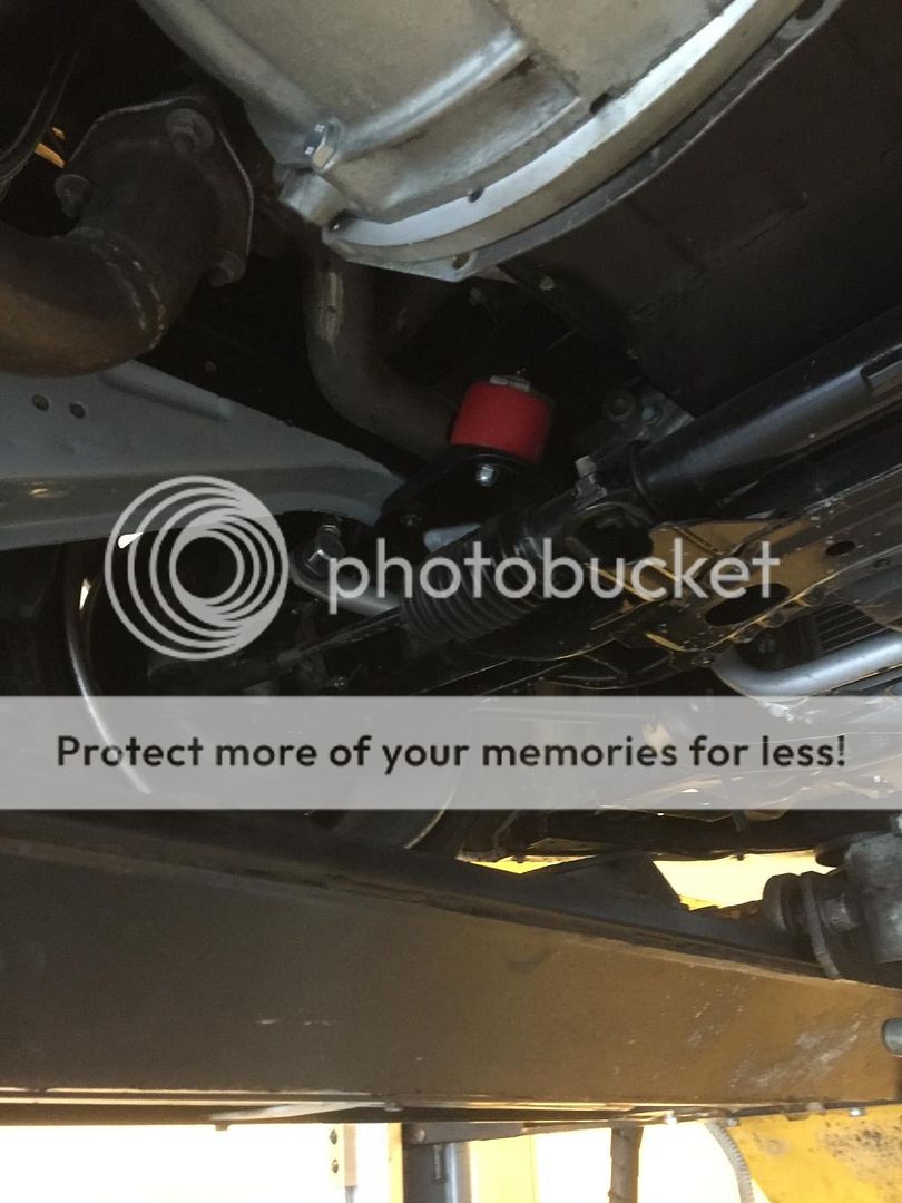

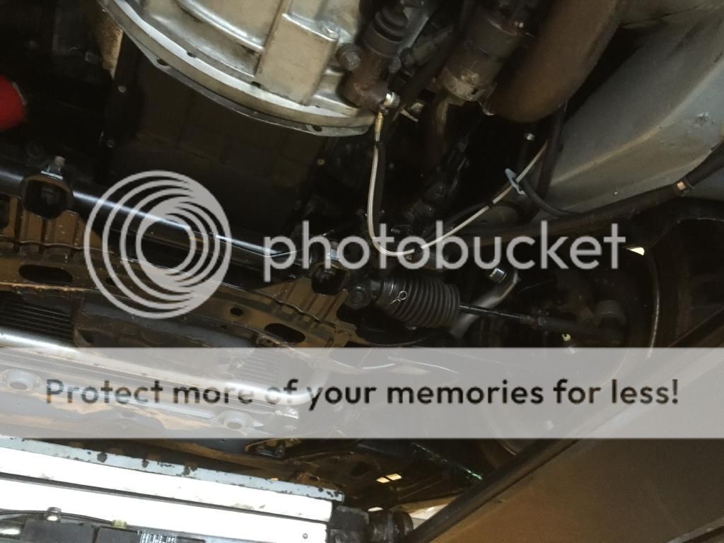

Also managed to get a few picks of the underside of my car whilst it was being MOt'd
After evaluating the tolerances of loweing the engine it looks like its either custom inlet manifold and another custom sump....or a bonnet bulge.
...yay.

That exhaust i made (whilst its temporary i did it on my back on axle stands) is super loud.

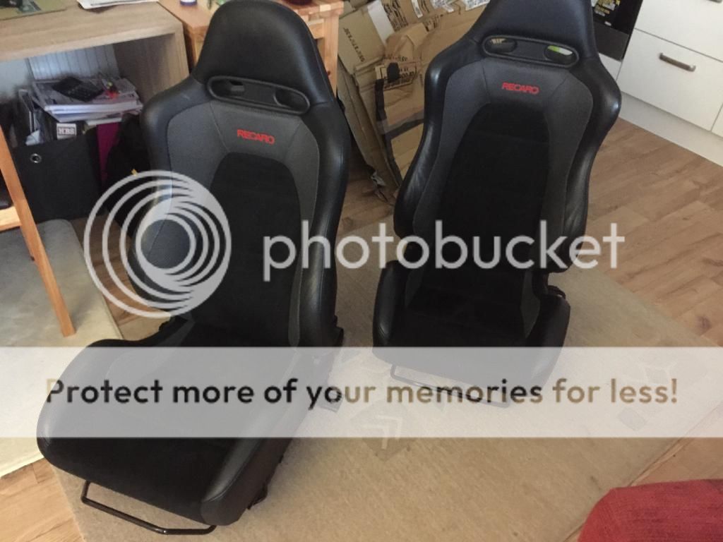

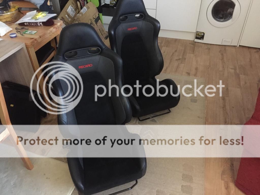

Just arrived are my new seats for the shortie. They feel so good compared to the normal zed seats.
Mondo will at some point be trimming my interior to match these and i cant wait as his work is EPIC.
Man's seats, those! :thumbup1:
They look in good condition too. Which is good, cos they're awful to strip down and work on!! :surrender: :lol:
you bet, gave them a test drive with some artificial sounds and expressions....they seem a good buy!
Wow nice seats bro. What they from? Or new..?
They are from an Evo 9 MR and they feel so good!
Might let you come down and have a sit in them if you bring those stereo brackets ;)

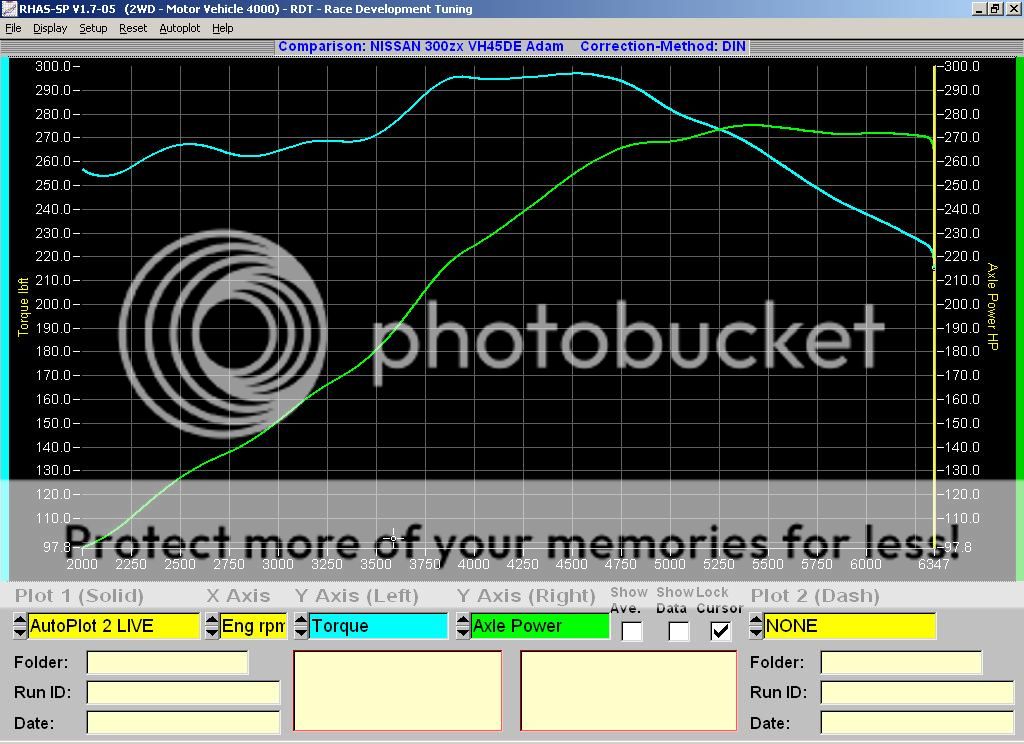

Well After trying to align my schedules with noel and failing due to both our commiments and im soon to be leaving the country for some time i took a chance and went with a different tuner.
Will Hinchcliffe of Race Dyno Tuning at Harworth Doncaster.
First things first we did a compression test (which i was yet to have done) and revealed the following:
1-190 2-190
3-180 4-190
5-180 6-190
7-185 8-190
From there we found a fuel leak which was swiftly fixed with a helpful spectatre at the unit which ran me across to the neared hydraulics shop! (owe him a beer)
The first run revealed 160 hp which was laughable.
After some time of tuning and so on and enabling VTC The following pics shows the results.
It Achieved 296lbft torque and 275 Rwhp
And here is a video i managed to get between a few pulls (not the final tune)
Will doesnt at the moment tune stock ecu's with the nistune software. But if you need another tuner because you cant get to noel he is a great guy, and such a geek!
