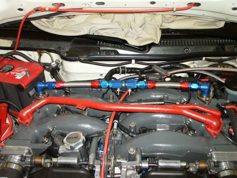

But you've had the ports filled on the new plenum as well though?
I quite like this:
kinda .. i have no balance bar at top .. but i have a vac feed for the Idle unit at the rear that i need to Tap in to the under balance balance pipe ..
