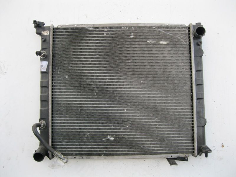

Hi guys,
Ok, I've got an aftermarket radiator that I want to swap with the current standard one. I was just wondering if it will be a straight swap. I am aware that the top mounts won't fit, but am unsure if there are any problems with anything else. Any help will be appreciated, cheers.
I tried a search and read somethimg about issues with the transmission cooler. But I presume that is oil cooled and therefore on a seperate system.
Yeah, sorry jap auto tt. I have a small radiator in front of the main one, Is this the one youre talking about?
Right, just looked. You are correct I have these two pipes. So.... err... What do I do now?? :(
Not good, Ok I.ll just say now thank you for yor help and push my luck on another question ;) and that is where would I mount the oil cooler?? I guess the small radiator already there is for the air-con.
That's probably the engine oil cooler(small radiator), towards front of car infront of main radiator
