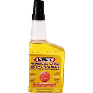

Hi matey,
Sounds a little like a sticky lifter. Try some of this and see if it goes, easy and cheap fix.
Alz.

Hi Alan,
I did try this for a 100 miles or more last year, and although it did quieten the lifter a bit, it did not go completely.
It is difficult to hear on the video, but there is still the sound of the lifter.
But under certain rev conditions there is definitely a distinct separate rattle, I am worried that it may be something more sinister though.
ps Sorry Alan, meant to say thanks for the input mate.

Maybe the dodgy lifter is defective and requires replacing..... This is quite common.
