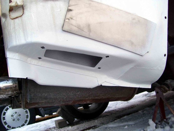

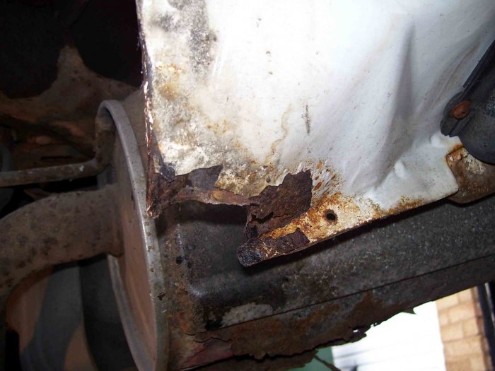

This is what is behind the bumper, got some more pictures if you need them. Got them from a member repairing his car.
Edited by 300_zedx
Not sure what year it was, he did a diary of the welding work he did on the car.

mine are solid i think, maybe i`ve forgotten about the vent there. I know the inner skin is solid uk 91

Just looked at your resto ..my god ,was that parked in the northsea! That should be made a sticky just for rust reference alone. Top work , fantastic job!
Indeed, some impressive work there matey. Could you shed some light as to whether the area has drain holes from manufacture?
I can't say for sure, as both leading corners of the rear arches were missing due to corrosion. My understanding is that these areas were closed seams with no drain gaps. I would have a good look at the inside of the rear arches, (from inside the boot) especially the passenger side near the fuel filler neck. Mine had rusted through and was spraying water etc' into the well itself.
That's where I'm looking. It's the reason I started the thread as I got access to that area to rust proof. It had some dirt in the bottom corner and down the seam on the inside so I thought I would ask if its supposed to be a drain path. I think it should be a sealed seam too but thought I'd double check. I can only assume the dirt is coming down from the fuel filler seal and has built up over the years.

Not wishing to discourage you, but this was the main cause of my rear arch troubles.
