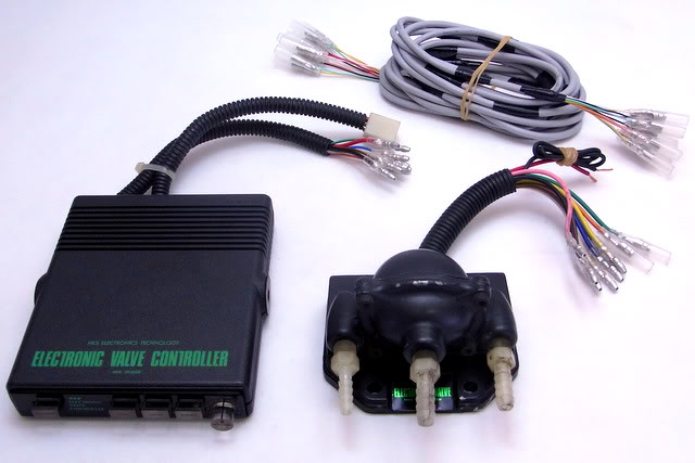

This picture shows the +ve and ground leads coming from the valve body loom:
http://3.bp.blogspot.com/-Qj9aCPp-ta4/UK4wdPlJjlI/AAAAAAAADQ4/qNuBq3WDcqs/s640/HKSEVC1+4.jpg
and the Japanese installation sheet shows the same:
http://i174.photobucket.com/albums/w81/jdmprov/evc1-1.jpg
-Andrew
Hi , it was working fine until the battery went flat, before then the Unit under bonnet with the 3 outlets/inlets did make a humming/clicking noise for a short period while the engine was switched off after a run, I've tried a multimeter at both ends, the feed going to the unit and the feed going to the unit under the bonnet. No power. Checked all fuses all ok. Where is the solinoid located?
The "Unit under bonnet with the 3 outlets/inlets" is the valve body. What do you mean by "solinoid"? From the valve body
have you traced and checked for continuity the red (+ve) and black (gnd) wires back to where they have been spliced into
the cars ignition +ve loom and ground point? Do you have 12v on the red wire with the ignition on?
